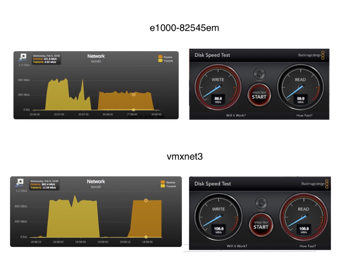

February 9, 20179 yr For a while I've been looking for a way to increase os x networking performance over the mediocre e1000-82545em we all use. I've even run my network connection over a ub3 card and ethernet adapter. And since the virtio-net virtual adapter delivers the same lackluster performance as the e1000, I went hunting around for alternatives. I ran across an article online (http://www.virtuallyghetto.com/2016/10/vmxnet3-driver-now-included-in-mac-os-x-10-11-el-capitan.html) which states that the VMXNET3 driver was supported for virtualized networking from 10.11. It details steps to get it working in el capitan. I'm currently running 10.12.x so I figured I'd give it shot. VMXNET3 is also enabled in unRaid. to enable in your vm, simply change <model type='e1000-82545em'/> to <model type='vmxnet3'/> I did not have to use terminal to get it working as sierra automatically loaded the appropriate kext. Both read and write performance greatly increased. The attached image shows differences between the e1000-82545em and vmxnet3 when reading/writing between the vm and my synology nas. Transfer rates were tested via smb drag and drop on a 3.2GB video file, and using Blackmagic disk test. This virtual adapter is suppose to support 10Gbe virtual connection, but I have yet to get it to work or display that connection speed. I believe it may have something to do with OS X wanting the "card" in a different slot but I could be way off, so any help with getting that figured out would be greatly appreciated. Otherwise, enjoy faster networking!

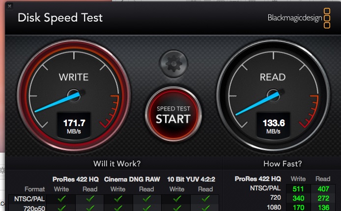

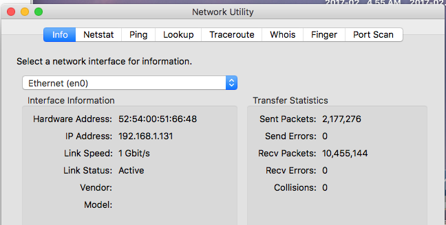

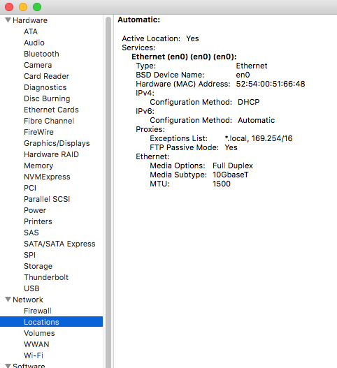

February 12, 20179 yr Author Update After some additional testing, I was only getting about 40-50MB/s when transferring files to unRaid from the OS X vm. This was the same speed I was getting using the e1000-82545em vnic. Since my tests to the synology NAS were consistently saturating the gigabit link with vmxnet3 (something the e1000 would never do) it was puzzling. I then remembered that unRaid SMB in 6.2.4 and os x don't play nice together. They work, just not well. When I reconnected to unRaid shares via AFP within the server, I was getting better than gigabit speeds, about 170ish MB write and 135ish MB reads to a cheap Kingston SSD. Additionally, while the VMXNET3 adapter only shows up as a gigabit connection in os x network setting, under about system, it shows a 10GbaseT after changing network setting>advanced. Oddly, after clicking apply they don't visually seem to stick after going back and checking, but it still shows up under the about system section. VM to VM within the same server show similar speeds over gigabit, but nothing breaks 200MB/s. This may be a limitation of AFP on unraid, or of AFP in general. I do not know. I was unable to determine maximum afp transfer speeds anywhere online. Vm to VM from one server to another over gigabit via afp shows saturating gigabit connection between the 2. When transferring files from a SSD cache disk on unraid to a ram disk in OS X, results were unchanged, meaning the not quite 200MB/s bottleneck is AFP. I believe SMB has been updated in unRaid 6.3.x but I have yet to upgrade and won't have time to do so for a week or two. Hopefully it will have better communications between os x guests and unraid. If so, then I'll be looking for a 10Gbit switch to connect my boxes to since I already use a couple melanox cards cabled to each other between servers for backups.
