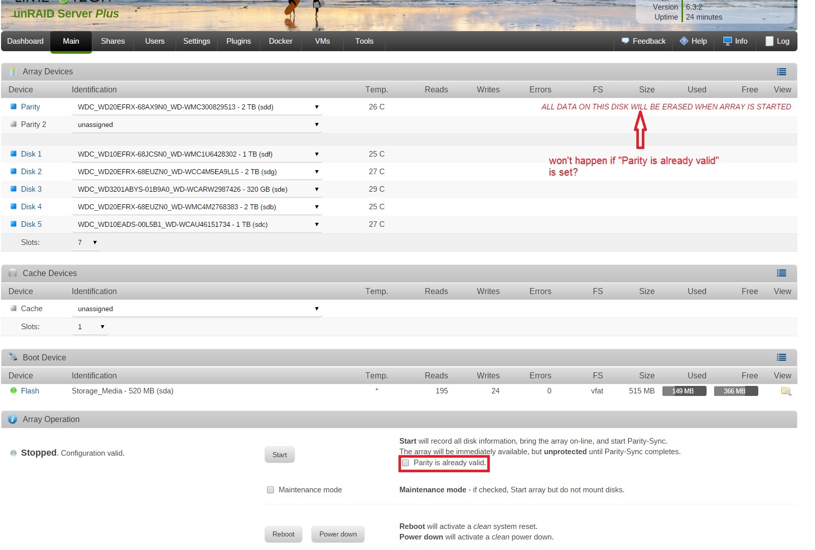

A red notification says "Parity Disk Will Be Rewritten". Please see attached 6.3.2_main.jpg
Questions: (1) Is there a way to verify the validity of the array without rewriting any disk?
                   (2) If I select "Parity is already valid" then start the array without parity check - should it not be valid since I stopped 4.7 before starting 6.3.2?

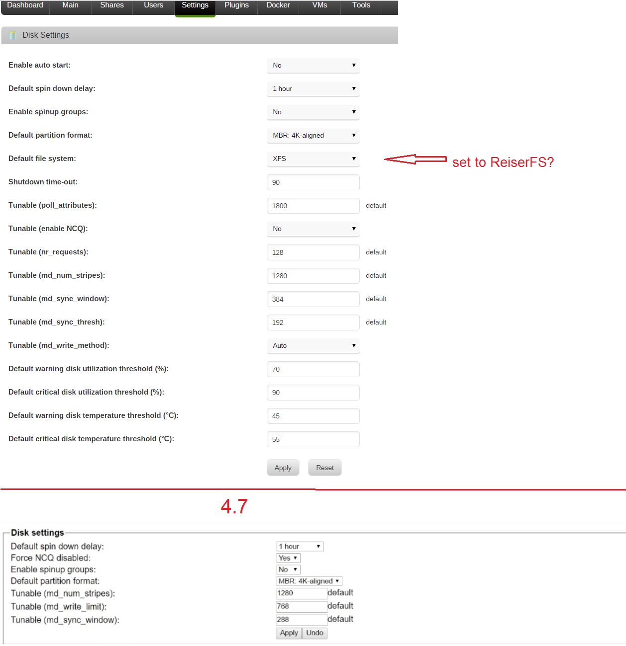

Moving on to Disk Settings.  Please see attached 6.3.2 VS 4.7 Disk Setting.jpg
Questions: (1) Default file system is set as XFS , my 4.7 system was ReiserFS - I assume this is the correct value.
                   (2) A whole bunch of parameters are set to their default values, some are not identical to the previous 4.7 values and some are new, should I leave them all at default?
I'm not going to start the array and continue setting it up until I'm confident that everything is OK up to now and that my data won't be compromised.
Thanks.

First, be CERTAIN that you have your disks assigned correctly -- i.e. you have not mistakenly assigned a data disk as parity.   This would result in the loss of all data on that disk if you assigned the wrong disk.
As long as the disk assignments are correct, AND you are CERTAIN that you made NO changes to the array (i.e. no writes at all) between shutting down the v4.7 config and setting up the flash drive with 6.3, then yes, you can check the "parity is already valid" box and it should be okay.
I'd leave the default file system set to XFS.    This has nothing to do with your current disks -- it just means if you add a new disk to the array it will be formatted with this file system.    There's no problem mixing RFS and XFS disks in the array.
A quick caution. If you follow all the good advice so far and start the array, there is a minor possibility that one or more of your correctly assigned RFS drives show up as unformatted. If that is the case, don't panic. Stop the array, and change the file system type ONLY on the effected disks to RFS. Leave the default as XFS, it won't change the corner case that may cause your drives to appear unformatted. Once you change the individual drive to RFS, it will no longer attempt to make a guess about what file system type, and should come up as RFS without any issues.
The issue is that sometimes the auto file system setting fails at correctly detecting the existing format, so setting it manually to the correct type is required.
One other thing to remember -- once you've got the array loaded, you'll probably need to run the "New Permissions" utility (on the Tools tab) one time.

Questions:
Does the "unformatted" notification appear (if at all) after I power up unRaid or after I click on Start
Where's the individual disk setting? In Settings under "Disk Settings" I only see the global settings  or do I?
Thanks again,
After you click on Start.
On the Main display tab, if you click on a disk (e.g. "Disk 1") it will bring up a page of info on the disk -- the file system type is one of elements on that page.
Basically, you're ready to go ... just click on the "Parity is already valid" box and Start the array :D
... unless it shows an unformatted disk all should be well.    If by chance it shows an unformatted disk, do NOT check the box that indicates it will format the disk;  just change the file system type as jonathanm noted above.
