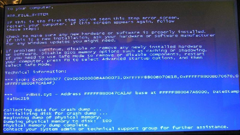

When/If you get a BSOD write down or better yet take a picture of the information displayed. It is vital in searching for a fix to the problem.
Ok, I followed my steps 3 times and got 3 BSOD's.  I have attached a picture.
Amazingly here is a google search discussing this very stop code regarding Samba shares and the security = share.
http://social.answers.microsoft.com/Forums/en-US/w7repair/thread/fac35fde-7e6e-4a75-b60b-82048ca0c78f
Since I don't have the Plus version I can't test if it actually will resolve this issue.  So, again, does anyone with the Plus or Pro version want to volunteer to test this?

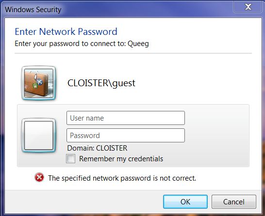

I added the global setting to my smb-extra.conf file.
1. When I try to browse the the new share or my existing array shares it wants a user/password.  Where/how do I set that?  I'm using the free version.

I would try logging in as "guest"
Hmm... Do you have open file explorer in separate process enabled? If not, it might help to keep the crash to only the new process and not the entire system. To enable it, navigate to the following location:
Windows Explorer, Alt - Tools, Folder Options, View tab, Advanced Settings, "Launch folder windows in a separate process" checked
I set it as you indicated - still BSOD's the machine.
Logging in as guest doesn't work.
I believe I got the BSOD worked around thanks to Joe's suggestion with the smb-extra.conf global entry.  I read up on it and found a way to choose security = user but still have all the shares work like security = share, meaning public access with no login required to connect.
