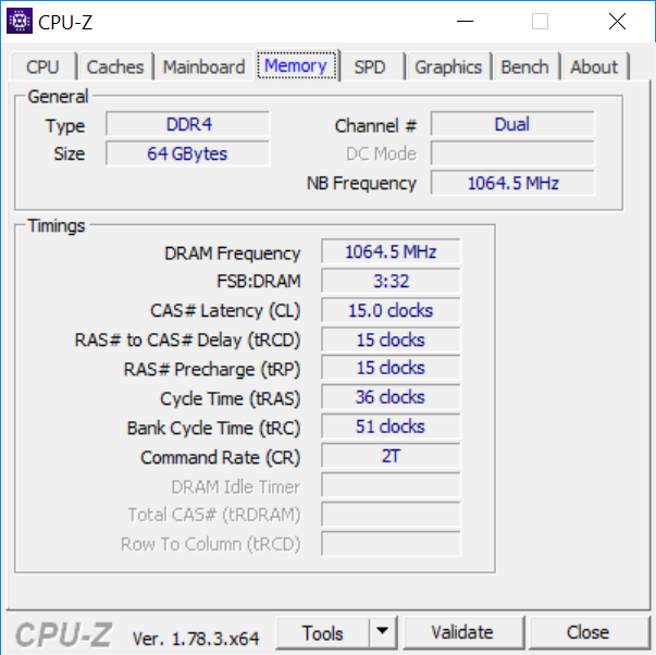

I'm running my 64GB or DDR4 2133 dual-rank at rated speed. Can't expect much more with that much memory.  CPU-Z shows 1064.5 MHz, so you double that (DDR) to get to ~2133.  This is on straight Windows 10, not in an unRAID VM.
Any way I can tell from my Memtest86 results if the problem is with a specific stick of RAM?

It's funny, almost everything you guys are describing (and I greatly appreciate the insights, thanks!), I've already been through on this build.
My 64GB kit is G.Skill, and it initially only booted in single channel mode.  I had to rotate the DIMMs by 1 slot to get it into 2-channel mode (probably just re-seating the DIMMs addressed the issue).  This is the kit that showed errors on the 3rd Memtest pass, when running at 2400.
My spare 4GB stick is also G.Skill.  It passed Memtest, at least 4 passes with no errors.
ASRock has not validated any G.Skill 64GB kits for this motherboard.  My choices were HyperX, ADATA, and SANMAX (never heard of them before).  There were 7 ADATA kits validated (though they all appeared to be the same sticks with just different heatsinks and lighting).  There was only one HyperX, and this lone kit was the only one available locally in the states.
Unfortunately, HyperX is a Kingston brand.  ASRock is basically forcing me to go in a different direction than common wisdom.  It has good reviews, at least for the few reviews it has garnered.
From what I've been reading online, as far as hitting high memory speeds with Ryzen, Samsung memory chips seem to have the best compatibility.  No idea what is used in these HyperX sticks, the heat spreaders prevent reading the chip markings.  I might be able to tell from a program like CPU-Z, though.
