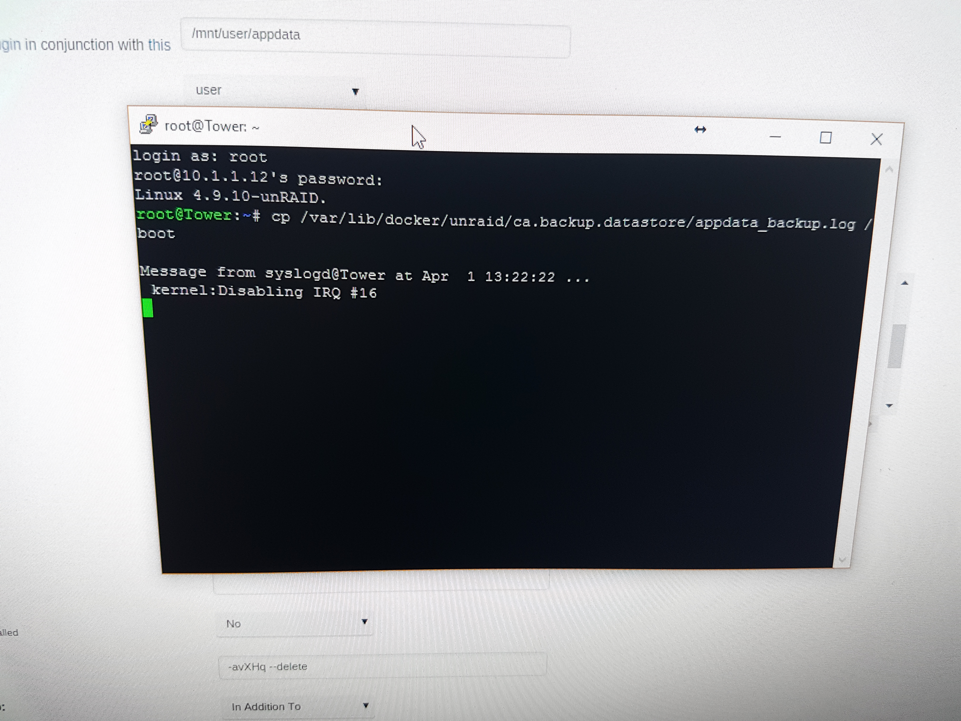

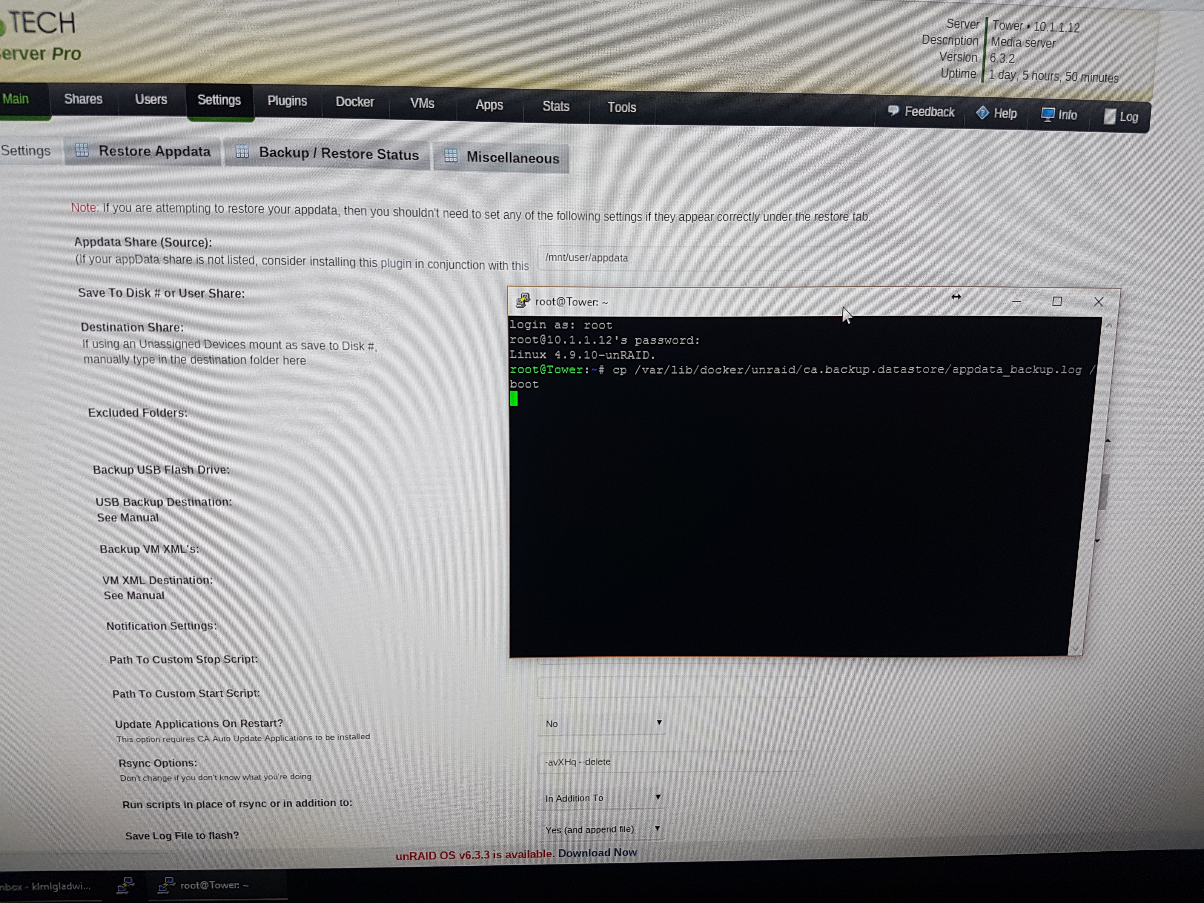

Ok so I saw there was a copy rsync log to flash setting in the CA Backup Settings which I wondered if this did same thing as you suggested. So i changed settings back to backing up to user share and not a particular disk and thought i would test to see what was actually outputted to the flash drive. I come back in 5 minutes and its locked up just the same!
SSH'ed in a logged in, ran " cp  /var/lib/docker/unraid/ca.backup.datastore/appdata_backup.log   /boot " which gave me this (assumed typical time out or something):-
Then this added to it after about 1 minute-

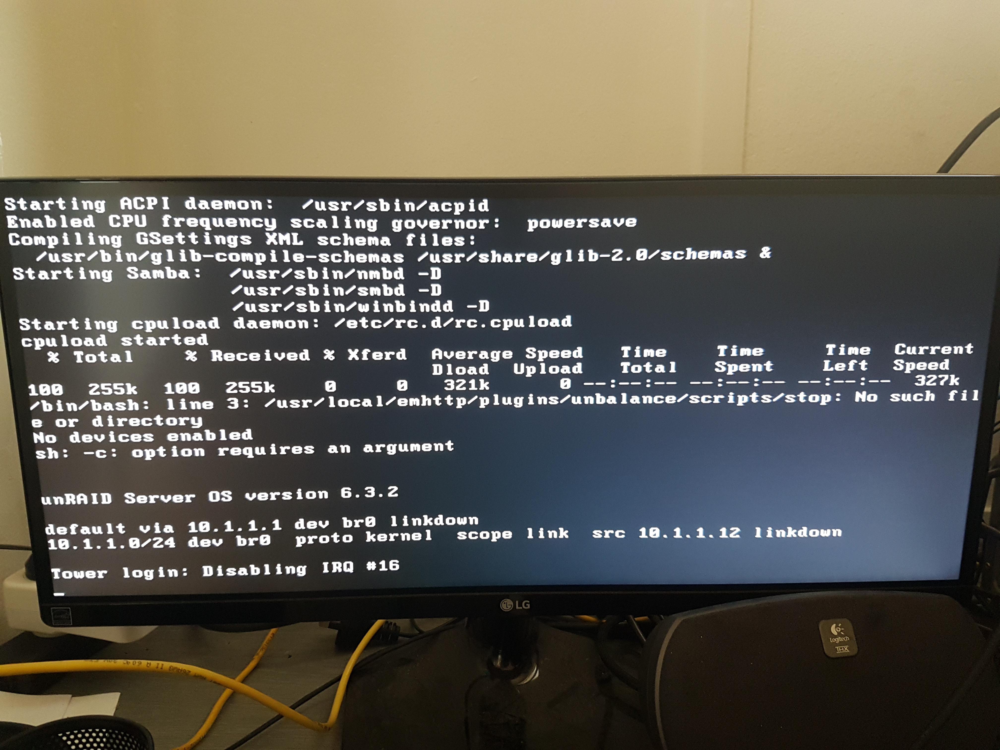

And this is local monitor:-
Right now I cant access GUI, dockers, anything. I will hard restart and put in trouble shooting mode and repeat same procedure hopefully capturing logs needed.
Will report back again when thats done.
Cheers
It is, but when it does it is too late for when I wanted.  Takes a while because it is a huge file.
IRQ 16: disabled    Now that's what I was looking for.  :D (Well not exactly, but it is something to go on, and in retrospect makes some sense)

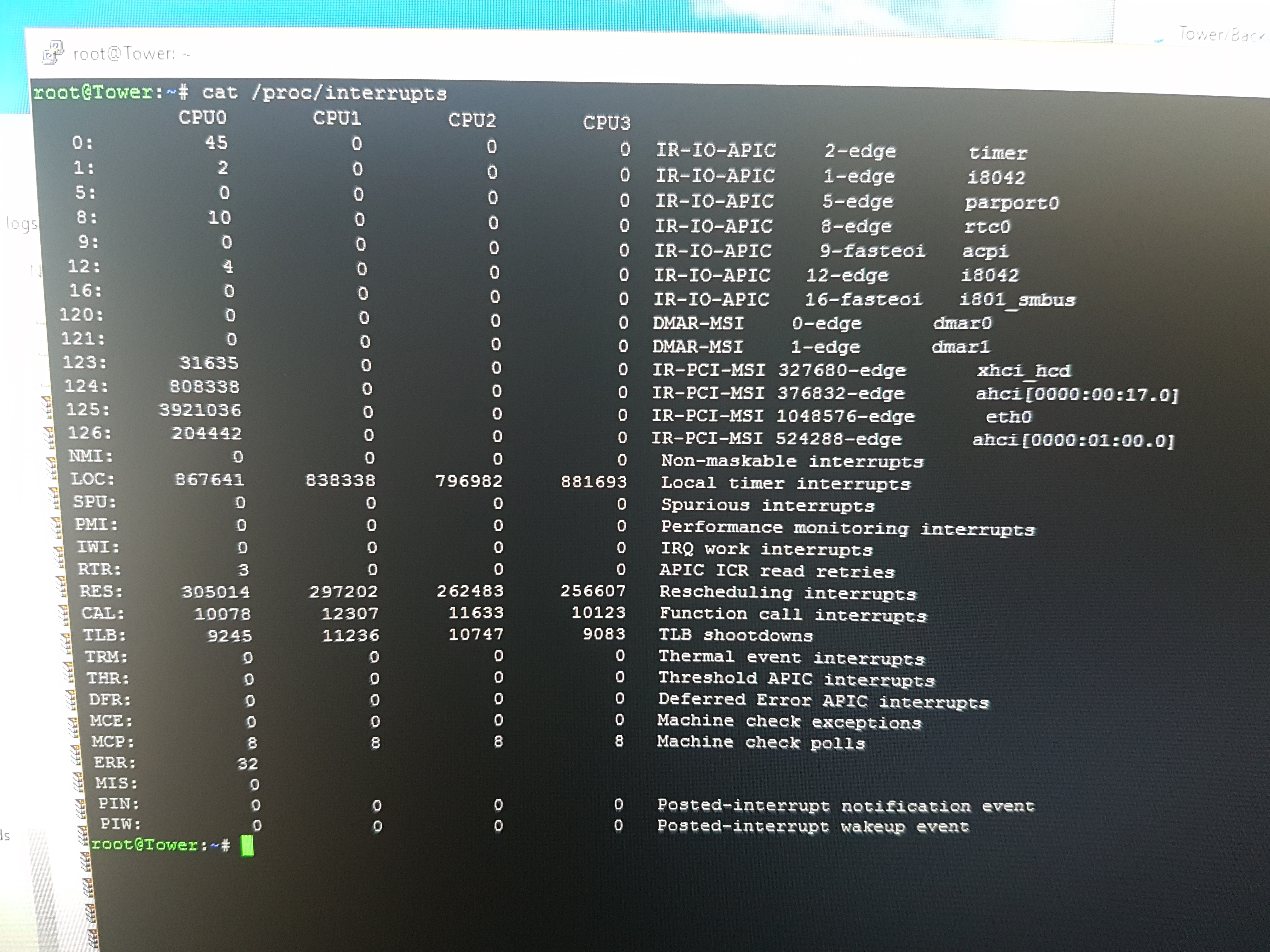

After you reboot, can you post the output of
cat   /proc/interrupts

Sorry was one step ahead already.
I rebooted and put in trouble shooting mode and re-ran manual appdata backup.
Seemed to finish OK (on the status page in CA backup settings) and I was able to use some dockers but not all (lIke some had restarted but not all of them).
No GUI still and forgot to check local monitor! I also forgot to capture the ca appdata backup log. Doh!
This time I could seemingly also still use console so I did the " cat   /proc/interrupt " as requested.
All info (i remembered to get) attached to this post. And now i'm in trouble with my 4 year old daughter as her movie on Plex keeps stopping!

I think @RobJ might be able to help out here on why IRQ 16 is getting disabled (appears to happen under high I/O load), as I think he might be of more help.
Since that screenshot was presumably after the reboot (when IRQ 16 is functioning normally), can you try and replicate this again, and after the IRQ gets disabled do the same
cat /proc/interrupts again as a comparison  (But do it after your daughter goes to sleep)
I think [mention=189]RobJ[/mention] might be able to help out here on why IRQ 16 is getting disabled (appears to happen under high I/O load), as I think he might be of more help.
