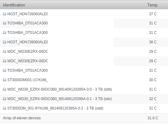

Sure it is not a good idea, curently I have an unRAID run on QNAP HW, it haven't PCIe for add-on.
Due to I want utilize it, so I add a cheap 5 bay USB enclosure (less then USD 100). In first, it have many problem, always reset/disconnect ( even test on a Windows PC ), can't read SMART etc ...
Finally, test/try and search on Internet almost 2 months, I got a solution by changing (1) Encloseure firmware, (2) Add a VIA USB hub between them, then it work stable.
BTW, it still have limitation,
(1) Don't let unRAID spin-down the HDD in enclosure, the disks will spin-up after few secord, and may cause the enclosure reset.
(2) Total BW will be ~300MB/s, that means if connect with 5 HDD, parity or disk check will got 60MB/s for all array disks.
(3) Disk Identification not be usual, i.e. last 3 disk in enclosure. So change disk or slot location, you need remove/add them again in array.
Anyway, this is my case, different HW will got different result.

If your USB-drive works perfect as unassigned ntfs drive ( in fact no matter what FS is ), I'm sure this won't got problem be an array member.
During 2 months troubleshoot, I found most 2+ bays enclosure also got same problem, always crash / reset, the issue relate to thier chipset solution - Jmicron.
There are hard to found other chipset solution for 2+ bays enclosure.
The hub haven't slow down the speed, it is 1-to-1, if without it the enclosure will reset all time during mass read/write.
