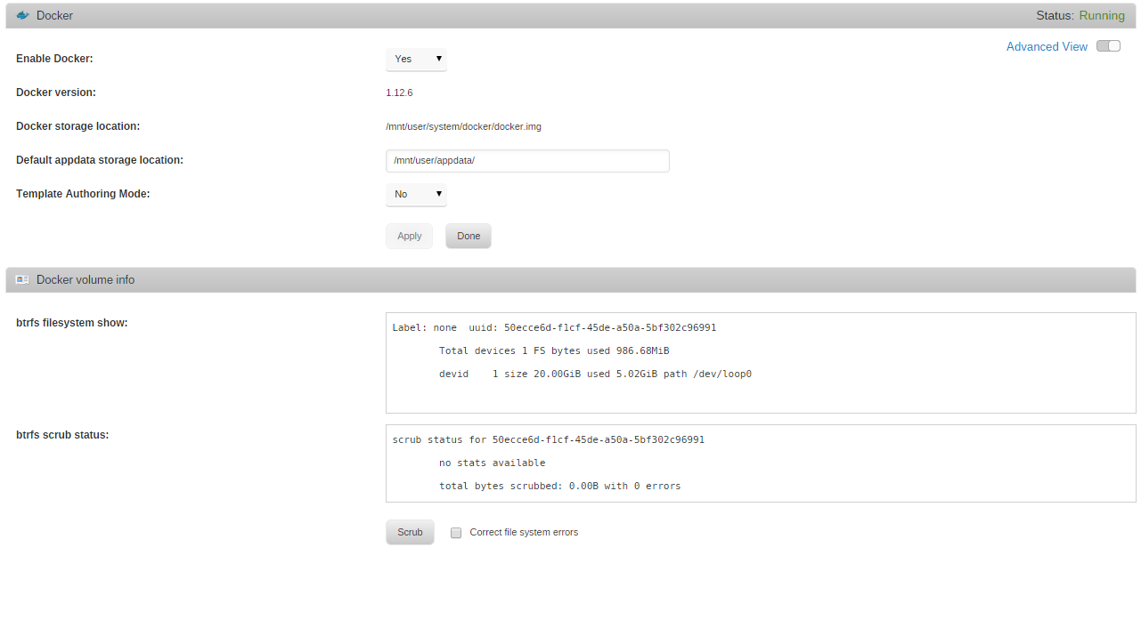

OOops,
Answer will be in pic im going to attach with this post.
As far as i remember never touched anything in docker service settings of course except enabling docker service.
That looks OK.
