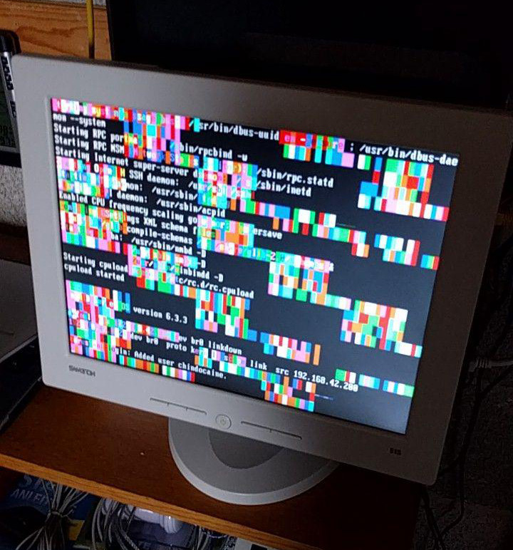

This morning i couldn't access the server again. Of course it froze again. No networking, no local console. But this time the screen looked quite interesting (see attached photo). Unfortunately I couldn't get any log files since I wasn't able to log in before rebooting. There were no VMs or Docker containers running.

Since you say memtest passed an extended test, about the only thing it could be is motherboard or cpu. That corrupted screen means the video RAM doesn't contain sensible data any more. Normally when you see something like that, it means bad video RAM, which is system RAM on a board with integrated video.
Thanks for the reply, the RAM was also one of my guesses, but it's odd since it passed memtest. But yes, it uses integrated graphics. The motherboard is a Gigabyte B85M-D2V, the CPU is an Intel Celeron G1840.
