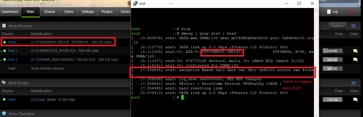

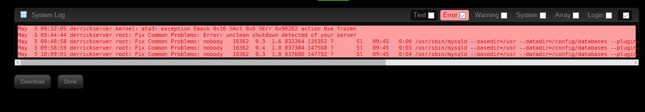

I've found some weird error messages while browsing the syslog, anybody make heads or tails out of it?
Just found something more... hopefully relevant:
Edited by Guest

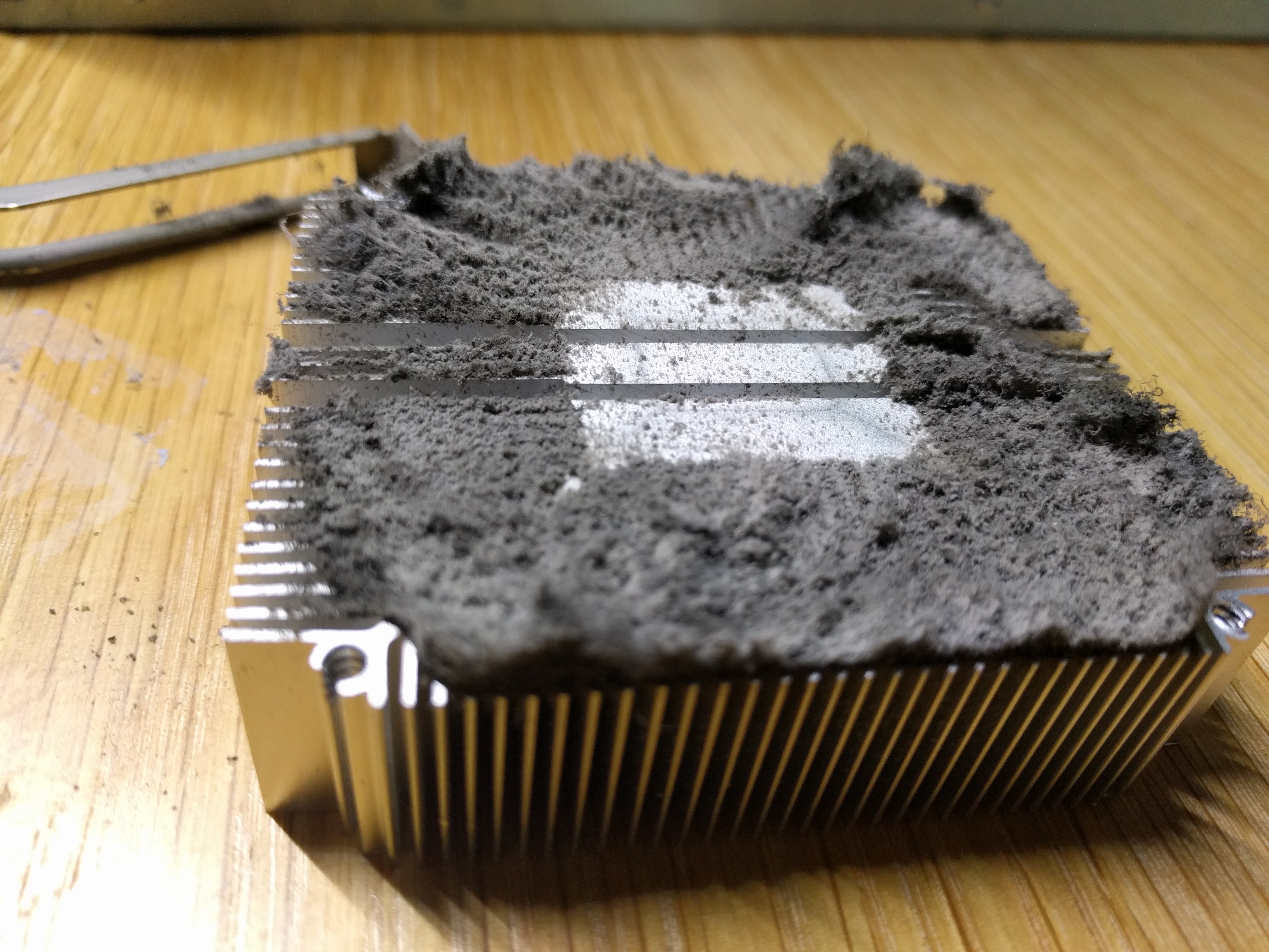

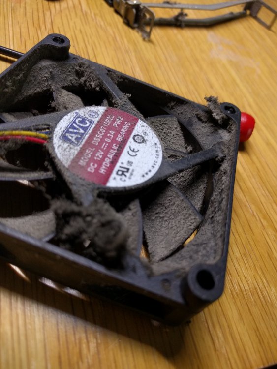

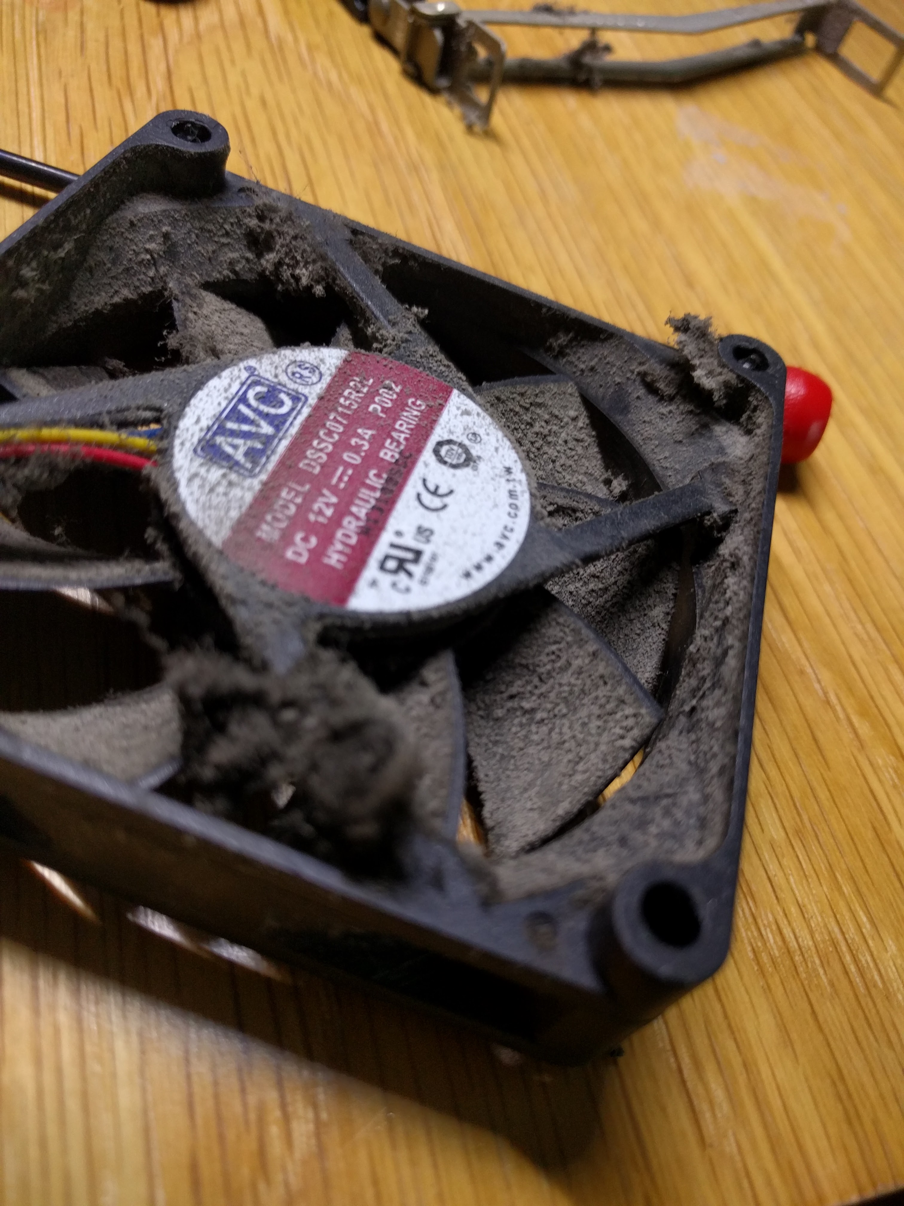

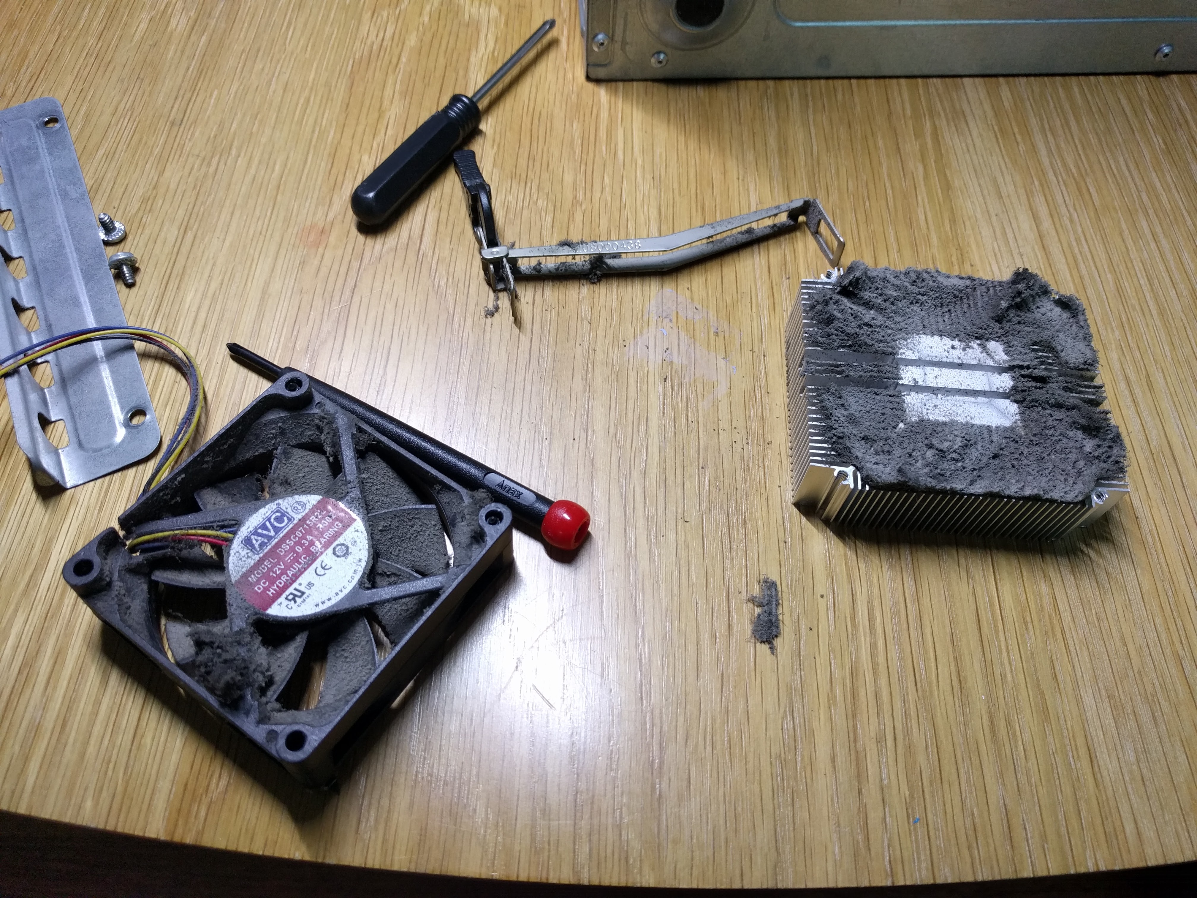

I ended up solving the mystery when I opened up the server on my workbench. So the room I keep the server in is dark, and when I open the case it's usually for some last-minute checkups and additions like making sure the SATA cables are properly seated and reseating the RAM and that sort of stuff.
So when I opened the server up on my workbench with better lighting conditions, I was met with this situation:
IMG_20170503_183216.thumb.jpg.fbedf7de56f87744a1d1f9518a25fbee.jpgIMG_20170503_183223.thumb.jpg.f032c5cc23203d6378be3078e2d9560d.jpgIMG_20170503_183322.thumb.jpg.f4f99e56fe66746dbcd4146c4af87c01.jpg

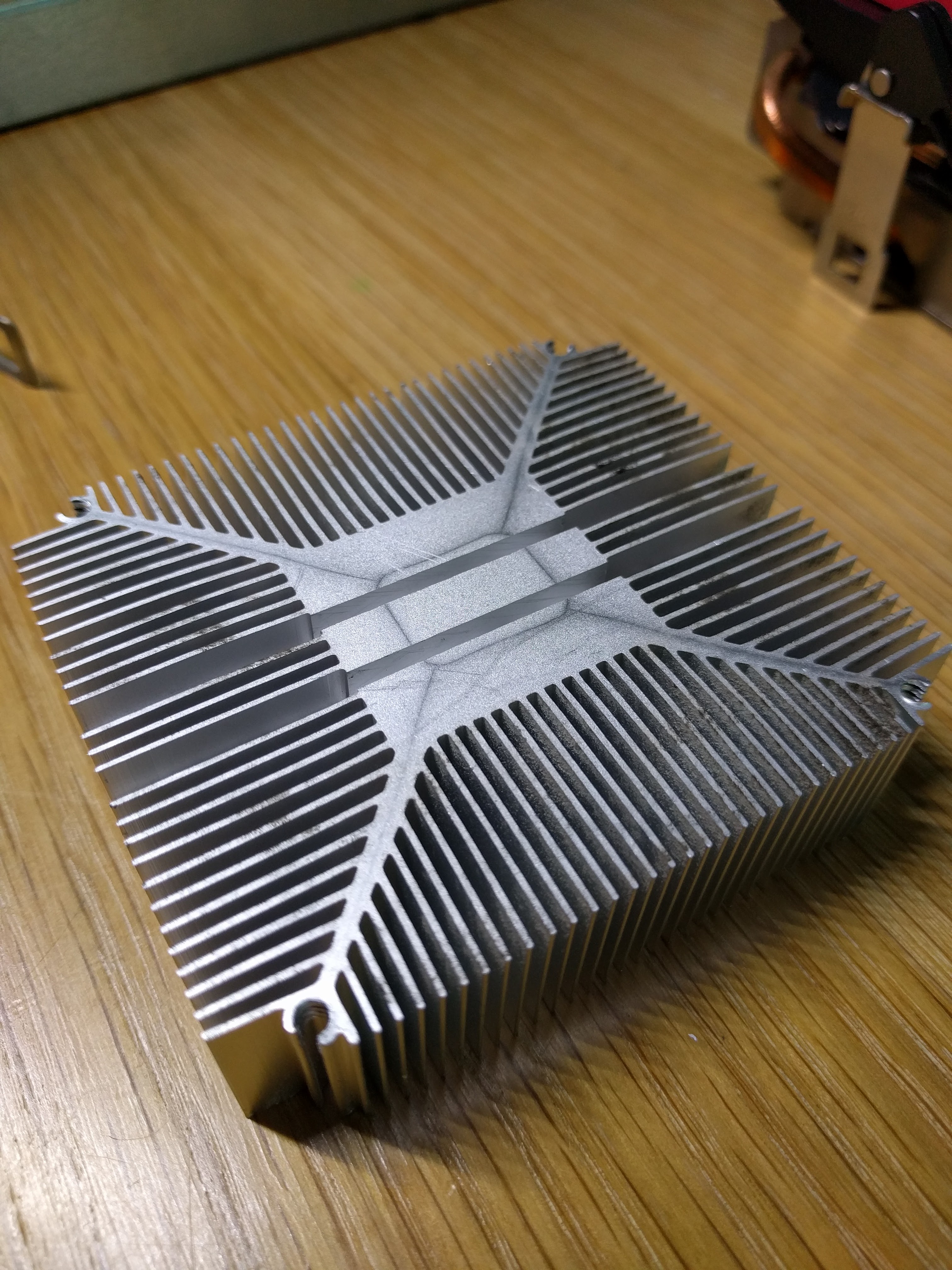

I know, I know, I was completely stupid and the CPU was overheating. This is what it looked like AFTER cleanup:
But it's still weird that UnRAID does not warn the user if the CPU is overheating... can this be addressed in a future release?

Looks like you didn't touch that system for a while :)
unRAID itself doesn't monitor cpu temperatures, this is only available as an optional plugin.
Adding CPU temperature support is a tricky thing because there is a lot of hardware dependency. You'll will see miss and hit stories of people who have installed the Dynamix System Temp plugin. I guess LT is not much in favor of carrying all the extra burdon to do this.
Ps. Most motherboards have the option to shutdown the processor in case of overheating and prevent real damage.
Edited by bonienl
Well, I think I've solved the problem. The server hasn't frozen up. In the future I'll look at more adequate cooling solutions.
Thanks to all the help! And @bonienl thanks for the Dynamic System Temp plugin. Maybe @Squid can add it to his Fix Common Problems plugin?
