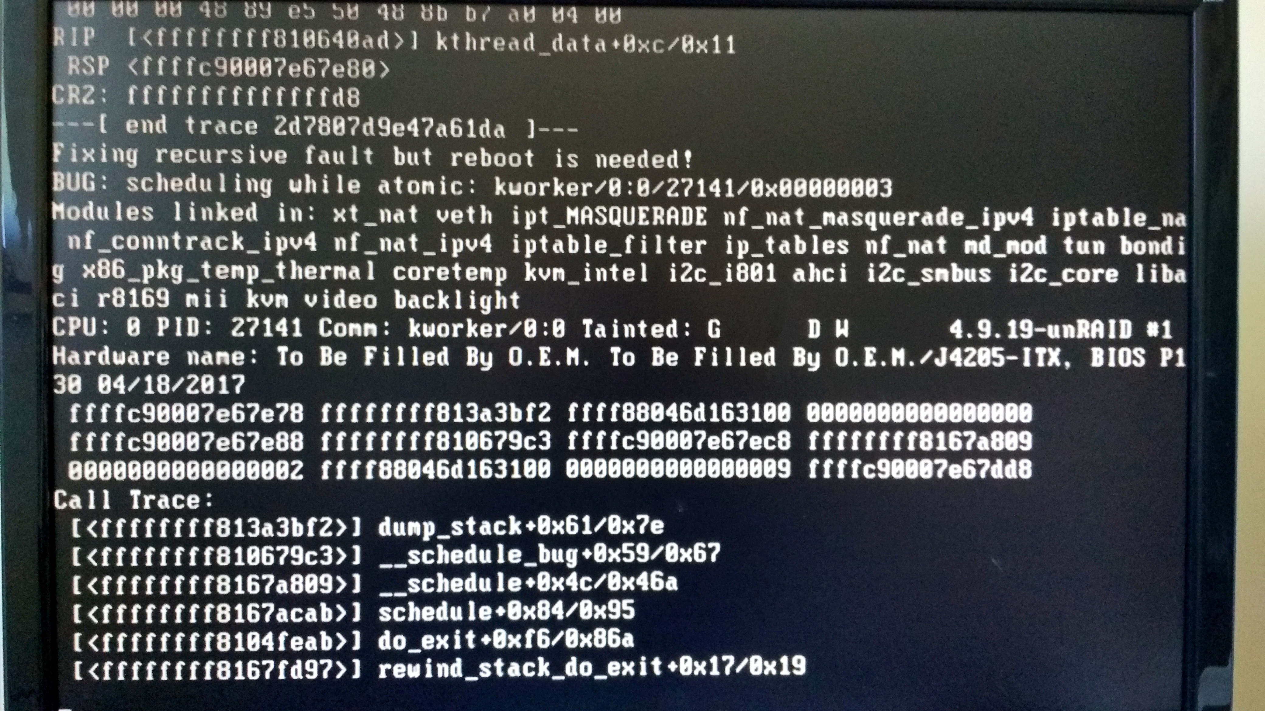

But now server was if some failed state, not sure if you can see the error in diag, so i made screenshot as well.
I didnt had those issues before, strange - ive changed USD flash drive before i bought the product, but as far i understand it just load it once during the boot and thats it...
unraidtower-diagnostics-20170519-1405.zip
Noticed the clocksource doing dance between tsc and hpet.  Perhaps Apollo Lake support in 4.9 Kernel not quite fully ready?  Someone with more Kernel experience will need to chime in or get the attention of Limetech.

Tsc was final clocksource and had switched to it from hpet. I had a loop in my search and didn't catch it and assumed it switched from tsc back to hpet, but it didn't for the duration of the log that was posted. If keep having issues post another diagnostic before rebooting, if possible.
