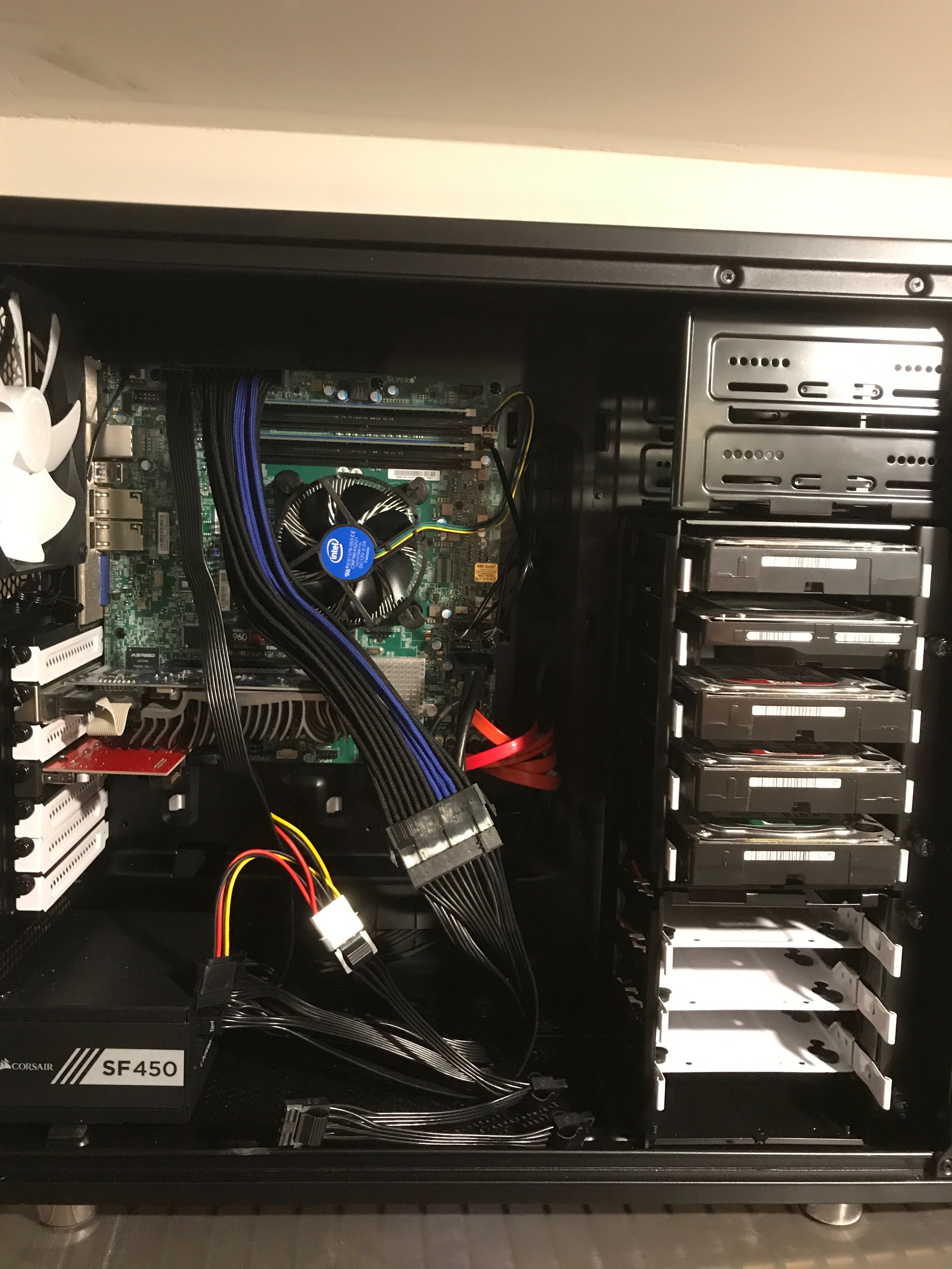

I'm loving my new server! It is fast and the unRAID transitions from one computer to the next so well. I just had to connect all the components and turn the computer on. The mobo has simple VGA capabilities, so I didn't need to use my old GPU. I've repurposed that for a Windows VM (a big shoutout to @gridrunner for his great tutorial). The GPU gave me few fits, but once I changed the BIOS settings on the card and the mobo to EFI everything works pretty well. The only problem with my old GeForce 8400 is that after I shut down the VM, I have to restart the whole server to get the GPU to work again. I'm assuming that a newer card won't have the problem.
I also followed this tutorial and got a USB card passed to my Windows VM and it works great. Now with all this VM goodness I can have my server hooked up to my theater room and play some great games on the big screen! And it'll be even better once I save up and get a new GPU. I'm thinking a GTX 1050 Ti would be the best bang for the buck since I'll be maxing out at 1080p with the projector I have in my theater room.

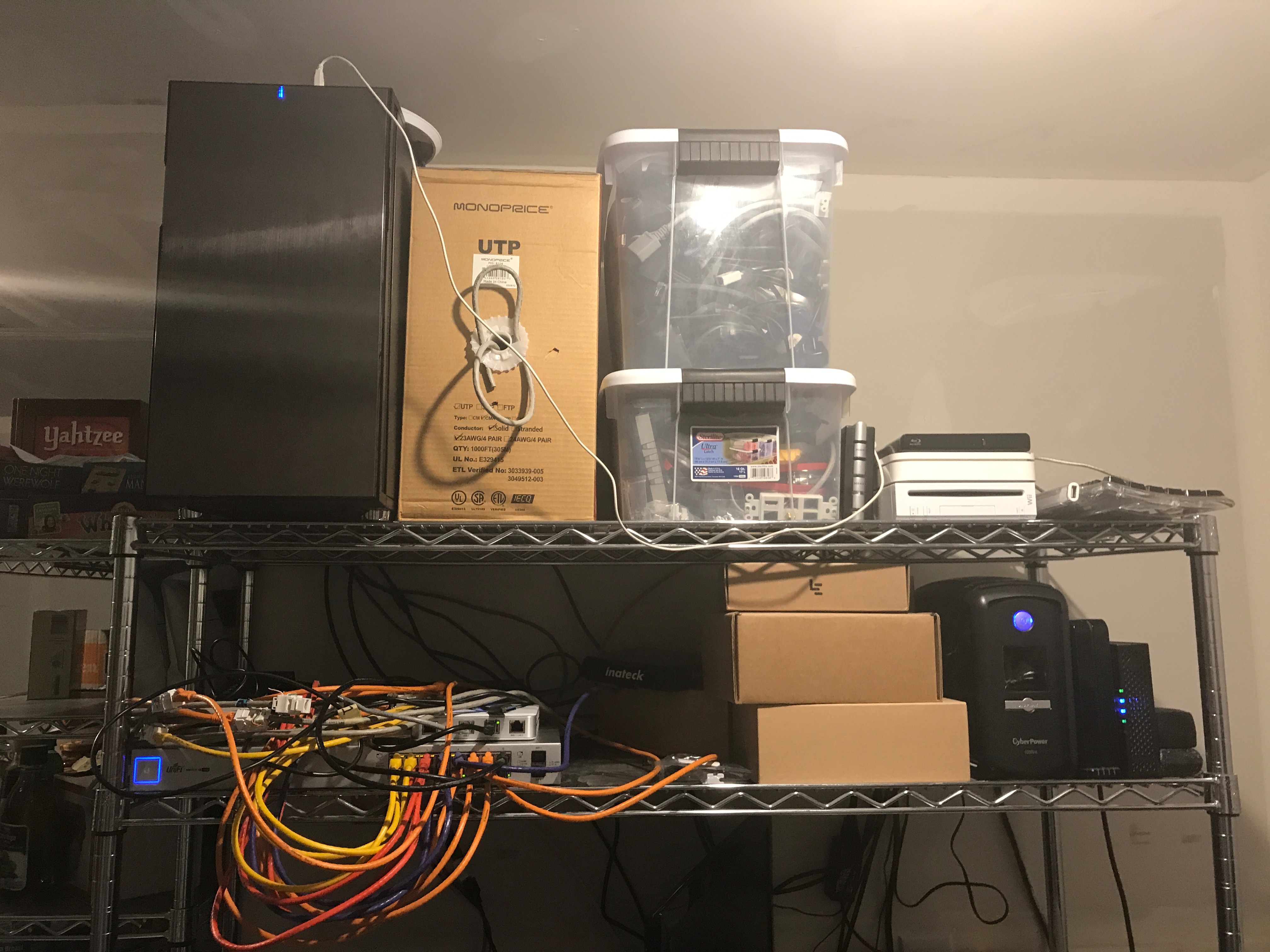

As far as specs go, I've watched the electrical load on my UPS (which now works over USB with my server - previously I couldn't get the two to talk to each other) before and after the changes. I have my whole network (Unifi USG, AP, and switch, cable modem, unRAID) on the UPS and so I don't have exact numbers for just the server, but I think it idles around 24-28 watts (The total of everything idle is 84 watts). And everything is so much faster. The 960 Pro is amazing and I'm loving having a cache drive - copying files to the server is lightning fast now.

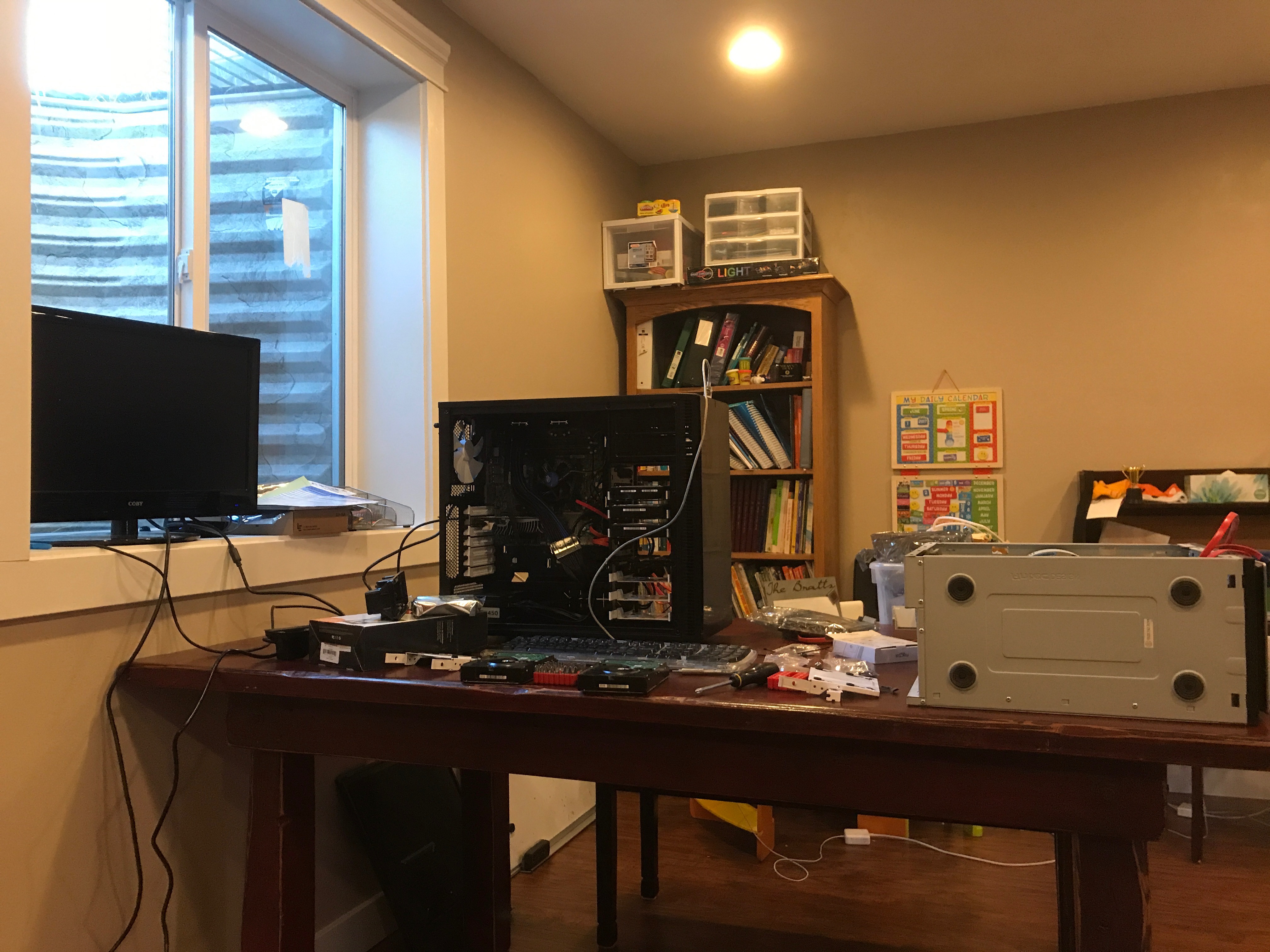

Also, here are some pics of the process as I transferred drives and built the new box, and what it all looks like now. There is plenty of expansion room with this setup. My next upgrade is to get a 2nd parity drive.
Thanks again everybody and I hope this post helps someone else building something similar.
