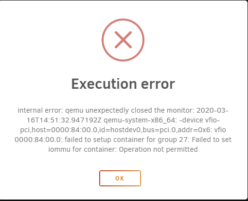

Execution error
internal error: qemu unexpectedly closed the monitor: 2016-12-17T15:42:06.737278Z qemu-system-x86_64: -device vfio-pci,host=03:00.0,id=hostdev2,bus=pci.0,addr=0x9: vfio: Error: Failed to setup INTx fd: Device or resource busy
2016-12-17T15:42:08.620251Z qemu-system-x86_64: -device vfio-pci,host=03:00.0,id=hostdev2,bus=pci.0,addr=0x9: Device initialization failed

Followed the guide, see it in my pass through:
Check the box, save the settings.  Try to start the VM and get the following:
edit: I've also tried all 3 different settings for ACS override and the error persists.
Edited by JasonK
