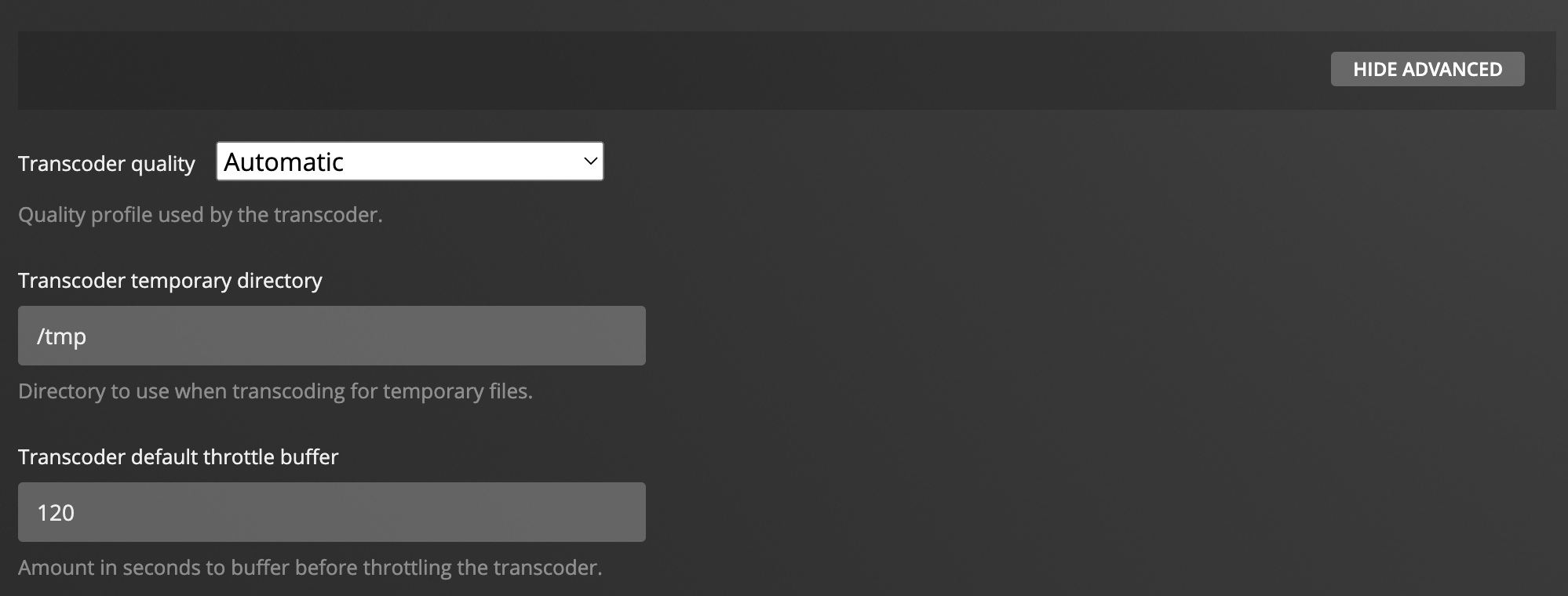

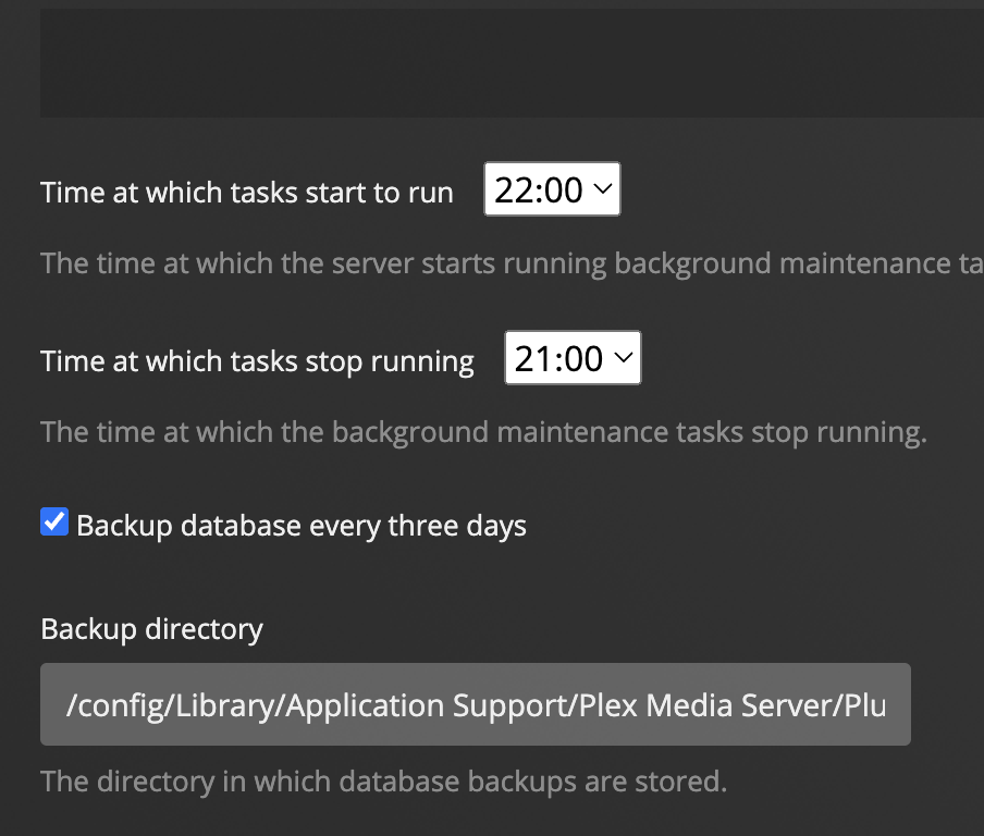

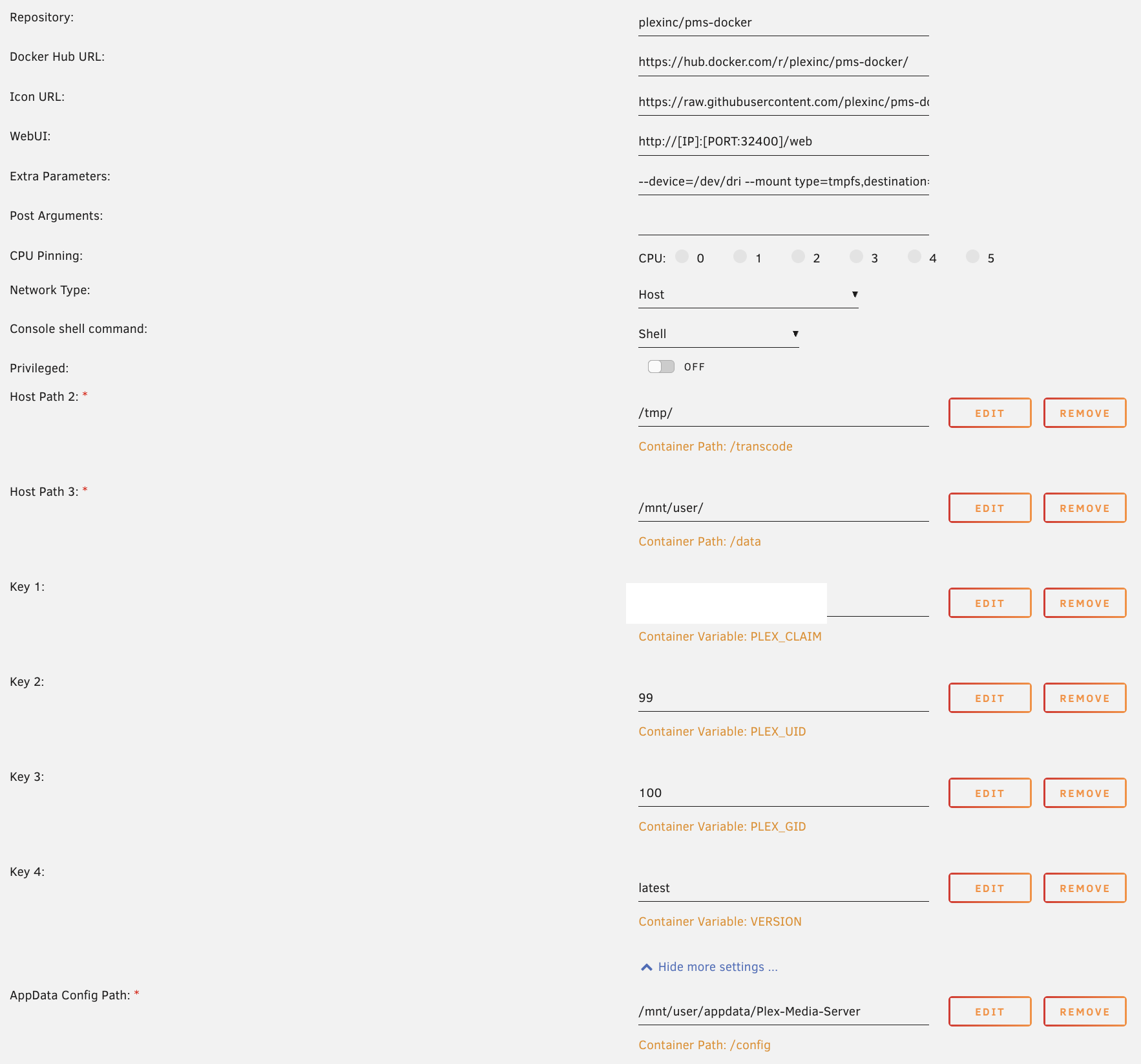

  6. I'm running Plex Inc's PMS Docker and have the parameters set up for hardware transcoding and its directory set to RAM. I followed the serveral guides online to set this up. Settings attached! I suspect Plex's metadata is getting saved to RAM since every time my system reboots, my library mappings within the app are all reset and it re-downloads all my metadata files upon correcting the file mappings. Is that possible? Any help from the community would be greatly appreciated! Also attaching screenshots of the settings from within the docker and the template vvolfbox-diagnostics-20221204-2234.zip
