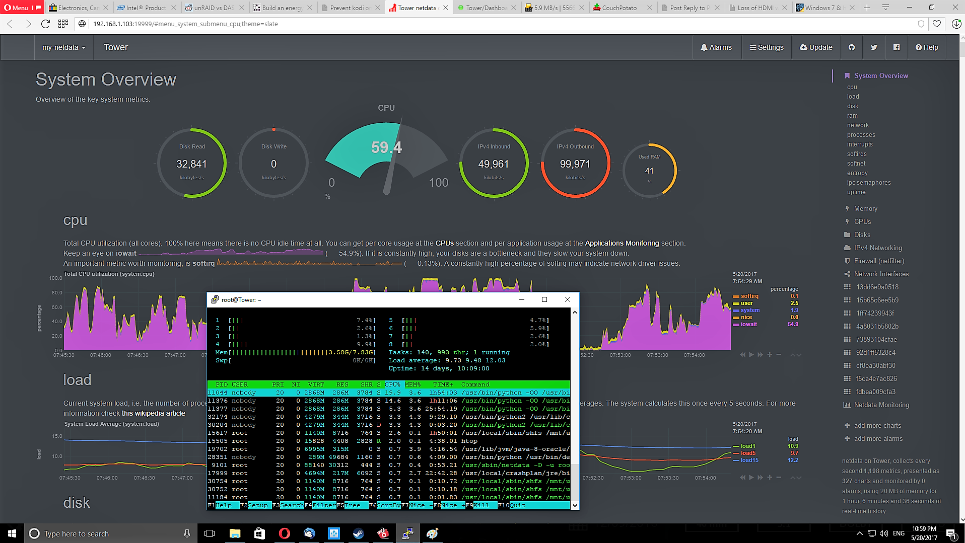

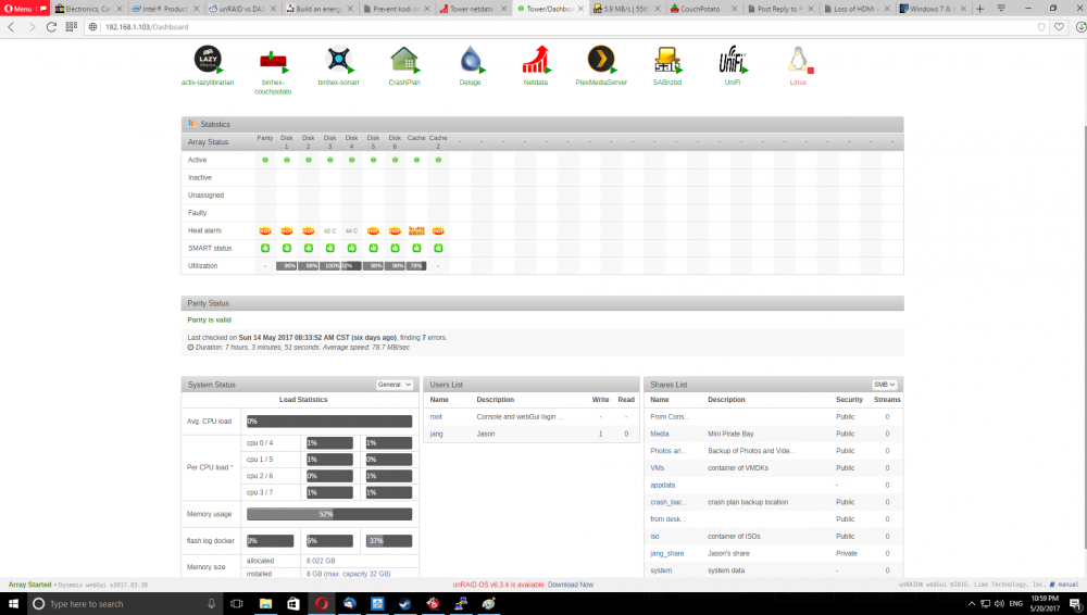

What's wrong with attached pic, have to wait whenever trying to access gui of docker apps
Whenever I try to right click on Sab, CP, Sonarr, etc. icons to access webgui, there will always be a wait (sometimes up to 5 seconds), before the options to access webgui appears.  I've attached a copy of my dashboard, and netdata at a period in time, where usage is low, but still slow.  Has this anything to do with me downloading in sab at 5 MBps?  Furthermore, I don't see how to allocate more resources to the app that's causing all the delay.  Kindly check screenshot.

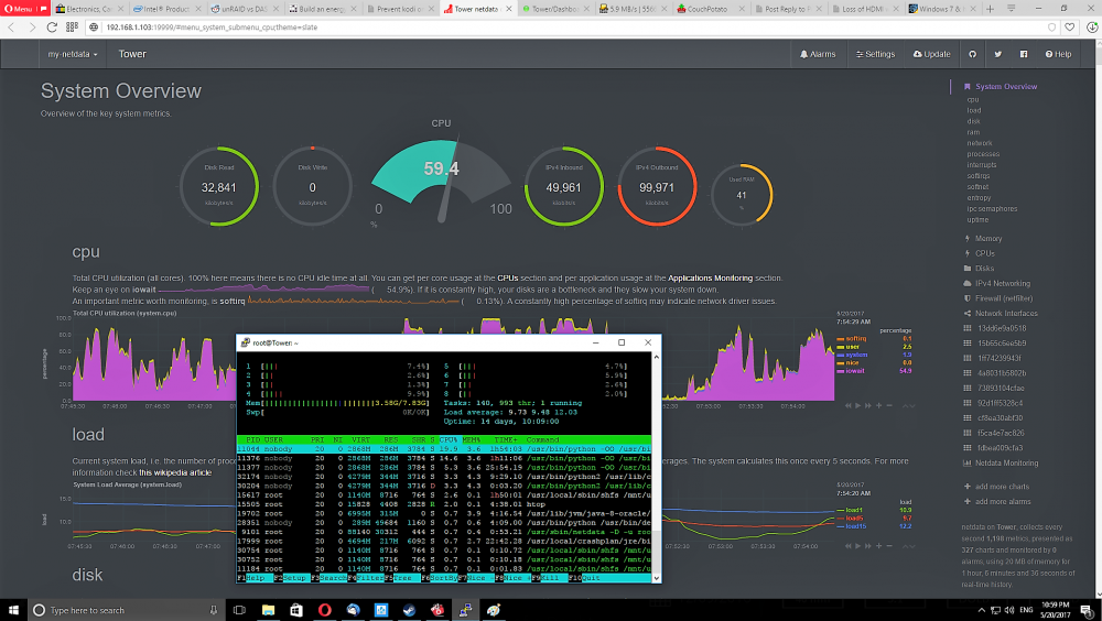

At the time of your pics your five or so second delay is to be expected based on the load average shown in htop.  You have a four core CPU with 9+ loading which appears to be from I/O loading.  The netdata page shows iowait is what is holding things up (CPU is basically waiting for I/O to finish).  Could use iostat to help locate which disk is the culprit, but looks like not installed by default and doesn't appear to be available in the nerd pack either.  Based on the top four processes in htop being python with the next process being shfs I would assume you have some post processing going on which is disk intensive.  Is interesting the netdata disk I/O meters are not showing all that much going on (~33MB/s), however.  Slow disks and/or anemic controller or is there more than one post process being done on same disk?
Hi unevent.  That's a wealth of information you're sharing :D  Unfortunately, I don't have an answer.  I've seen a few post processing happening together in Sabnzbd, but not sure if that is what's happening during that time.  In general, it's my user experience when I try to access webgui, I find the web pages don't come up immediately.  My disks are old though, and may be 1 of the reasons for slow post process? Hence the wait?
The closer the load average gets to 4 with your cpu the slower your server will be to respond and at the 9+ you had at the time of that pic things were a bit frustrating I'm sure.
Thanks unevent.  I'll try to learn how to read this charts, and reports.  Can probably help me address this system better.  So for the moment, you think an upgrade in RAM will help?  I assume processor isn't the issue here either, right?  Disk activity being the most likely culprit?
Memory looks fine based on the data displayed. More memory is not a bad thing, but i think the issue is slow disks or something slow related to disks. Post a diagnostics and will take a look.

I see a few issues.  You have a couple Hitachi disks that are rather slow (sustained data rate (MB/sec) 64.8 - 31 (zone 0 - 29)), disk 2 which is the Seagate ST2000DL003-9VT166_6YD04VWX has read errors and you have performed a parity sync with read errors (corrections to parity made) and there are disk capacity/disk full issues as well.  Suggest tackling your disk and capacity issues and things should improve.

I did notice your parity checks are occurring a couple hours before the mover is scheduled.  Might want to separate those so they do not overlap.  Also  performing parity checks this often is not necessary.  It is also wise to run non-correcting checks before running correcting checks just for scenarios such as this were there are disk issues.  I gather these parity checks are on a schedule, and if true, I suggest turning that feature off - it is a bad idea unless they can be forced to be non-correcting checks.  Disclaimer: there is a lot going on in the logs and I might have missed something.  I see one correcting check, not sure if the noted parity corrections were done with a correcting check.  Older unRAID versions used to state clearly correcting vs non-correcting checks.  I think now is says 'check correct' and just 'check' for non-correcting, but could be wrong.  Check cables for disk 2 ST2000DL003-9VT166_6YD04VWX, it may be what is causing the read errors.  I see no pending sector counts, however, hardware ECC recovered error count is high with 25 uncorrected errors being reported.  27,654 power-on hours, however, it is not the oldest disk in the collection.  I would not trust this disk until the problem with it is found and corrected or the disk replaced and then ran through a preclear cycle or two.

if you can replace the drive that will give you more time to work with the faulty drive to determine if it is cable related or faulty drive. The ECC hardware error count is very high and there were a significant number of uncorrectable errors. This info is in the smart report for the disk. The other info was gathered from the syslog files and the pic you posted.
