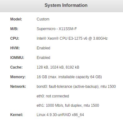

Thanks everyone!   I'm going to stay with the Katy lake.  I got confused with igpu vs onboard video.  Even though the Kaby lake CPU has integrated graphics that I cannot use, I want the 73w and faster clock speeds.  I can always change the mb later if I don't like this one.

All of my parts came in so I'm building it this weekend.  Should be running memtest by Sunday. :)
Server is running memtest with no errors, so far :)  My mb did come with the current bios, so booted right up.
