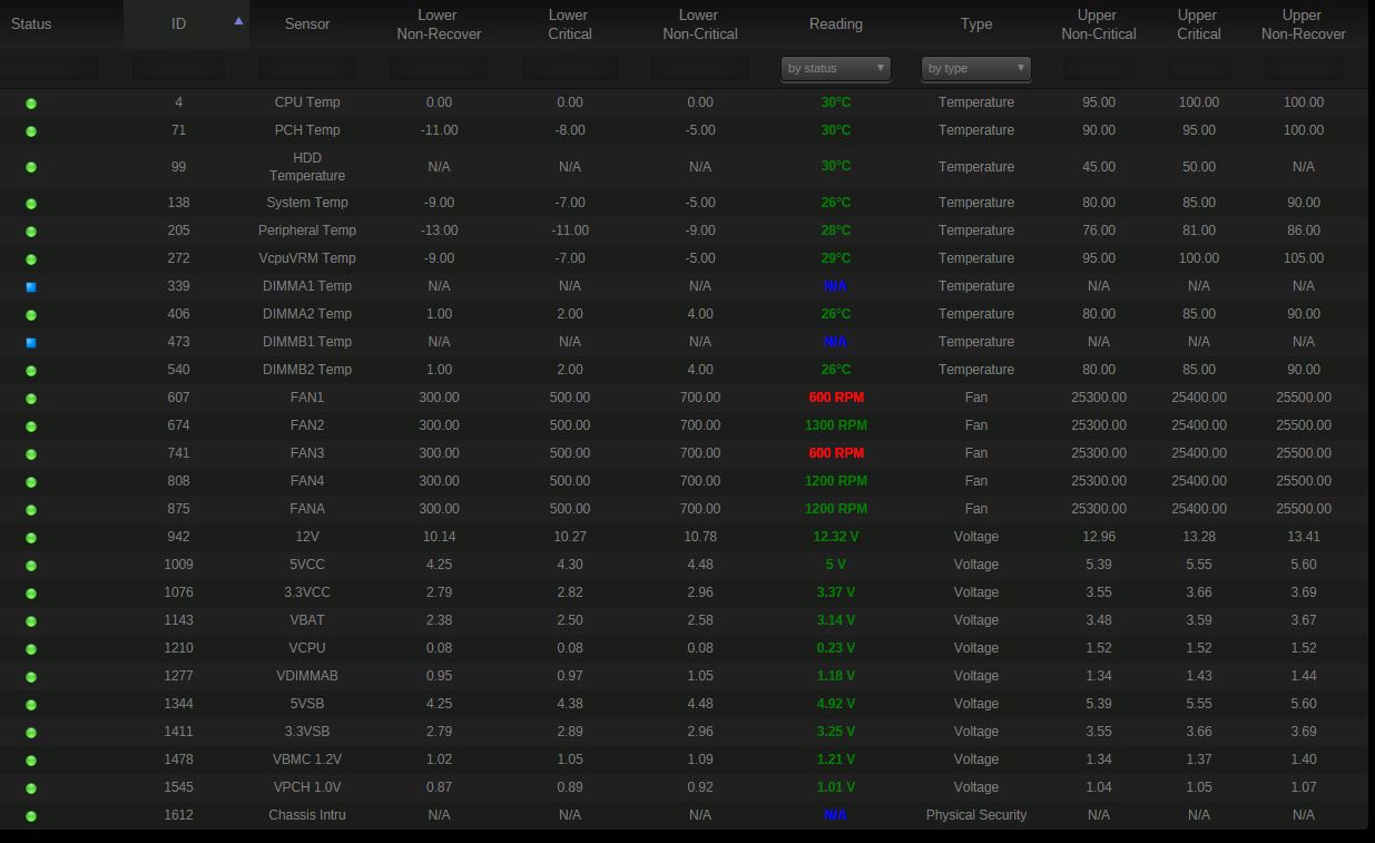

@ Tribble - here is the IPMI status screen while my server is at idle.  Not sure how to get cpu voltage actual reading while idle.

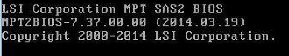

@ johnnie - My system is taking 3:04 at the LSI screen, then it Initializes and works fine.  I would love to know what settings you have exactly.
I have searched, read the manuals and tested, with no luck.

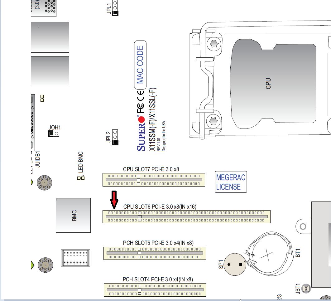

This is the only add-on card I have installed.  I tried a different PCI slot, didn't help.  I added a picture showing which PCI slot I used for the 9207.

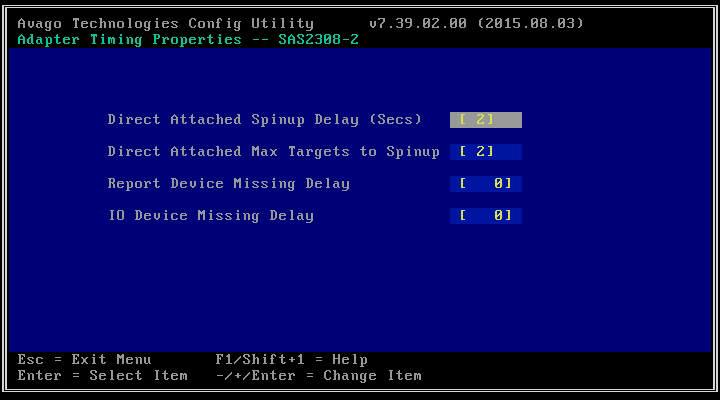

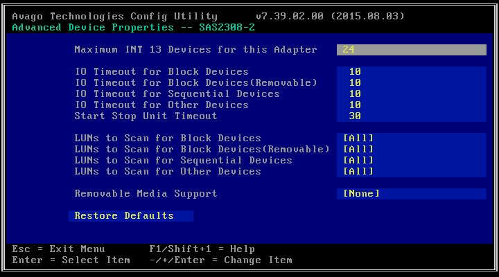

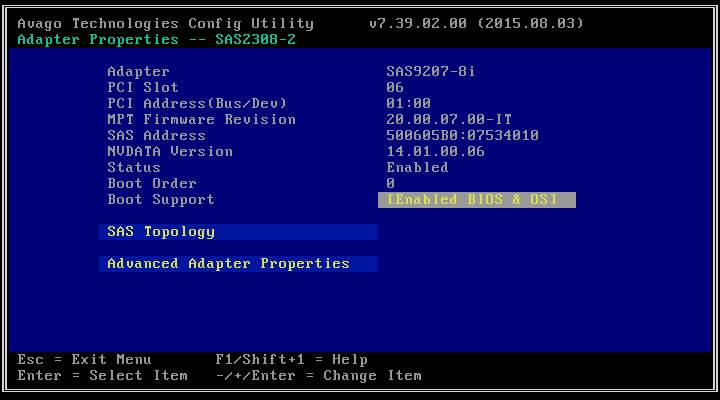

The X11 itself takes a while to go through the boot process, but that's normal as all 3 I have are the same, the LSI takes a few seconds only, my 9207 was on an X9 at the moment but I installed it in an X11 with a single disk connected and caped the video below, also screens for the settings, all set at default:

The only setting not confirmed is the Global Adapter page, which you ALT N to get to.  This is where the Support Interrupt is.  Can you please just check that setting?  If Default, it will say Hook Interrupt.

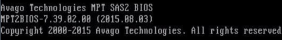

From your video, I see one big difference - firmware and bios, and even the name of the card.
The name of the card is different, mine says LSI and yours says Avago.
Your MPT2BIOS ver is 7.39.02.00
Mine is 7.37.00.00
Your firmware shows 20.00.07.00 IT
Mine is 19.00.00.00 IT
your NVDATA ver  14.01.00.06
mine is 11.00.00.06
I'm thinking the first thing I should try is to update the firmware and bios versions.  From the Broadcom website,
Current version is 7.27.01.01  (4/4/2016)  Yours says 7,39.02.00, yet that one isn't even on their website??
Current firmware is 20.00.07.00 IT  (4/4/2016)  (9207-8i_Package_P20_IR_IT_Firmware_BIOS_for_MSDOS_Windows)  Looks to be the same as yours.
From looking at the firmware upgrade package, it looks like it will update the firmware and bios at the same time, so no need to do bios by itself.  Does that sound correct?
I assume I should disconnect my data drives before updating firmware.  Anything to watch out for when doing this upgrade?
Thanks again!
Yes, update will do both at the same time and you don't need to disconnect the disks.
I'll confirm the other setting tomorrow but it's all default.
Firmware and bios updated on the 9207 to match yours and now mine boots in 10 seconds like yours Johnnie.  Thank you again for the screenshots and help.   It even changed the name from LSI to Avago.
