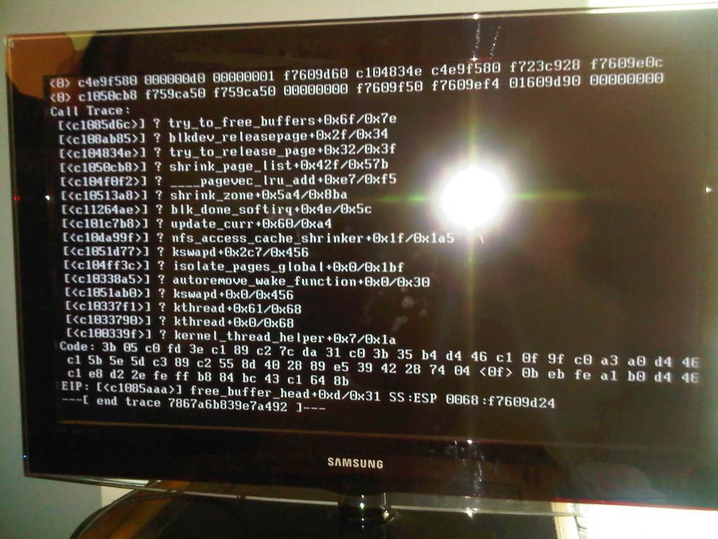

Tried another preclear and it froze up.  So I decided to add the drive to the array to see if it would clear that way.  No such luck it froze almost instantly.  The good news is I was able to capture the last info on the screen with a camera.
I've run a SMART report on the drive in question and its passed.
I've also changed the SATA cable even though it's brand new to see if that could be the problem.
If anyone has any other suggestions I'm open.
