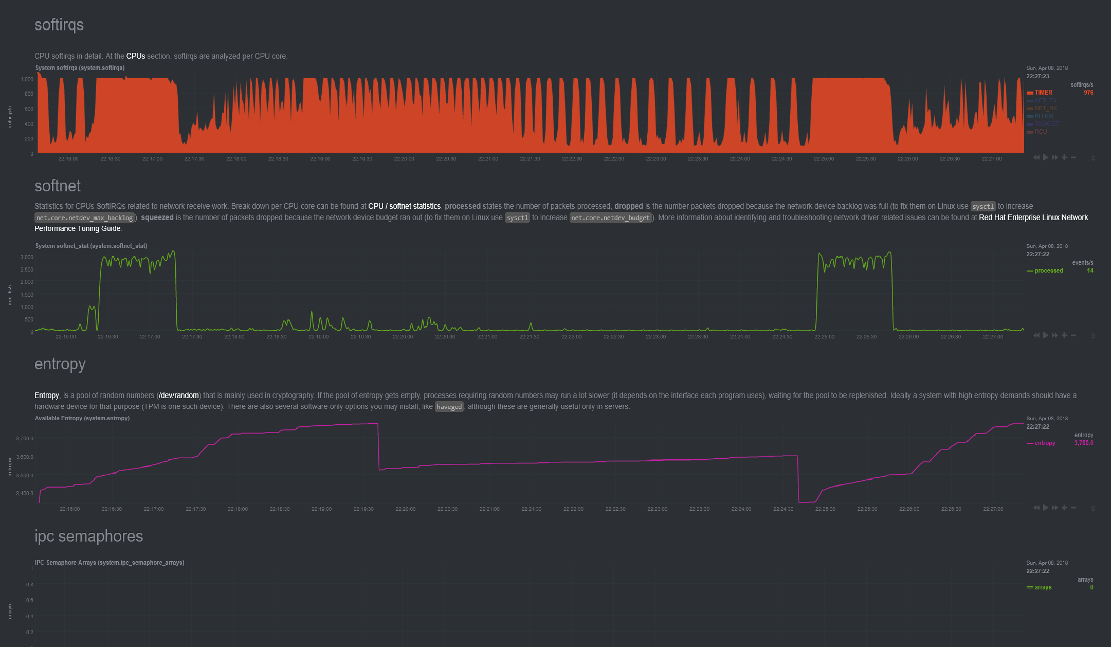

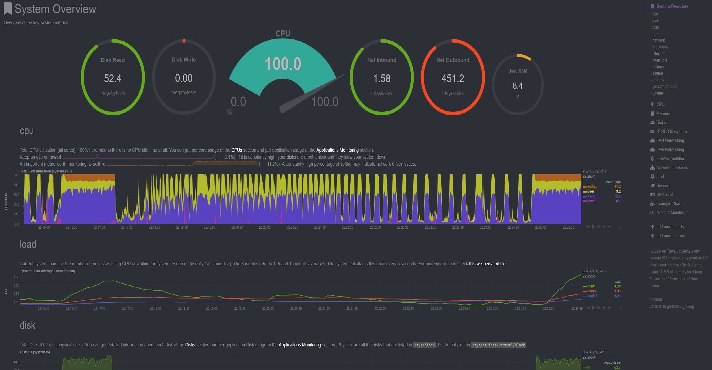

I have Netdata installed and I captured two screenshots for you during receiving a large video file from the server. You can see this "brick" curve on the right. This was a steady 50mbyte/sec copy. Of course the WD Red could reach 100mbyte/sec as far as I know.
mpstat during the copy is showing around 6000/second. According to the article anything over 5000/second is a lot.

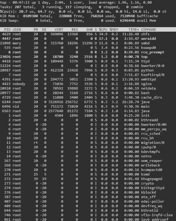

One issue here is that your machine spent 11% on softinterrupts and over 70% on system time. Is it the Samba processes that consumes much of the system time?
While copying this is the output of top:
So lots of time spent by shfs.

Just tried. It doesn't get better. Copy speed is now inconsistent (going below but also over 50mb/sec) and shfs has even higher %CPU.
I noticed that actually the higher the copy speed goes, the higher the %CPU of shfs is.
Also the write (to Array) speed is faster (70mb/sec) than the read speed (50mb/sec). Test on the same file.
Edited by nid
That's expected, since it needs to deliver more MB of file data / second.
With 100% CPU, your machine hits the limits. So the only way to get more speed is to find tweaks that makes some of the operations consume less CPU. I have never compared if the tweaks I posted affects the CPU load of shfs since I haven't had any unRAID machine reach 100% on copy. The parameters are mostly posted for people who needs to get more speed out of the drives.
