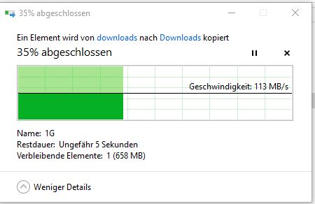

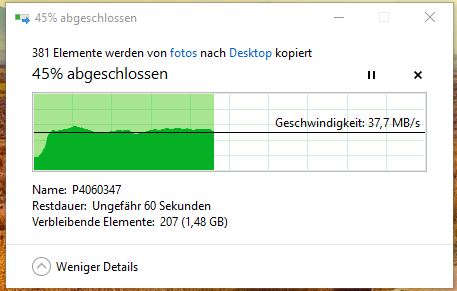

- The best reading transfer rate from the array is around 50 MB/s. Small file have 35MB/s. Large files 50MB/s
From Cache Disk full 100 MB/s.
I expected also 100 MB/s from the array.

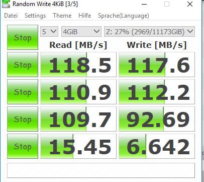

Now it's getting more weird. I made a CrystalDiskMark via mounted Network Volume (no cached share) and the results seems to be okay.
So there shouldn't be a transfer issue with my harddrives. But where is the bottleneck?
It can't be the Samba protocol or the network, because my cache disk is very fast via samba network. (FTP has the same transfer rates).
Why do I have just a maximum of 50MB's transfer speed instead of 100?
Please find the attached screenshots.

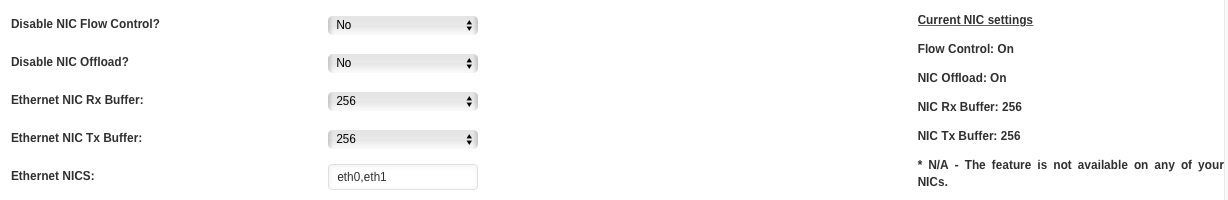

Next I restarted the server and after that again the same sloppiness. Slow and unstable, from 10 to 50 mbytes/sec any direction. Flow Control status remained off. NIC Offload status remained on. So those two NIC settings survived the reboot, at least according to the Tips and Tweaks report. Strangely this time iperf3 shows good results (close to gigabit). But copies are more or less suffering the same as before.
Re-enabled Disable NIC Flow Control and of course Flow Control status remained off but after that I have stable read from the server at about 47mbyte/sec and write to server at about 60-70 mbyte/sec. All these values are by using different random large files to both directions.
I hoped there was an easy pattern to this but now I lost it...
FWIW for my Intel NICs (e1000e driver) I have in Tips and Tweaks:
Ok the difference is that no matter if set to On or Off the status of Flow Control on mine stays always Off.
One other difference is that I'm running unRAID 6.5.1-rc3. I don't know if it will make a difference but you might want to try it.

The network card itself is the biggest factor - the amount of hardware acceleration the card can manage greatly affects how much work the CPU will have to do.
A gbit network card has to handle a huge number of packets/second. A full gbit/s transfer would mean around 75000 packets/second. This is an extreme load for the CPU. One improvement the card can help with is something called Interrupt Coalescing - the card waits until it has multiple packets received or until there is a pause in the transfer before issuing an interrupt. This saves a lot of CPU resources because the CPU can then pick up multiple packets at the same time. Better cards can also compute the packet checksums in hardware.
So if the CPU is weak, then it might help to install a better network card.
There's an article about overloading low powered CPUs with IRQs here. If you want to try the mpstat command yourself and have the Nerd Pack plugin installed it's included in the sysstat package. It would be interesting to know which NIC chipsets put the lowest load on CPU resources.
