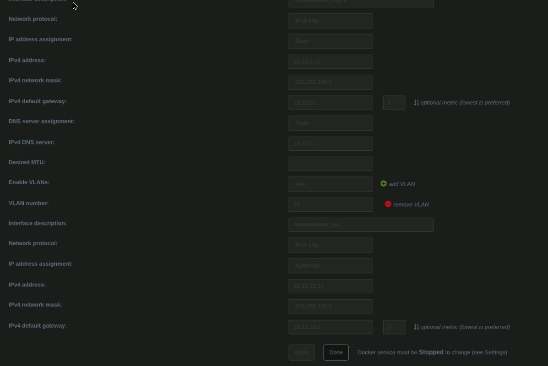

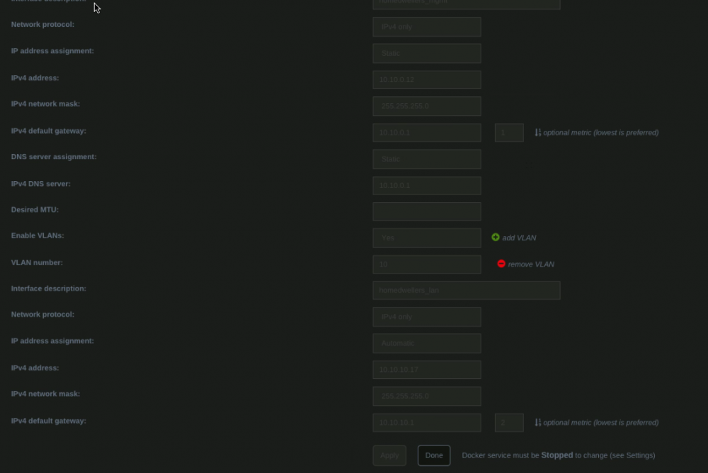

Should this work if you have an additional VLAN tagged? I see Br0 and Br0.10 in a ifconfig, have re-started docker services thru the GUI and I don't get the custom option.
When br0 and br0.10 both have an IP address assigned, they should appear in the list of custom networks for Docker.

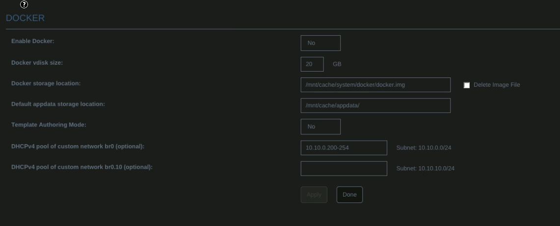

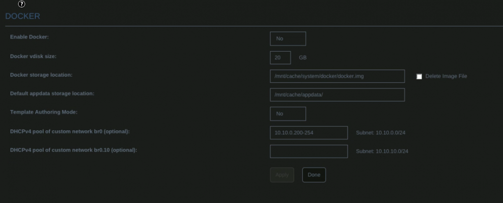

In your third screenshot, I believe the pool needs to be in CIDR format, not a range of ips
Sent from my ONEPLUS A3000 using Tapatalk
4 minutes ago, ljm42 said:
In your third screenshot, the pool needs to be in CIDR format, not a range of ips
Very sharp observation :)
Correct syntax is: 10.10.0.192/26
The above reserves 10.10.0.192 to 10.10.0.254
Ps. Maybe I should add some syntax checking?
Edited by bonienl
:) maybe also adding the keyword CIDR to the interface or help text to give a jump-start on what to Google for
Ah, that makes sense. Syntax checking is probably a good idea. It makes sense with your example to the right, I just didn't add 1 + 1.

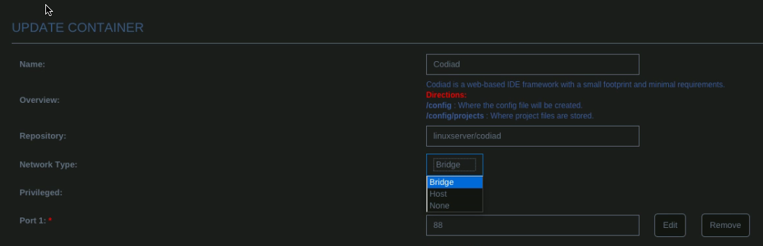

Sadly, still no custom option.

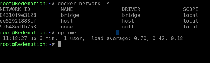

What is the output of
docker network ls
Hmm, it didn't create the custom networks.
Can you reboot your server and check again?

Did you change your network settings somewhere in the process, e.g. added bridging later or removed bonding?
There is no possibility to tell docker to remove the old assignment (at least I couldn't find it). The workaround is to completely delete the docker image and recreate it, plus re-installing the containers
It happened when I added the VLAN to an existing bridge. I'll see if I can recreate it. Rebuilding isn't that bad.

Perhaps you want to test this in two steps.
First create br0 only and check if it works
Second add the VLAN interface and check again

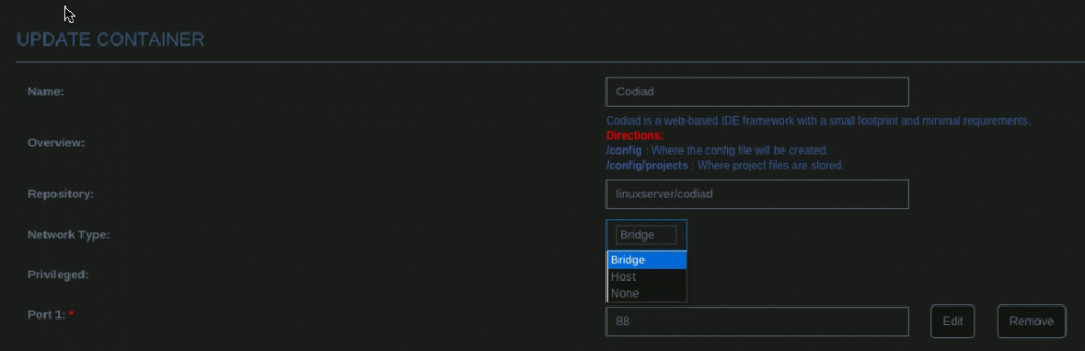

Test 1 (no changes to vlans)
  1. recreated docker image
  2. added container
  3. able to chose br0
    1. br0.10 does not show in dropdown
    2. when attempting to add DHCP pool, able to type in information, but hitting apply clears out field
Test 2 (deleting and recreating vlans)
  1. Delete docker image
  2. removed all vlans
  3. recreated docker image
  4. able to chose br0
  5. added vlan on br0.10
  6. able to chose br0
Edited by smdion

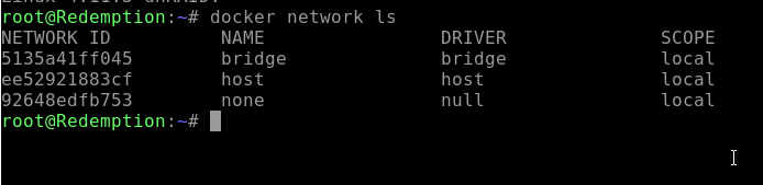

After Test 2:
docker network ls
NETWORK ID          NAME                DRIVER              SCOPE
bf9cb0b23d8e        br0                 macvlan             local
a6ce9d49136e        bridge              bridge              local
dfcda7660adb        host                host                local
95ce9e830426        none                null                local
note (br0.10 exists in unRAID ifconfig)

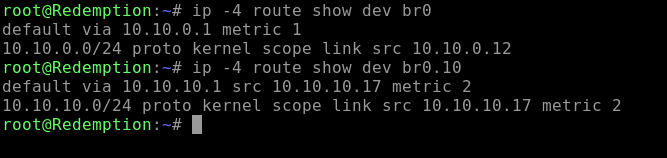

root@Redemption:/mnt/cache/system/docker# ip -4 route show dev br0
default via 10.10.0.1 metric 1
10.10.0.0/24 proto kernel scope link src 10.10.0.12
root@Redemption:/mnt/cache/system/docker# ip -4 route show dev br0.10
default via 10.10.10.1 metric 2
10.10.10.0/24 proto kernel scope link src 10.10.10.191
(IP addy changed on br0.10 due to DHCP scope change on subnet)

Did a quick test and added VLAN 10. Have the same result as you. The network "none" is added. VLAN is not added. Obviously a bug o.O
Edited by bonienl
I'm going to try to break mine again tonight, probably not a bad idea to add an error in the GUI when it can't create the network?
The addition of the VLAN caused a code error in the script which does the creation of the custom networks and is called upon starting the docker service. That part is now corrected.
Will add syntax checking too.
