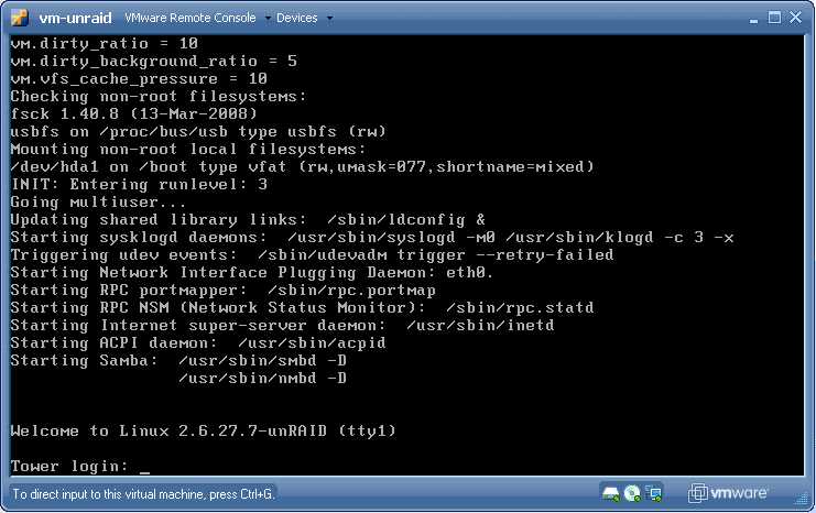

Hi. I've created a virtualised VM under VMware Server of the unraid OS, and it boots fine, the only thing is, I've got no Eth0 up and running. The only line that I can see wrong when it starts up is below:
Triggering udev events:  /sbin/udevadm trigger --retry-failed
I basically did the following below to create it:
1). Created a Virtual Machine using the 'Other Linux 32bit' option.
2). Allocate 512MB RAM.
3). Created a IDE-based disk controller and disk, 1GB IDE disk.
4). I allocated the actual CDROM BartPE CD, formatted the 1GB vdisk as FAT16 and labeled 'UNRAID'.
5). Booted into Bart PE, mapped a network drive, run 'syslinux.exe -maf C:' to make the 1GB vdisk bootable and to extracted and copied over the unraid OS files and config folder onto the vdisk.
6). When I start my Virtual Machine unraid server, it seems to boot up as per normal, but without networking.
I've emulated the NIC as Bridged, NAT and Local Only, all rendering the same result.
See attached screen shot and syslog.txt for information.
Any ideas? Thanks.
syslog.txt

It seems I'm having very little success with getting the unRAID OS to running under a virtualised environment. I've tried as earlier stated VMware ESXi Server v3.5.0 and I've recently used VMware Server for Windows v2.0.1, VirtualBox v3.1.6 and Virtual PC 2007, all of which are resulting with no network support. I've noticed that all of the VM's I've created (except for VMware ESXi which wasn't seeing the formatted FAT16/32 partition label as 'UNRAID') resulted in this line below:
Starting Network Interface Plugging Daemon: eth0
which to my understandings seems like the network interface eth0 is becoming/has become active, but when I issue a 'ifconfig /all' command, I only get the 'lo' interface and no 'eth0'. When I issue the 'ifconfig eth0' command, I obviously get the following:
eth0: error fetching interface information: Device not found
