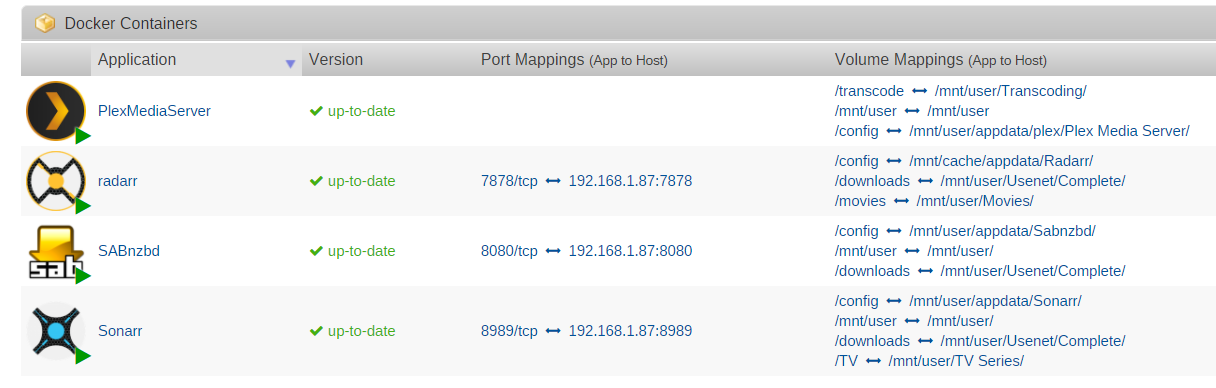

The last little issue I've been having now is with Radarr and Sonarr. I can't get them to do "Complete Download Handling" correctly. They only way I've gotten radarr or sonarr to process newly downloaded movies is through the Drone folder (which is apparently not recommended now). They're both giving me the same error. "Import failed, path does not exist or is not accessible by Radarr/Sonarr"
I'm thinking this is the permission issue you were mentioning that I might run into, Squid.
Any idea what I do to fix this, keeping in mind that I'm pretty noobish. :)
Sweet thanks for pointing me to that post. So this should work now?
Except that I just noticed that Radarr's config file is set to /mnt/cache/appdata/ and all the other config files are set to /mnt/user/appdata/.  Which is technically the same location since the appdata folder is set to prefer cache. But when I change Radarr's config to /mnt/user/appdata/ all the settings and data disappear. Which I find a little odd.
Switching between user and cache for appdata that can happen. Unforutunate but not unexpected. Where config is pointed at has no bearing on your issue.

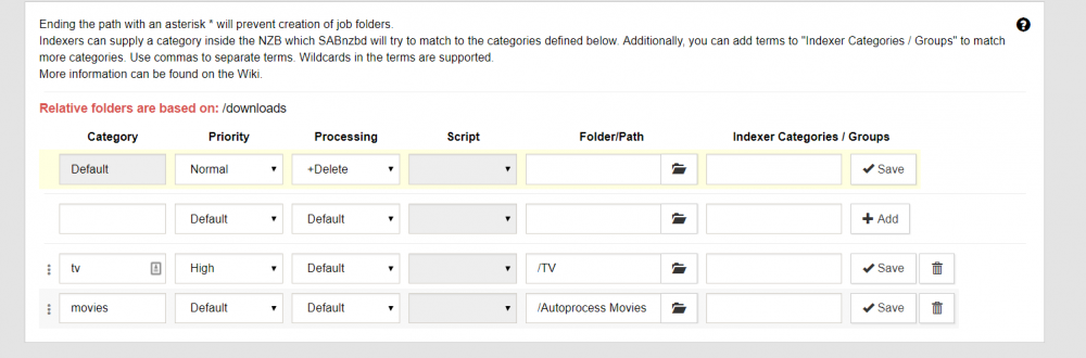

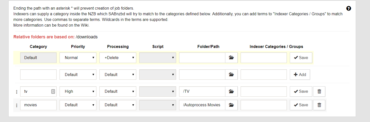

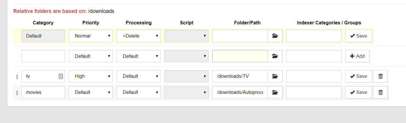

I think I just figured it out. Here were my settings for the categories I'm sorting TV and movies to.
2017-07-01_21-06-29.thumb.png.72bceae4151fb25e1c2e8eb98712f7c5.png\
Just now deleted the /downloads/ from both of them.
Fingers crossed!

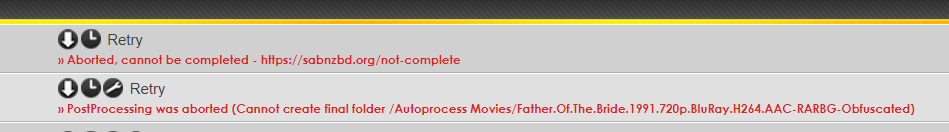

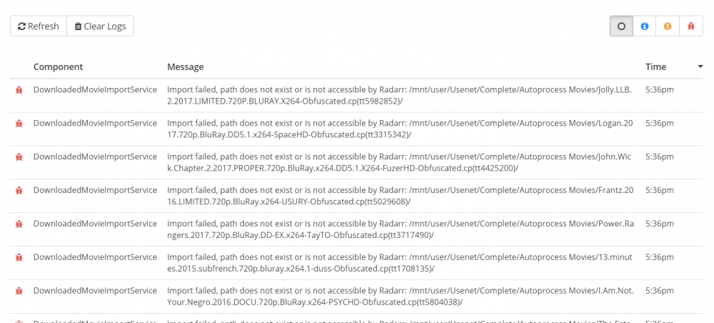

Ok, so I'm narrowing in on things I think. There have been fewer errors in the logs since I updated that. But now I'm getting these two errors frequently. I have a feeling that the first one (which is a TV show) is just an error with the nzb? But the second one seems like the permissions aren't allowing it to create a folder where it needs to?
What do you think?
15 minutes ago, cypres0099 said:
What do you think?
Certainly looks like permissions.  But I also think that people should use nzbGet instead of sabNZBD.  And the error implies that it's trying to create the folder Autoprocess within the docker.img file which is definitely not what you want which leads me to this:

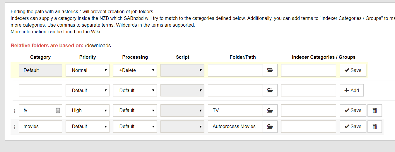

What do you mean by this?  This is how you want it.
This image is how I have it setup now. It says that all folders are relative to "/downloads" so the way I had it before would have made it "/downloads/downloads/Autoprocess Movies/moviefolder"
I'm open to switching to NZBget if you think it would be easier for me to get right.
Edited by cypres0099
Woohooo! I finally got the Complete Download Handling to work for both Radarr and Sonarr. It seems to be a problem with the folder/path like I mentioned above, but I needed to delete the leading / for it to actually be the correct path (see image for final settings that worked).

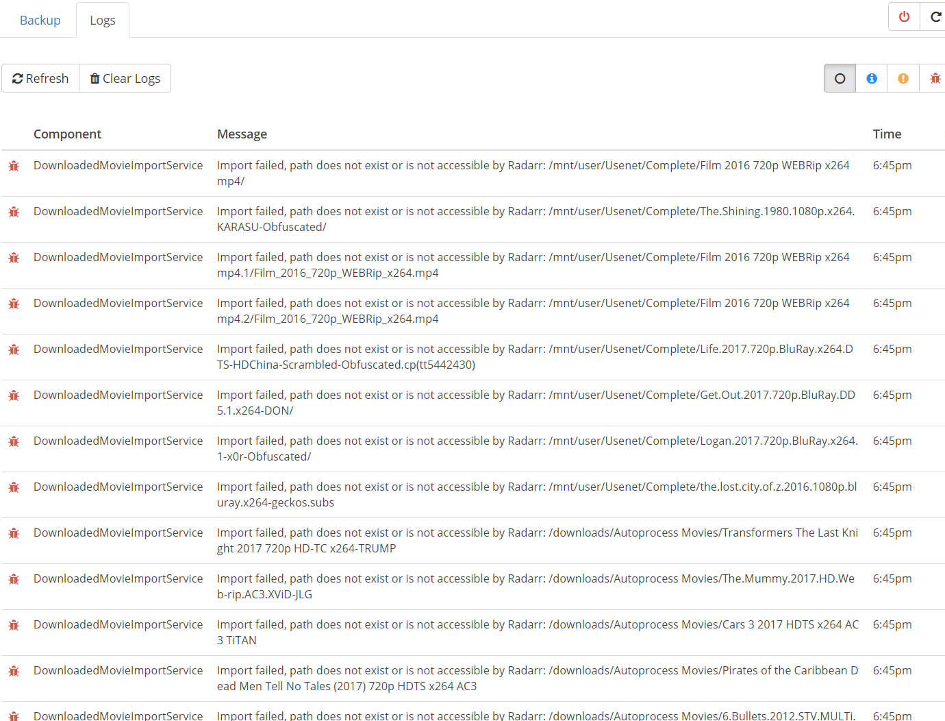

1. When it processed the TV show and Movie to the correct archives where I keep my TV and Movies, it seemed to copy it over rather than just point it to the new folder (not sure I'm using the right terminology). It took like 5 min to unpack, which usually is the longest process. But this time both the movie and TV show took another 10 min to put into the right folder. I navigated to the folders to see what it was doing and it was transferring a file into the folder. It was labeled PAR and kept getting bigger and bigger until it was compete and then there was the movie/tv show. Is there anyway to speed up this process?

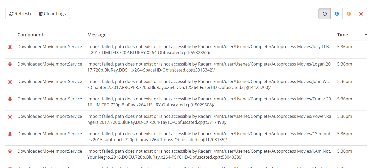

2. Radarr's "DownloadedMovieImpertService" seems to be searching for ALL my movies (even ones that I've already downloaded and are in my main library). See the second image for the errors that it's throwing every time it scans.
Log errors I would guess are a remnant from the original bad setup.  I would clear the logs, delete the movie (but not the media) from radarr and then re-add it as an existing movie if you want.  (Or switch them to not be monitored anymore)
