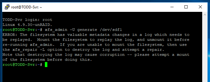

July 7, 20179 yr Community Expert If you rebooted since confirm that the SSD is still sdf and type on the console:xfs_admin -U generate /dev/sdf1
July 7, 20179 yr Author 5 hours ago, johnnie.black said: If you rebooted since confirm that the SSD is still sdf and type on the console: xfs_admin -U generate /dev/sdf1 See below error report
July 7, 20179 yr Community Expert See if it mounts, if it doesn't you'll need to use xfx_repair with -L, to try and mount it before changing the UUID you need to do use the UD plugin with the array stopped so the other disk with the same UUID is not mounted.
July 7, 20179 yr Author 5 hours ago, johnnie.black said: See if it mounts, if it doesn't you'll need to use xfx_repair with -L, to try and mount it before changing the UUID you need to do use the UD plugin with the array stopped so the other disk with the same UUID is not mounted. Please confirm these steps: Stop the array Try to mount the drive. Assuming it does mount, then go back and use the command: xfs_admin -U generate /dev/sdf1 Do I unmount the drive before using the -U generate command? If it doesn't mount, then use the command xfs_repair -L /dev/sdf1. Then do I have to go use the -U generate command over again after this? Is there a chance I could lose the contents of the drive at this point? After I get the SSD SDF to mount, then go restart the array. Edited July 7, 20179 yr by TODDLT
July 7, 20179 yr Community Expert Just now, TODDLT said: Assuming it does mount, then go back and use the command: xfs_admin -U generate /dev/sdf1 Yes, mount, unmount and run the command. 1 minute ago, TODDLT said: If it doesn't mount, then use the command xfs_repair -L /dev/sdf1. Then do I have to go use the -U generate command over again after this? Yes 1 minute ago, TODDLT said: Is there a chance I could lose the contents of the drive at this point? There's always a chance, but usually there's no data loss. 2 minutes ago, TODDLT said: After I get the SSD SDF to mount, then go restart the array. After changing the UUID.

July 7, 20179 yr Author 3 hours ago, johnnie.black said: Yes, mount, unmount and run the command. Yes There's always a chance, but usually there's no data loss. After changing the UUID. HEY! mounted and working now. Thanks!! I'll run the comparison and see what if anything shows up. I think I'm down to 32 "changed" files and most of those I can identify having made the changes too. I'm still not sure what caused the 5 parity check errors or caused the SSD to fail 2 days later. Thanks for sticking with me on this. Don't quite write me off as solved yet, and I will confirm back, hopefully later tonight.
