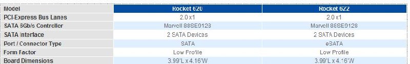

One of the cards I'm looking at is this HighPoint 620 or the 622.
http://www.newegg.com/Product/Product.aspx?Item=N82E16816115072&cm_sp=DailyDeal-_-16-115-072-_-Product
http://www.newegg.com/Product/Product.aspx?Item=N82E16816115073
http://www.highpoint-tech.com/USA_new/series_r600.htm
