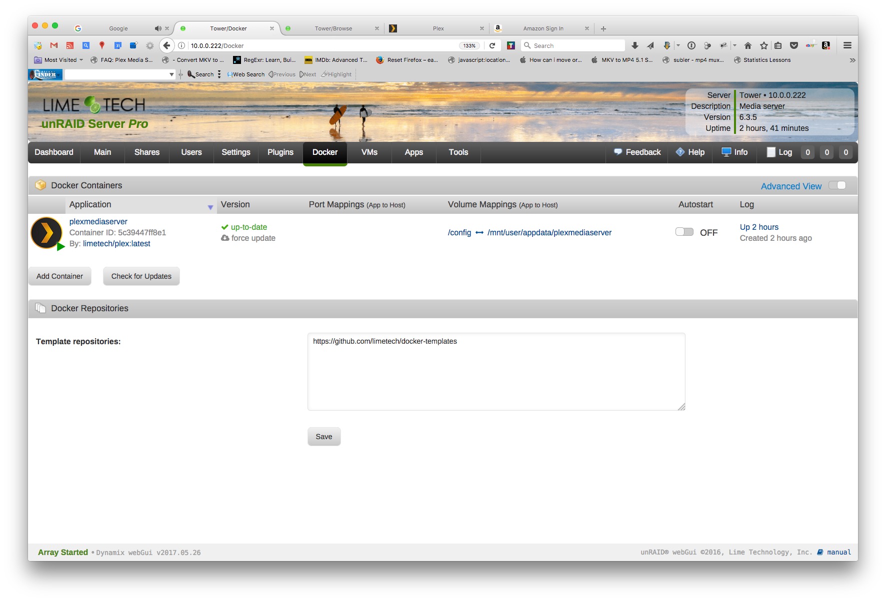

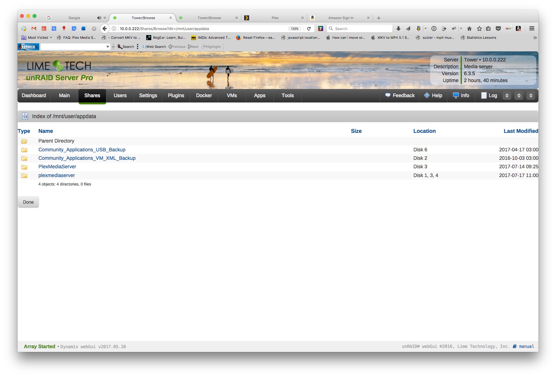

ongoing (i never thought replacing a flash drive would have so many consequences :$ )...  So, I restored PLEX and after scanning my drives for about an hour, it came back with my existing library.  However, two new movies I had added after my flash drive crash are not being recognized in the library (after forcing a library update, of course).  Furthermore, I can't play ANY of my existing movies and tv shows, etc. because PLEX can't seem to find the files (files are "Unavailable" when I Get Info on a movie).  my docker page looks like this (attached).  I think there might be a conflict here with the file path of "plexmediaserver" (as I originally created it, apparently, and as I recreated the host path upon resurrecting Plex, thinking I would get back my library) and the default of PlexMediaServer.  Perhaps there is something I can do to merge these two (screenshot attached)?

You don't have any media locations specified in your Plex docker config.
EG
/movies = /mnt/user/movies
/music = /mnt/user/music

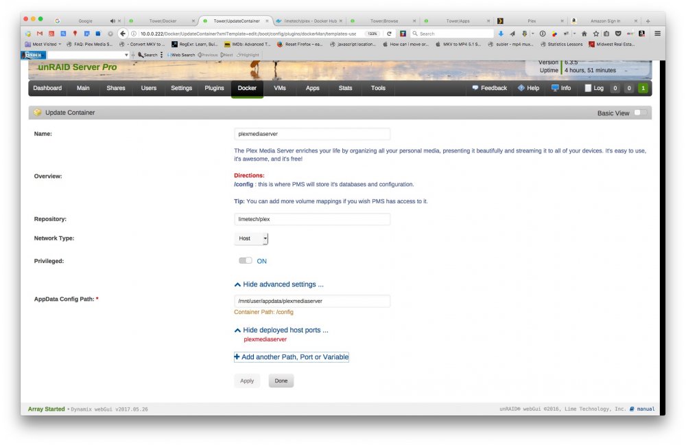

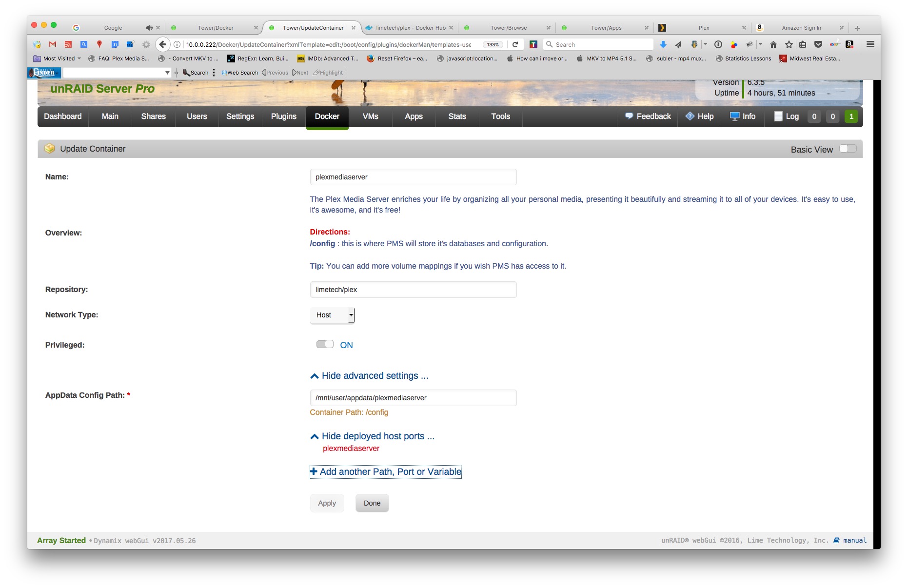

I can't seem to get to the page where I see volume mappings (for music, movies, etc.)?  The settings seem a bit different than when I first installed PLEX.  Should I be on this page (attached screenshot) and go to Add another Path....?   thanks.
yes

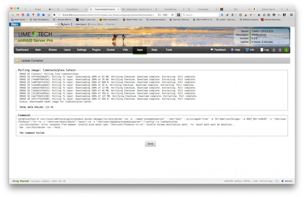

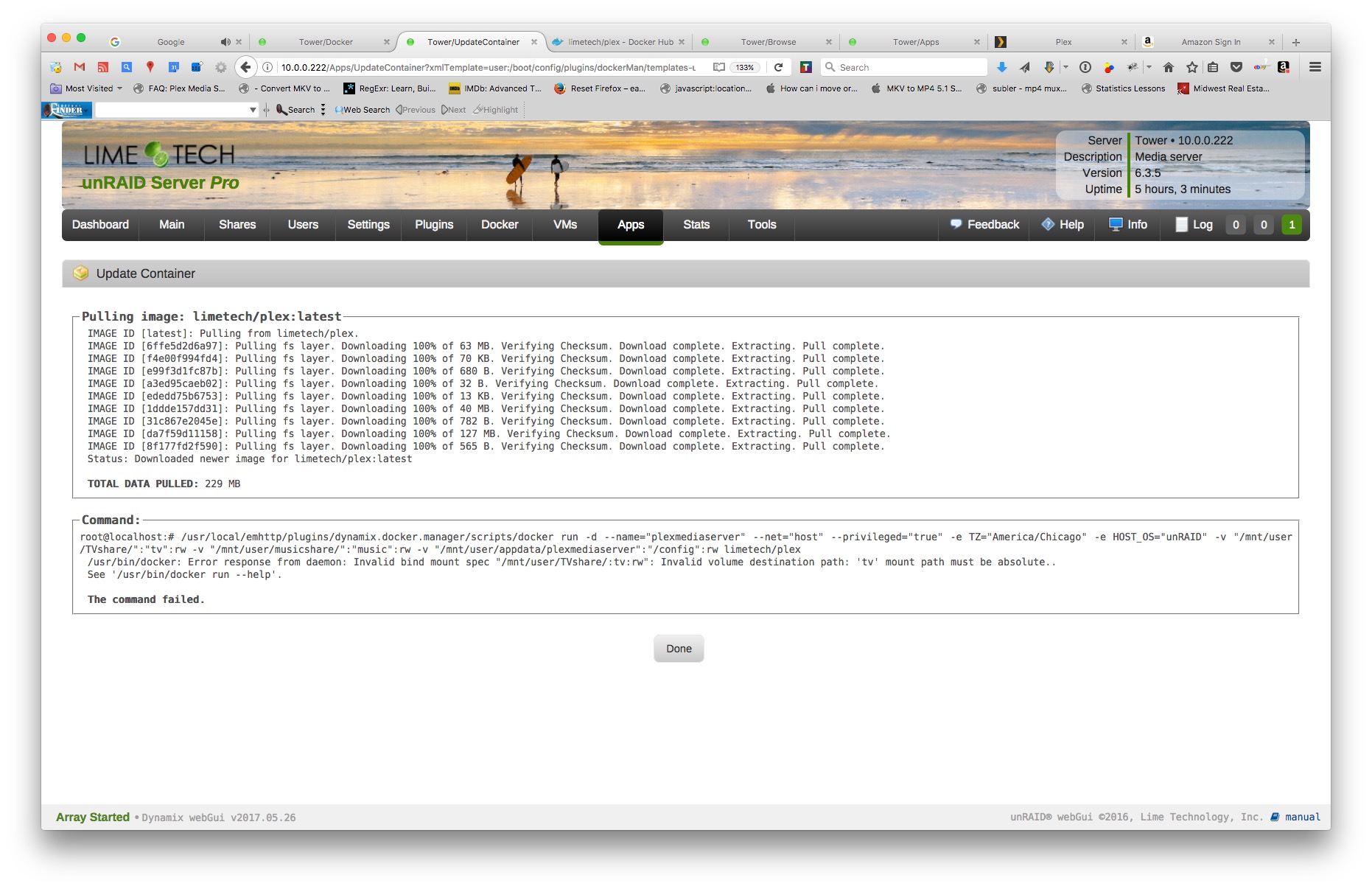

apparently my install fails... see attached
you forgot the / on /tv
