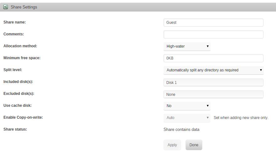

The min available setting is completely ignored if the split level dictates what drive will be used. So if you are storing TV shows, and have a directory for each TV show, and the split level says that the TV Show folders can't be split, then unRAID will continue to try copy every file for that TV show to that disk, even if the disk space is well below min free. And if the copy fails, it will not try to copy it to a different disk. Also, unRAID will NEVER split a file, with part of one disk and part on another.
Now if a NEW TV show is added, unRAID will place that new TV show folder on a different disk that meets the min free requirement at that moment. But once it the folder is there, the min free is ignored and all seasons and episodes for that show will be sent to that disk. (See link below for more info on how to use this to your advantage)
If you set the split level one higher, now each TV show SEASON will stay on one disk, and when there is a new season, the min free will again be used to determine on which drive to place that Season. That's what the split levels are for - to try to maintain some order to your user shares and keep related files together.
Used to be movies were split into multiple physical files (e.g., DVD rips). After part1 finished playing, part2 would start. The person watching should not notice as the media player quick switches from one to the next. But if part1 was on one disk, and part2 were on a different disk, and the disk containing part2 was spun down, you get a lengthy pause while the disk spins up before part2 starts. This was ultra-annoying, and part of the history of things like split level and high water which are ways to try to keep logical parts together.
For many of my shares, I put them on one disk and leave them that way. They'll never get bigger than a few gig, and I'd just as soon they stay put. My screen shot for "Guest" is exactly that type of share, confined to disk1. But some of my shares are large, and I'll carefully tune the split level with my folder structure to keep the files I want together together.
Other people prefer to let unRAID manage the space, and just set all their shares to use all their disks and let the files wind up where they will. It is not common today to be watching DVD rips - most media files are just single large files which have to be on a single disk. And high water mark helps keep related files together if you are copying all data to a folder at one time.
Each user's method depends on how OCD they are. :) But understanding the whys and wherefores early will help people avoid having files inappropriately spread hither and yon and trying to correct it later.
