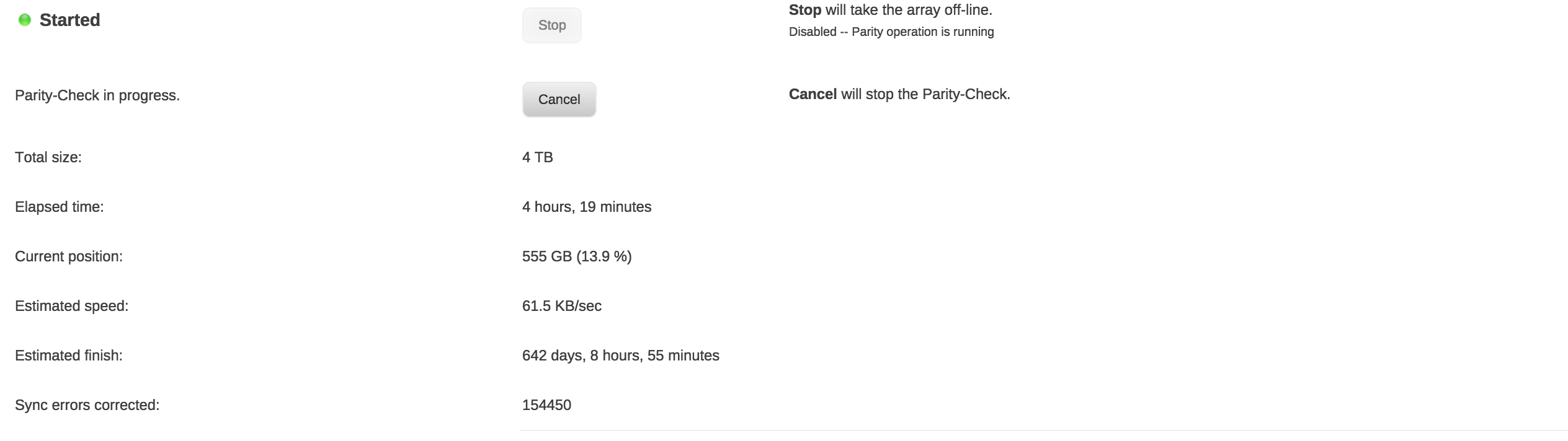

July 21, 20179 yr Just changed one of the disks that failed. After a couple of hours I started the parity check this is what I have.... Any suggestion??? Thanks
July 21, 20179 yr Community Expert Since it's correcting a large number of sync errors it's normal to slow down a lot, are so many sync errors expected?
July 21, 20179 yr Community Expert 1 hour ago, gideva said: Just changed one of the disks that failed. After a couple of hours I started the parity check this is what I have.... Why are you doing a parity check instead of a data rebuild? Post your diagnostics.
July 21, 20179 yr 2 hours ago, gideva said: Just changed one of the disks that failed. After a couple of hours I started the parity check this is what I have.... Any suggestion??? Thanks How did you change the disk? A disk rebuild? Assuming yes, I am not sure why you'd have sync errors. Did the rebuild proceed at normal speed? If so, that would be a good sign. Did you open the case AFTER the rebuild? Looking at the number of sync errors 154,000+. Sounds like a lot but isn't for 550G of processed space. Each block I think is 8 sectors (4K). so 154000 is only 600M. Way less than 550G! About 0.1%. So most of the disk is verifying, but some is not. The fact it is so slow is not due to the sync errors. There are too few of them to slow it down that much. Even if every block were bad, it would not be this slow. So either the rebuild went flawlessly and now there is some connectivity / HBA issue that is causing performance and data accuracy issues. Or the rebuild was suffering the same issues and we are seeing its continuation into the parity check. Parity is being updated to match the rebuilt disk. Probably a bad thing. Stop this, answer my questions, and post a diagnostic file.
