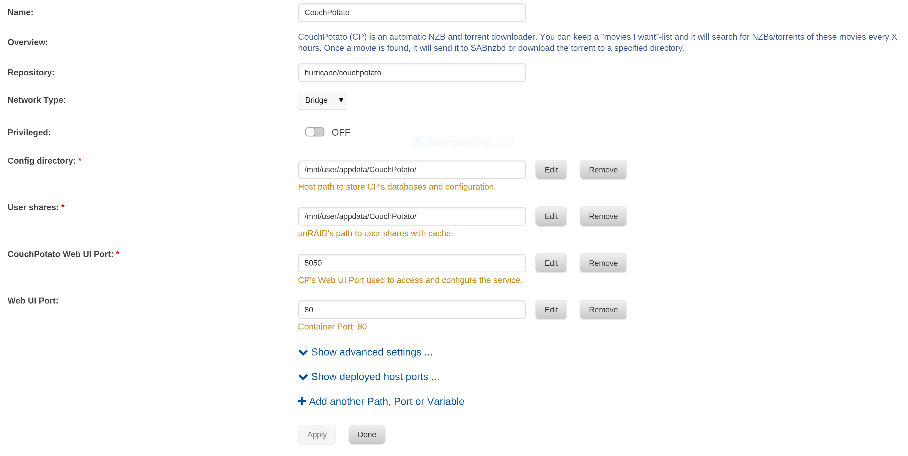

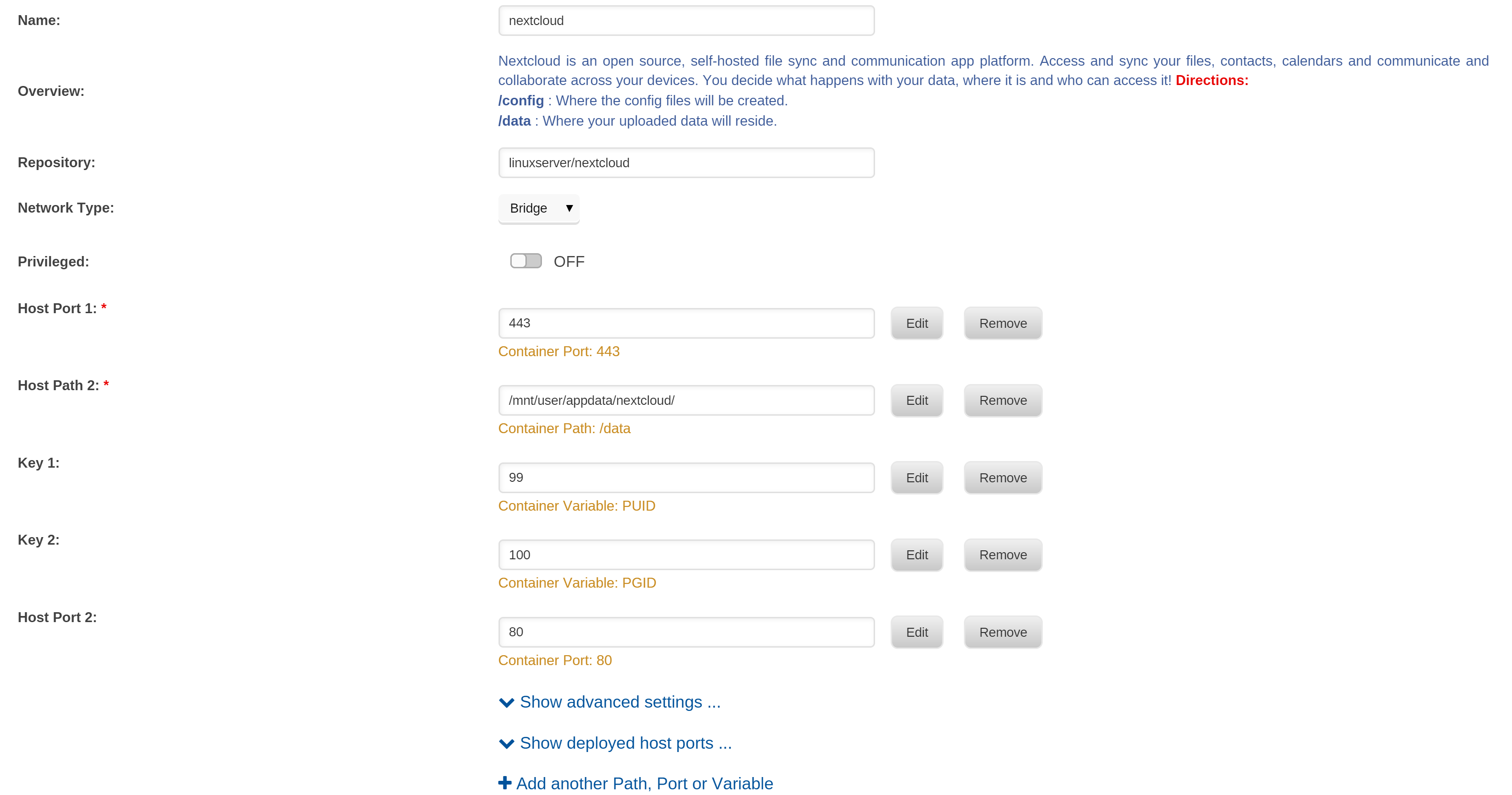

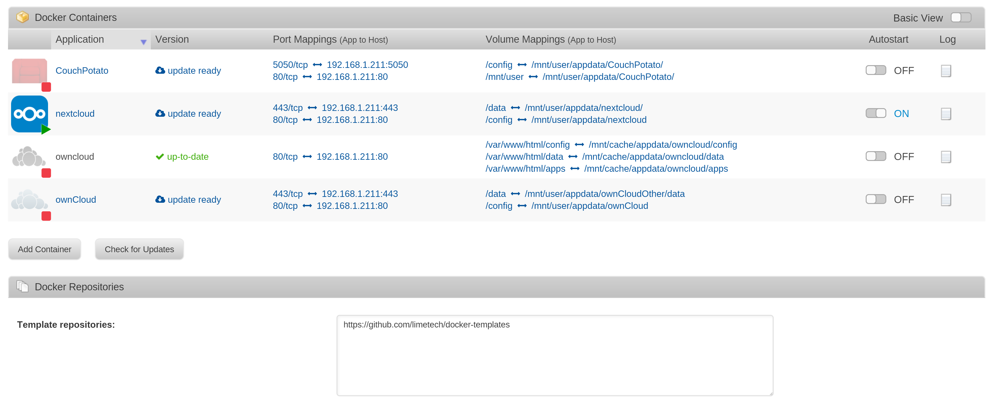

August 17, 20179 yr Author Sorry for the delay. I have linked my diagnostics and photos of my dockers for Nextcloud and Couchpotato. When I disable the docker in settings and type in http://192.168.1.10 then the browser says no DNS address was found. But when the docker is enable then it takes me to https://_ when nextcloud is stopped and couchpotato is running or vice versa. When both are stopped then it states no DNS address was found. diagnostics-20170817-1438.zip
August 17, 20179 yr You can't run both containers at the same time as you can't have two webservers running on port 80 If you go to http://...... when neither container is running then you will get an error as there is no webserver running to respond to a request on http which is on port 80 Neither of the containers are running on the ip you're typing in which is http://192.168.1.10 The ip is http://192.168.1.211 I'm not intending to be rude here, so please don't take it so, but have you any experience with web/network setup, at the moment all I can see is a lot of poor configuration. I have no idea why you want to run couchpotato on port 80 or Nextcloud on port 80 for that matter.
August 17, 20179 yr Author I have very little experience with network setups. I do type in http://192.168.1.211 to try and access nextcloud. I was just using http://192.168.1.10 as an example. I just want it where when I type http://192.168.1.211 it forwards me to https://192.168.1.211. I thought that if I used port 80 for nextcloud then nextcloud would forward me to port 443. But I was probably mistaken. This is how I had it configured on freenas where when I type http://192.168.1.2 it forwards me to https://192.168.1.2 where nextcloud was. When I run nextcloud I stop all of the other containers. Originally port 80 was only on nextcloud, so when I tried accessing nextcloud from http://192.168.1.211 it took me to https://_. Then I wanted to try a different docker so I downloaded couchpotato and turned off nextcloud and used port 80 in couchpotato to get the same result where it took me to https://_. So I assumed that since the same thing was happening in a different app then it had to do with something in unraid rather than nextcloud.
August 17, 20179 yr Did you configure and setup nextcloud before starting this configuration? The couchpotato webserver runs on 5050, so port 80 will never work for that. Edited August 17, 20179 yr by CHBMB
August 17, 20179 yr Author I originally setup and configured nextcloud on port 443 and it runs on port 443.
