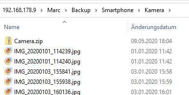

May 9, 20206 yr I have a similar issue. I'm having a share and created a subfolder through its user by an android app. This app is still able to create files inside this subfolder. Now I opened this folder with the same user through Windows and get an network error (Windows can not access ... You do not have permission...). Really strange 🤔 The user rights are looking good as well: And it becomes even more strange. I opened the share through its IP-address instead, entered the credentials, and are now able to open the subfolder without problems 🤪 Seems to be windows related or what do you think? EDIT: Ok, Windows Reboot solved the issue. Ok, thank you Windows 🙄 Edited May 9, 20206 yr by mgutt
May 9, 20206 yr Community Expert I suspect that you have the 'attempt to login twice to the server' problem. It is discussed quite thoroughly in this post: EDIT: If this is not the problem, be sure to read the next several posts to see if one of the other SMB peculiarities are to blame. Edited May 9, 20206 yr by Frank1940
May 9, 20206 yr Community Expert 11 minutes ago, mgutt said: I opened the share through its IP-address instead, entered the credentials, and are now able to open the subfolder without problems 4 minutes ago, Frank1940 said: 'attempt to login twice to the server' problem Yes, going by IP vs servername makes Windows treat it as a different network computer and so different credentials can be used. Even though Windows will sometimes prompt you for a different login because permission is denied, it won't actually use whatever you enter at the prompt since you are already logged in with different credentials. Definitely a Windows quirk, since it treats other systems (even other Windows on the network) in just the same way.
May 9, 20206 yr 16 minutes ago, trurl said: Yes, going by IP vs servername makes Windows treat it as a different network computer and so different credentials can be used. I did not enter different credentials. I used the same. Now, after restarting Windows both clients use the SMB alias again. 25 minutes ago, Frank1940 said: I suspect that you have the 'attempt to login twice to the server' problem. It seems to be something related to this problem. Because the upload process through my smartphone has been interrupted. But I was able to restart the process without problems. The windows client is still able to open the folder and create files inside of it. It sounds like a bug for me. Something like "new login with same user = interrupt existing connection". I never had similar issues with my Synology NAS. Maybe a special setting needed for the SMB server? I'll try to restart the windows client and try to open the network share again while the upload through the Android Client is running. Let's see if it happens again. EDIT: Hmm no. The upload is still running and windows can access and write as usual. Strange. Edited May 9, 20206 yr by mgutt
May 9, 20206 yr Community Expert 2 minutes ago, mgutt said: I did not enter different credentials. Did you enter any credentials at all? If the current Windows username and password will work to access the share, then it won't even ask you to login.

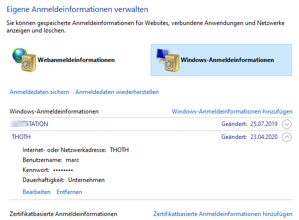

May 9, 20206 yr Just now, trurl said: Did you enter any credentials at all? If the current Windows username and password will work to access the share, then it won't even ask you to login. Yes, I did. My windows login is completley different from the smb share on the Unraid server. My Unraid share username is "marc" and for the smb alias I enabled the checkbox to save this login. As you can see I did not save the login for the IP, too:

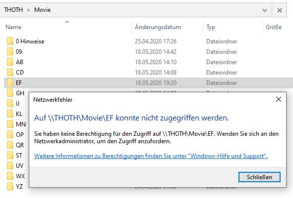

May 19, 20206 yr Is this really related to Windows? I'm able to open any subfolder except of "EF": This happend while Plex (installed through Docker) is playing a movie contained in this specific subfolder: P.S. My user and Plex have only read-only rights in "\Movie".
May 19, 20206 yr Community Expert Do you know how to get to the folder from the Unraid command line and list the contents with their permissions?
May 22, 20206 yr On 5/19/2020 at 4:16 PM, trurl said: Do you know how to get to the folder from the Unraid command line and list the contents with their permissions? I really don't know why but /EF had other permissions:
May 23, 20206 yr Community Expert 5 hours ago, mgutt said: I really don't know why but /EF had other permissions: Those are not the normal permissions for an Unraid system. You normally expect to see the user/group to be nobody/users and not root/root. It sounds as if you copied the files/folders using a tool local to the Unraid server that has not set the standard permissions. Having them set to root/root will stop any access via the network working correctly. The permissions can be corrected by running Tools>>New permissions against the share in question.
May 23, 20206 yr 7 hours ago, itimpi said: It sounds as if you copied the files/folders using a tool local to the Unraid server that has not set the standard permissions. Yes I used rclone to fetch the files from the old NAS through SFTP. I'm not sure, but as I moved a new movie to /EF by using Tiny File Manager, that could be the reason of the permission change. Edited May 23, 20206 yr by mgutt
