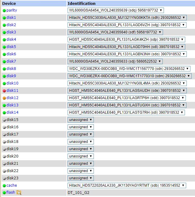

August 18, 20179 yr Running version 5.0.5. Got a red ball on one of my disks (PL1331LAGRTP6H) a week or so ago. Smart report and test came back ok, so figure it was the sata controller or the cable. Moved the drive to a different controller with a different cable and went through the unassign and then reassign the disk procedure to start rebuilding it. A few hours into the rebuild another disk (PL1331LAGSAUDH) red balled which seemed to have halted the rebuild. Unfortunately the smart report shows the drive is failing. I can still access the drive, however the data looks corrupt and I can only see ~12gb of the 3.7tb via samba. So as of now, my array has PL1331LAGRTP6H with an orange ball that was in the middle of rebuilding and now PL1331LAGSAUDH with a red ball that seems screwed. Have a new 6tb drive handy. Have attached smart reports for both drives and a syslog from last reboot. Sorry, should of saved the syslog when the second drive fell over. Currently have the array stopped and it's showing 'configuration valid'. Hope someone can help. Cheers. syslog PL1331LAGRTP6H.txt PL1331LAGSAUDH.txt
August 19, 20179 yr 7 hours ago, philouza said: I can still access the drive, however the data looks corrupt and I can only see ~12gb of the 3.7tb via samba. That is normal since you have 2 invalid disks with single parity, unRAID can't correctly emulate the missing data. Assuming disk12 data is unchanged since it first became disable, you can do this, but it's possible disk12 will have some corruption, though very little, because it stopped during the rebuild: -Utils -> New Config -re-assign all disks, double check parity is the parity slot-check "parity is already valid" before starting the array -start the array Now check if data on disks 11 and 12 looks OK.
