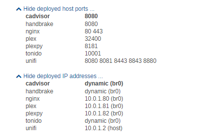

I have all of my containers running on a custom network, except unifi which is configured as host network. I need plexpy (10.0.1.82) to talk to plex (10.0.1.81), which is no problem (make sure plexpy is configured properly).
