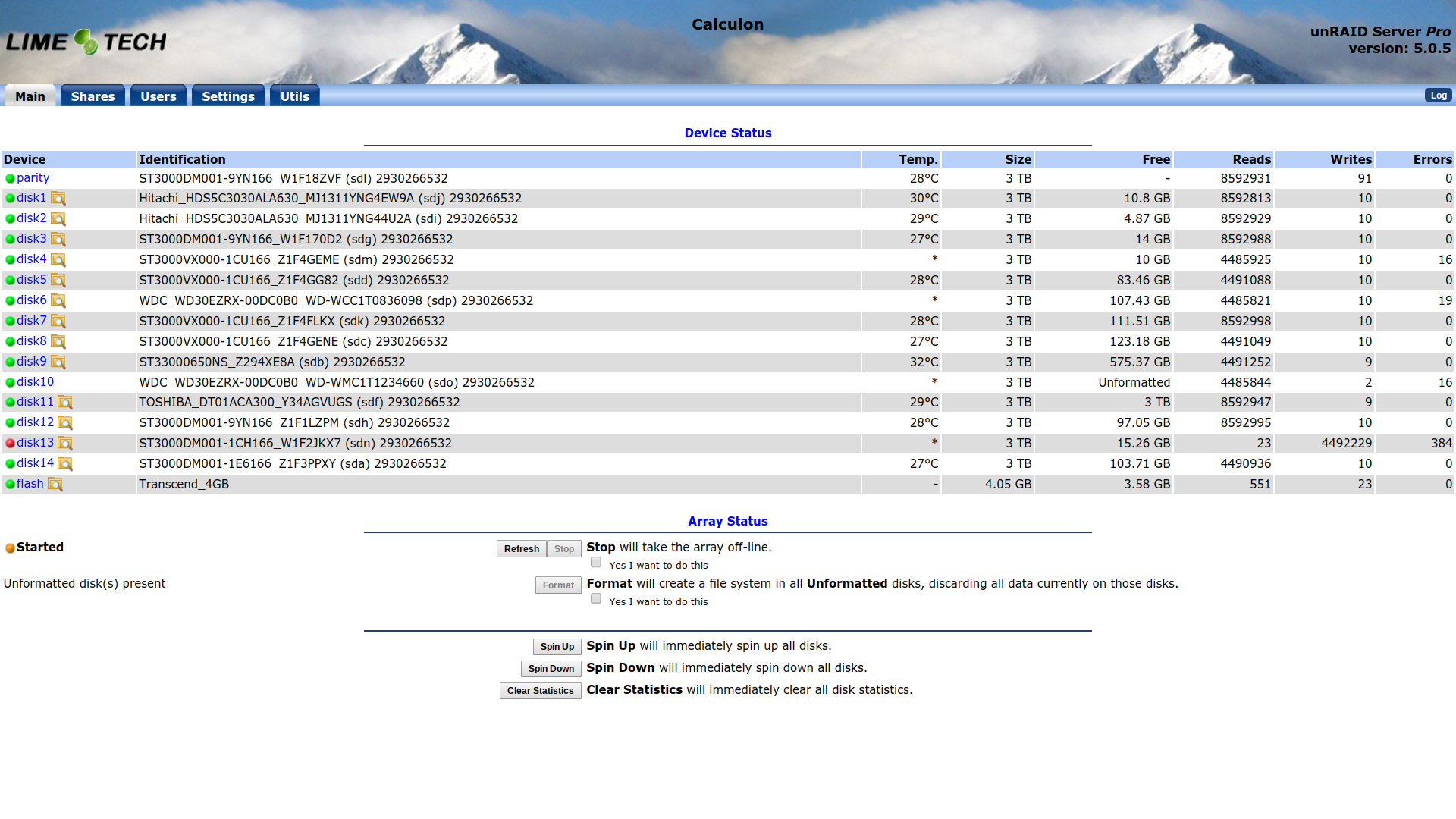

Ok rebuild is complete. It looks like I have disk13 recovered. It looks like there may be corruption as I can't view disk13 it just hangs up and times out eventually. Also I have a lost+found of 4.26 TB on disk 9. Disk10 unformatted and disk11 is 3TB blank. It also appears my shares are broken. Quite a mess all in all. Hmm yes now the console is fast scrolling inode locked errors over and over. Should I stop the array and shut it down?
Edited by dogfluffy
Doesn't look like it is, disk is still disable and reporting errors, there are also errors on disks 4, 6 and 10, very likely a 4 port controller that dropped those 4 disks.

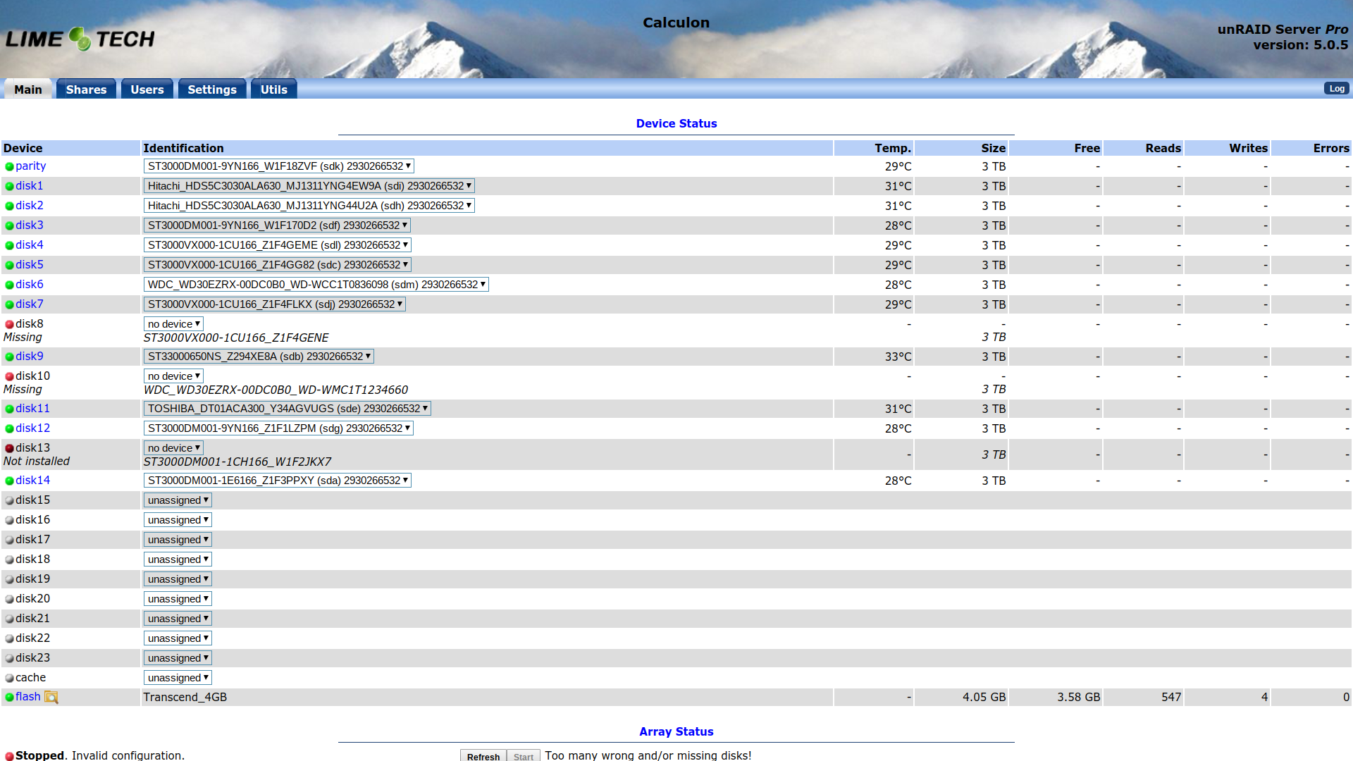

Post a new screenshot while I look over these.
I apologize for the tone of my earlier post. I'm still looking over the files you gave us.
The syslog shows missing disks 8,10 and removed disk 13. I think it considers 13 removed because it is disabled currently.
Of course it won't let you start the array from this point.
Did you change anything that might have made disks 8,10 missing?
