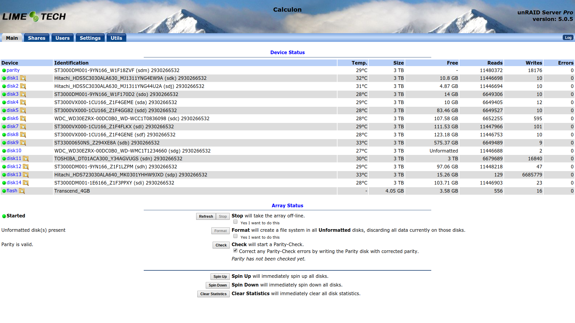

Thanks to advances in modern logistics I'm already back up and running! I still have some housekeeping to do hardware wise to clean all this up, but new drive and controller are installed and running. I assigned the new disk13 and rebuilt last night with 0 errors. So I'm back to the Unformatted Disk10 and an essentially blank Disk11. I'm not sure how to best proceed, but I can start viewing files and trying to piece together what data is missing, and what data I have on previous unraid drives. There was one console message about a reiserfs error on device md10(disk10), probably due to my scan of that disk I gather, but no messages since and no bad noises. Also I forgot about a lost+found on disk9. This is probably the useful bit of info you need?
Feb  4 16:34:20 Calculon logger: mount: /dev/md10: can't read superblock
Feb  4 16:34:20 Calculon emhttp: _shcmd: shcmd (42): exit status: 32 (Other emhttp)
Feb  4 16:34:20 Calculon emhttp: disk10 mount error: 32 (Errors)
Feb  4 16:34:20 Calculon emhttp: shcmd (43): rmdir /mnt/disk10 (Other emhttp)
Feb  4 16:34:20 Calculon emhttp: shcmd (44): mkdir /mnt/disk11 (Routine)
Feb  4 16:34:20 Calculon emhttp: shcmd (45): set -o pipefail ; mount -t reiserfs -o user_xattr,acl,noatime,nodiratime /dev/md11 /mnt/disk11 |$stuff$ logger (Other emhttp)
Feb  4 16:34:20 Calculon kernel: REISERFS error (device md10): vs-13070 reiserfs_read_locked_inode: i/o failure occurred trying to find stat data of [1 2 0x0 SD] (Errors)
Feb  4 16:34:20 Calculon kernel: REISERFS (device md10): Remounting filesystem read-only (Drive related)
Feb  4 16:34:20 Calculon kernel: REISERFS (device md10): Using r5 hash to sort names (Routine)
Do you need any logs or more info from me?
Edited by dogfluffy
