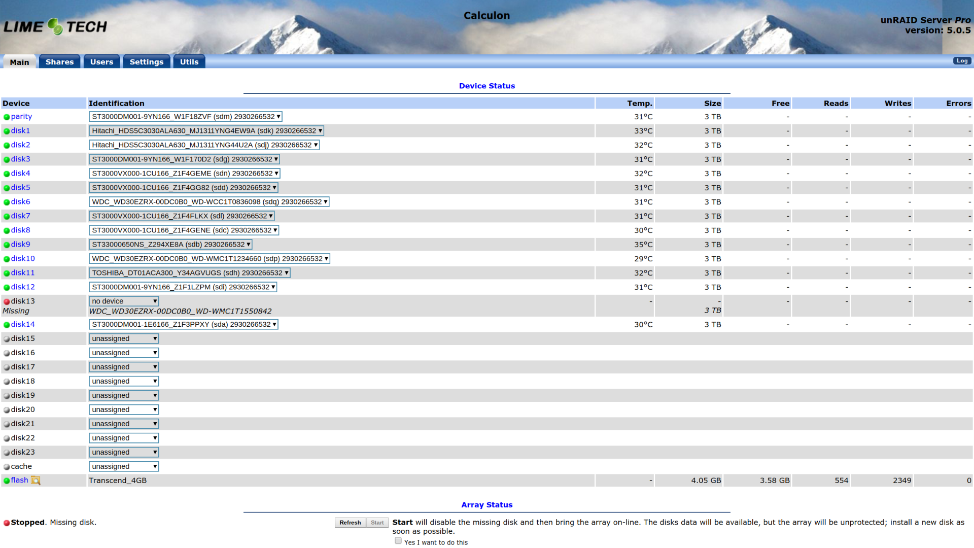

I think we need a better picture of where you are now before making any recommendations. Post a screenshot of Main for starters.

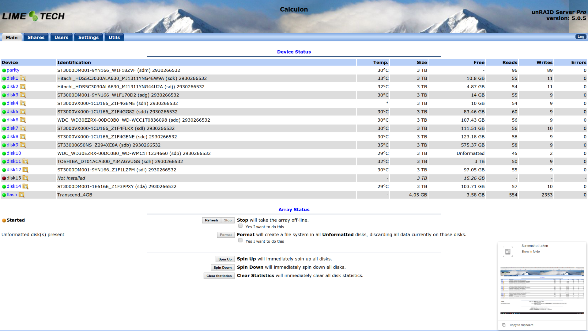

Go ahead and start the array, and post another screenshot after it's started.
You mentioned reiserfsck on sdg1. Your screenshot says sdg is currently disk3, but that is not necessarily always the case. Whichever disk it was, if you did reiserfsck on the md device, then parity would have been maintained, but since you said you did it on sdg1, then I think we have to assume that parity is invalid.
Do you know which disk slot you ran reiserfsck on? Can you tell us more about the unformatted disk10? What about the missing disk13? Which slot was the "original pulled disk"?

I don't really remember V5 well enough. Why does it say disk13 is missing before the array is started, then says it is not installed after the array is started? And everything else is green? If this was V6 I would ask if you can read the contents of the emulated disk13, but the screenshot seems to indicate it is not being emulated.

Emulated disk13 appears to be mounting fine, it shows the free space on the GUI.

I noticed that. The V5 GUI is a bit ambiguous compared to V6. And if he repaired an sd device, parity is likely out-of-sync to some extent, so rebuild of disk13 may be compromised.

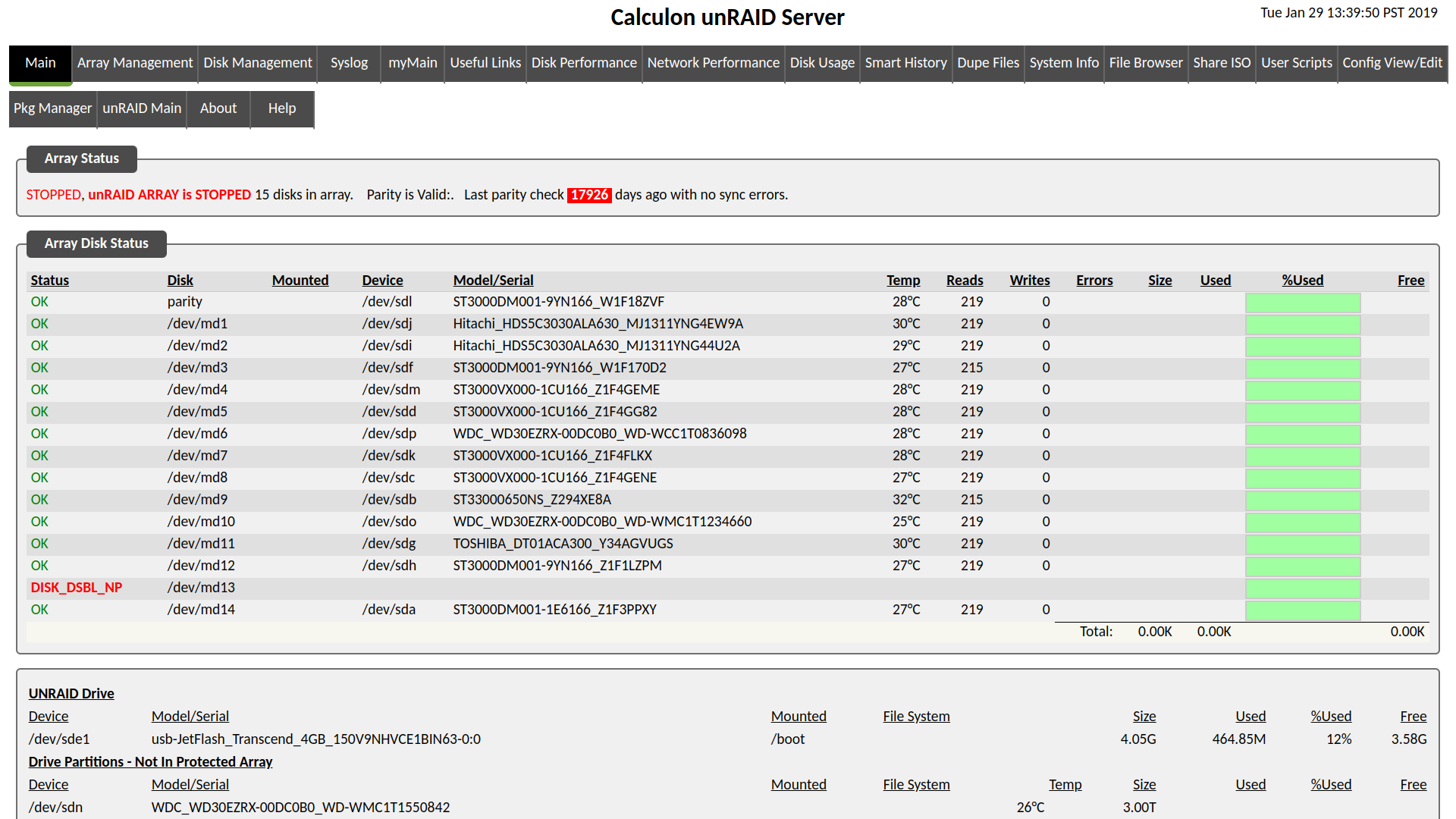

Yeah this project went down the rabbit hole in a hurry. I can't tell what I was trying to do in reverse, and I've forgotten what happened and why exactly. What really caused my problem was a weirdly bad UPS, so when I was getting disk errors I would disconnect and move the server to test on my workbench, everything would pass, connect back to the UPS and start getting errors again. I thought I had some errors, but they just needed to sync up.  Made it all worse, obviously. Finished my remodel project and I dusted off the old server to try and salvage data, but get it up and running again. I had tried upgrading from the version 5, but one of the controllers on my motherboard wasn't recognized. Board is Intel Bx975XBX2 and it has 2 different Marvell controllers I think. I also have an add-in controller, but when I upgraded I was missing 4 disks so it had to be one from the main board. I fired up the server and I'm back where I was before, I also have 2 disks with unknown or no content left. I don't remember where I was or why. I would need to brush up the upgrade and backup process to try a newer version. I'm not sure what is the best idea at this point. Thanks for all your help. I know this doesn't make much sense.
I don't know what the SNAP plugin is, but I have the unmenu I think? I also have a USB to SATA controller I could connect to try and read what is on these other disks. I don't know which disk is number 13 until I can read the serial number inside the case, it's a tight stacked horizontal layout. And I suppose with a sharpie, I've got a new project next time I'm yanking disks.
Edited by dogfluffy
I think maybe we'd be able to make more sense of what you have if you left unMenu out of it. So go back to giving us screenshots of just the regular unRAID UI as you had in your previous screenshots.
