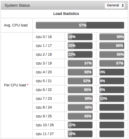

I'm trying to spread the load around and need some help understanding the numbering of my CPUs. I've got 2 Xeon X5650 processors. This is the view on the dashboard:
59b7a5dcc0869_ScreenShot2017-09-12at11_13_59.png.9cf3f61dbec4544cfe643cfe79136df0.png
Note that CPU 24-27 does not have any load, and has never seen any load. Meanwhile CPU 12-15 is "missing". This load you can see here is with Handbrake running an encode with the following parameters:

As we are not seeing load on CPU 20-23, and instead seeing it on 16-18 I'm suspecting the dashboard view to be skewed, and that it should have been 0-23 instead of skipping 12-15.

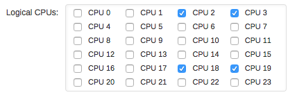

Also, when I'm adding a VM this is the numbers I can choose from:
59b7a5dc2f4a7_ScreenShot2017-09-12at11_14_19.png.63c6bb529ed28bf7f886071d2c356799.png
So my guess is that it's the dashboard view that is in fact "off". Any idea how I can fix this?
