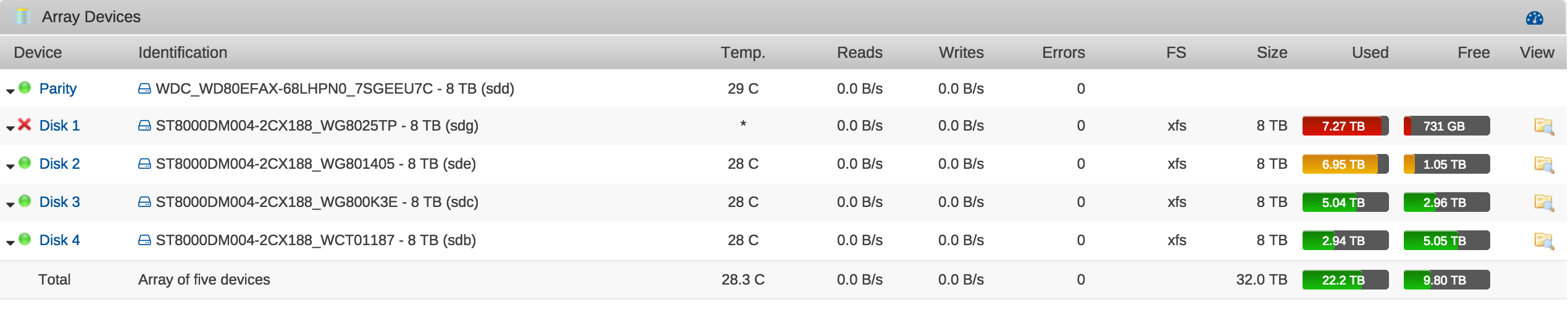

I shut unRAID down, swapped the "errored disk" into a different bay..then restarted the array...Now i'm able to see the Smart report for that drive and everything looks fine...So what is actually happening here?
I'll attach the new smart report for that drive as well. (AFTER REBOOT)
This is what i'm looking at, is there a way to get rid of this X without PreClearing that drive?
You don't need to preclear, just rebuild.
Disks look fine, so the multiple errors would point to other hardware problem, cables, controller, power supply, etc.

What are the exact steps to Rebuild the Array if using all the same drives...
Stop the array, unassign disk1, start array, stop array, re-assign disk, start one more time to begin the rebuild.
