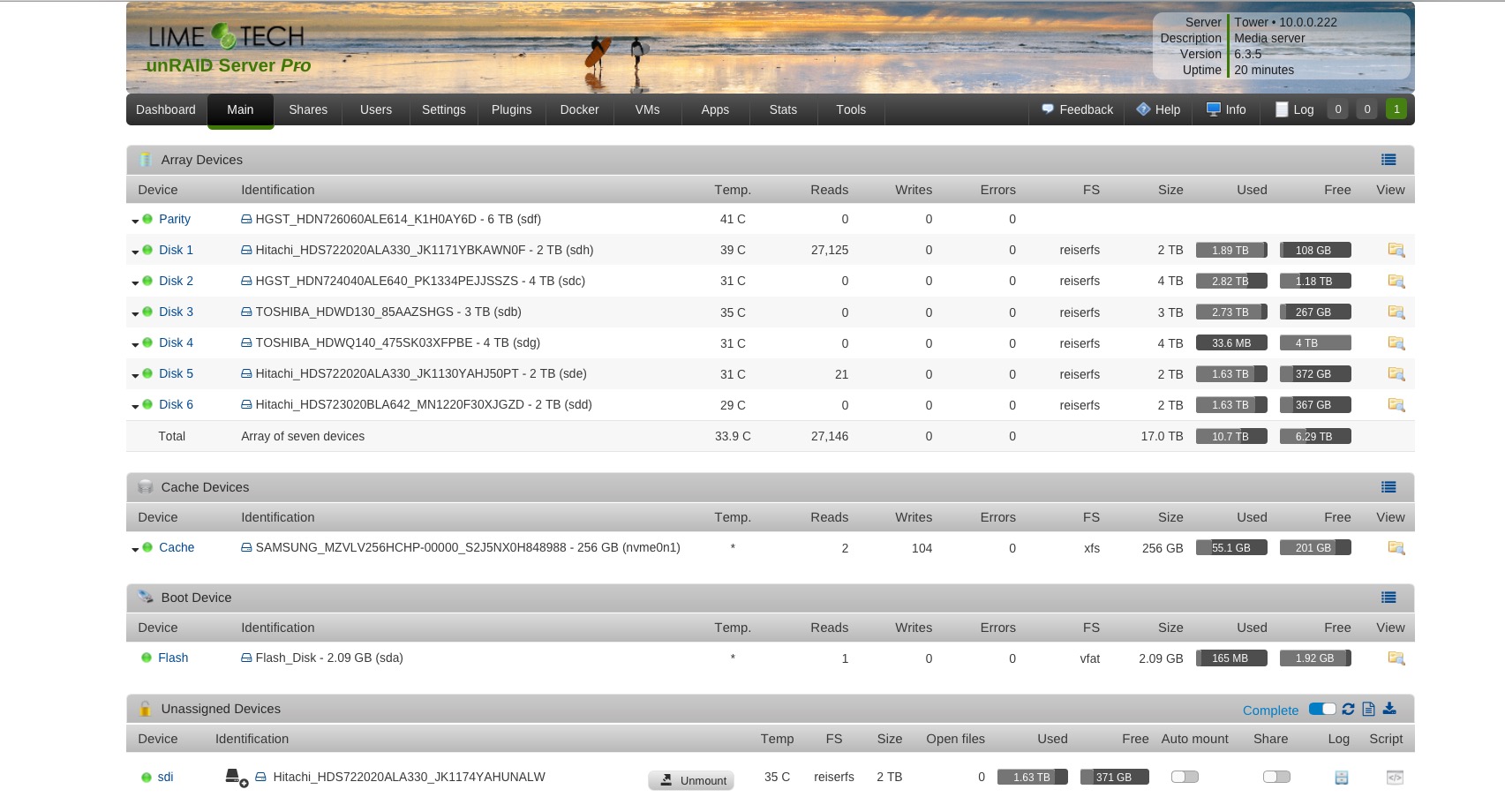

HELP.  I went through the parity swap procedure, introducing a 6tb drive as parity (to replace a 4tb parity drive) and to remove a failed 3tb drive.  This seemed to work fine, but after the procedure finished, ANOTHER drive failed (it was X'd out and i could not get it to be recognized).  So, I replaced THAT 2tb drive with a new 4tb drive.  The parity process completed and, after all of this, the new 4tb drive ( which replaced the 2tb drive) is apparently blank.  So, the old disk contents did not get copied over, apparently.  Fortunately, I can mount the old 2tb drive as an Unassigned Device (via the Main unRAID page I can drill down through the folders and apparently see files). So.... how do i copy over or merge the files on the old drive that never got built into parity?  Screenshot attached (Disk 4 is the new 4tb drive without any data on it).  THANK YOU.

Here, btw, is what the screen looked like when the Parity-Sync/Data-Rebuild process was 99.9% done:  note that Disk 4 is crossed out and there are 486M Errors.  This would explain why the disk 4 data never made it over to parity, I imagine. I suppose there is no way to reinsert the old drive back into the array, do a parity sync, remove it (i suppose it was crossed off for a reason, though there are no SMART errors) and re-sync?

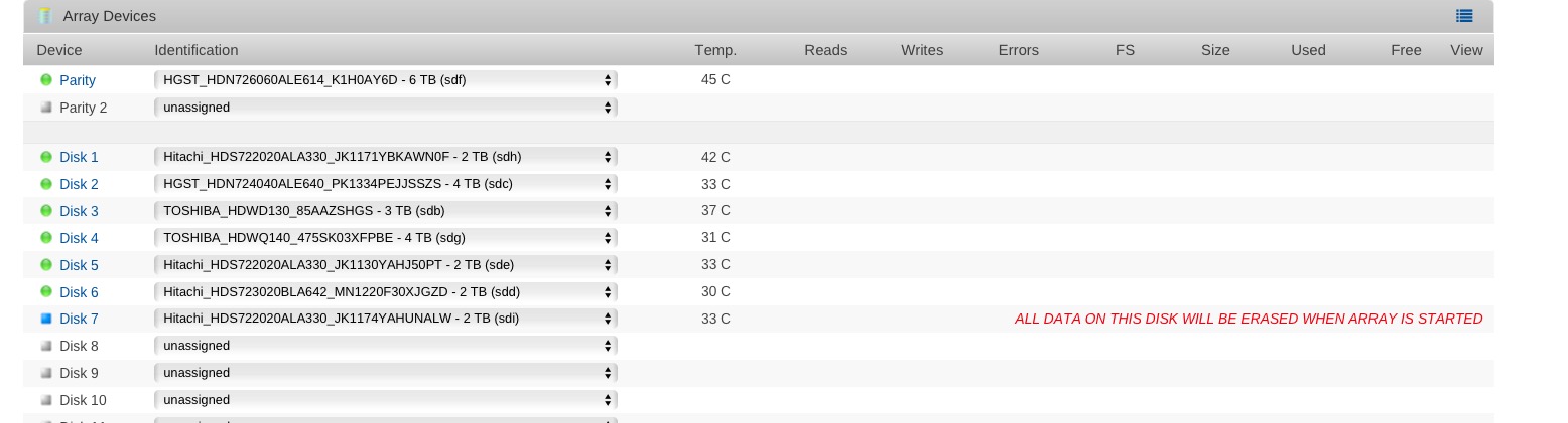

What is the best way to copy the data from the old disk to the new?  If I go to add the old disk to the array I get the WARNING all data will be erased message.
59d68a283dde9_ScreenShot2017-10-05at2_37_56PM.thumb.jpg.33b19fc4fd0f9f523b051f77c79d37ec.jpg
You can't add it to the array like that, on the screenshot before you had the old disk mounted using the UD plugin, that's the best way to copy the data, mount it again and copy the data, e.g. using midnight commander, from /mnt/disks/old_disk_mount_point to /mnt/disk4

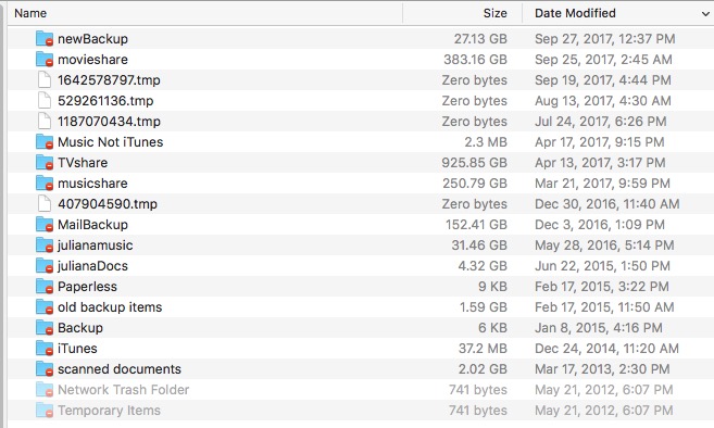

when i mount the tvshare via disk4 on my mac (when I mount it directly, i.e., smb://10.x.x.x/tvshare, I see no contents at all) I see folders with red warning icons (screenshot attached). l. This means, almost always, that I don't have permissions to view their contents (and that is, in fact, the dialog that is generated when I try to open them).  On the command line, however,  I am able to access a sharepoint and see its contents.  So it would be appear that, perhaps, the issue is only one of repairing permissions?  That's the optimistic view, at least.
