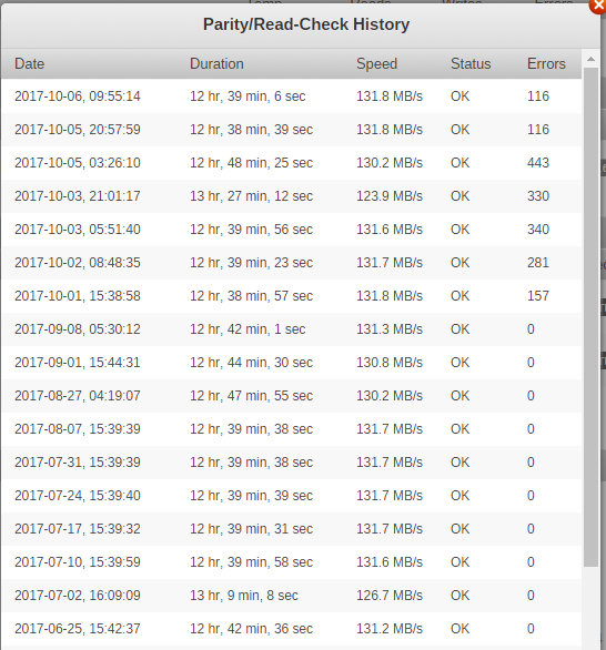

So I have this problem with constant parity errors that started up recently as seen in the screenshot.
The 'write corrections to parity' is always selected.
Between the 10/3 and 10/5 dates, i rebooted the server and ran extended smart check on all the drives, no issues reported.
How can I find out what's wrong?
I havent added/removed any files to the array since the start of this issue. In addition, none of my VM/dockers use write-storage on this array, so this array has been quiet save manual smart tests and parity checks. Prior to 10/1 I had the disks configured to spin down when unused, I took that off on 10/3 to see if there was any difference.

Start by posting up your diagnostics file.    'Tools'   >>>     'Diagnostics'
Nothing really jumps out, RAM is ECC, so maybe something wrong with the board or the onboard controller, do you have an HBA you could test with?

A scheduled parity check kicked off last night and reported 0 errors.
I'm going to go ahead and stick some ECC memory in it anyways and see where that takes me.
To put some closure on this thread.
As I was replacing the memory, I noticed one of the clips wasnt secure, it was probably loose and got jostled while moving it to the basement rack. Either way, I replaced the memory with ECC and the system seems a lot better, I used to get random segment faults in php in my logs, and that hasnt happened since, also havent seen any more parity errors.
