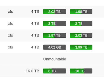

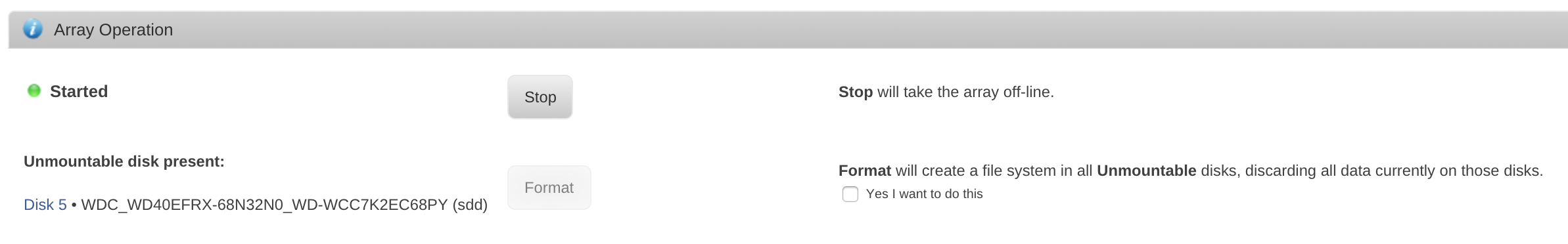

My unRAID server has been operational since August and I just purchase another drive to add to array.  After I ran the PreClear utility on the new drive and it passed all tests successfully, I tried adding it to the array, but it's showing as Unmountable.  See screenshots below.   I assume, I simply click on "Yes I want to do this" and then Format the drive, but I want to make sure I'm doing the right thing as this is the first time I added a new drive to an existing array.

If it is a new drive just precleared like you said then just click the "Yes I want to do this" to enable the format button and then press format to format the disk.  Preclear just clears the disk it doesn't add a file system to the disk.  The only thing you want to be careful of is if the unmountable drive really IS the drive you just precleared.  If it is a data drive that had data on it then you DON'T want to format it.

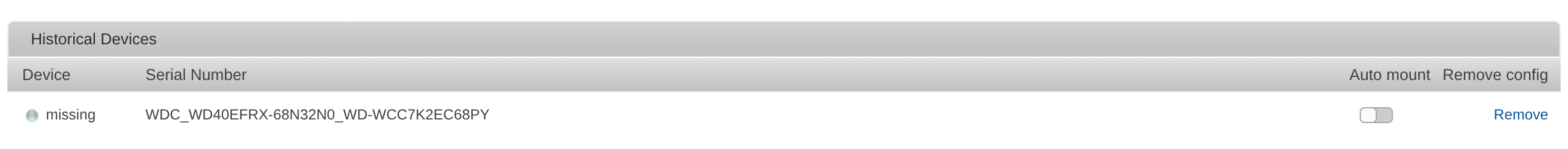

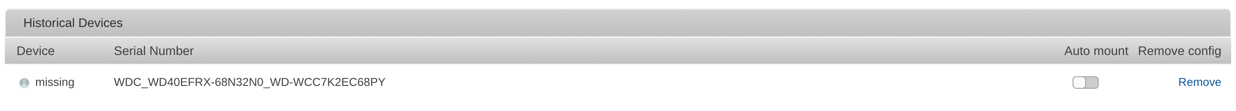

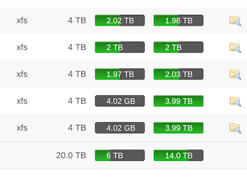

That's what I thought I needed to do and yes, that is the new drive I added.  It's formatted and showing properly as part of the array now; however, it's showing under the Unassigned Devices section, Historical Devices as missing... should I remove the config or is there something else I need to do?

Yes you can remove it from UD, it just shows you an history of what drives it knew about.
