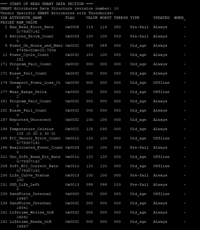

I have an old OCZ Agility 3 SSD running as my download drive through unassigned devices plugin.   The drive does not have a temperature sensor on it and always reports 128.   This is triggering temperature warnings constantly from the server.   Is there any way to disable these warnings?   I would prefer to just disable them for this drive but if needed all temperature warnings could be disabled.
Can you show me the output of this command?
/usr/sbin/smartctl -A /dev/sdX
Where X is the device designator.
As you can see it always says the temp is 128.   I can assure you its not :)  I have no problem ignoring this however the alerts that get generated become irritating after awhile lol.
