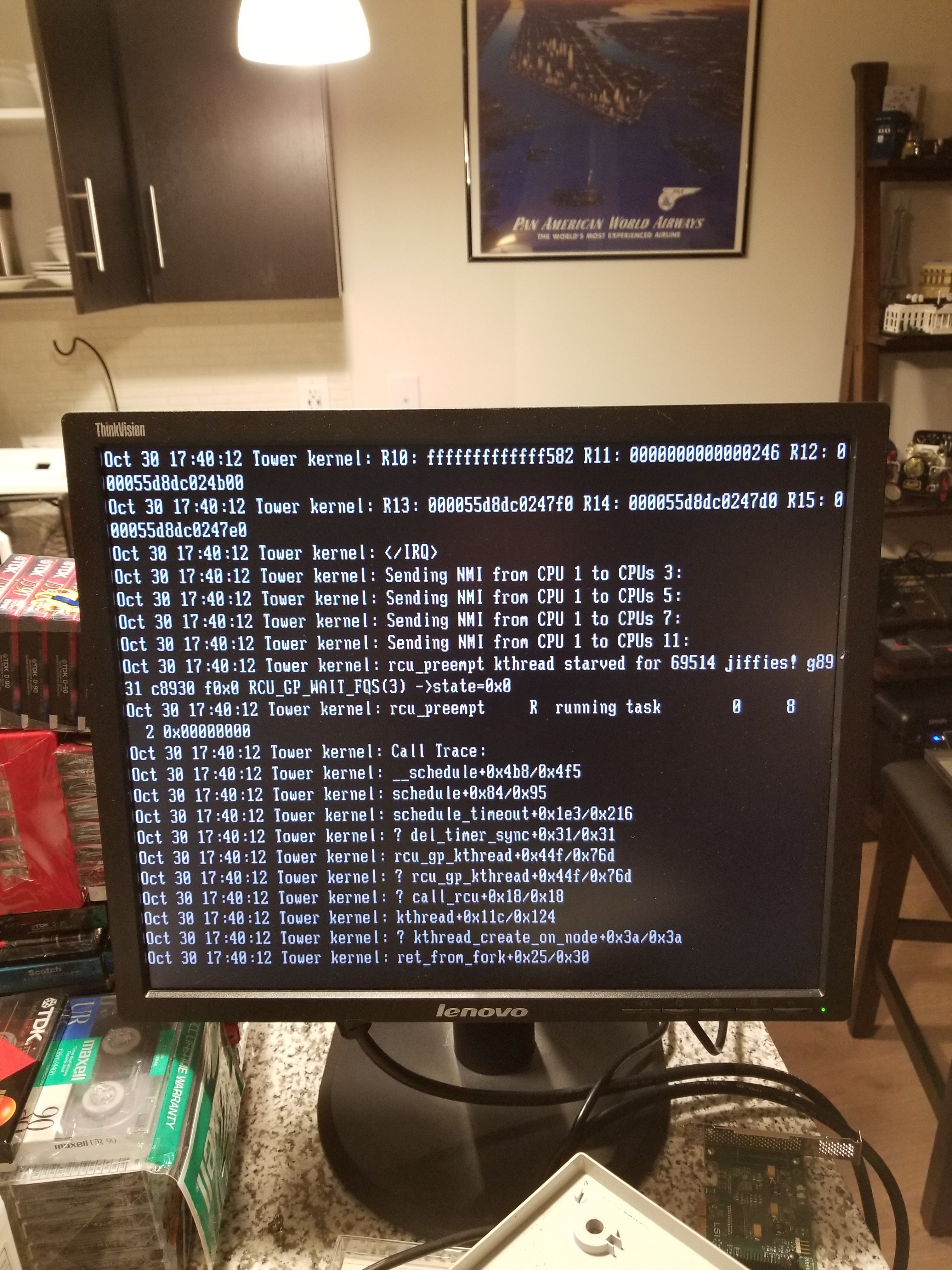

I just started with unRAID and for some reason my system won't stay up for more than an hour. This is what posts to the screen:

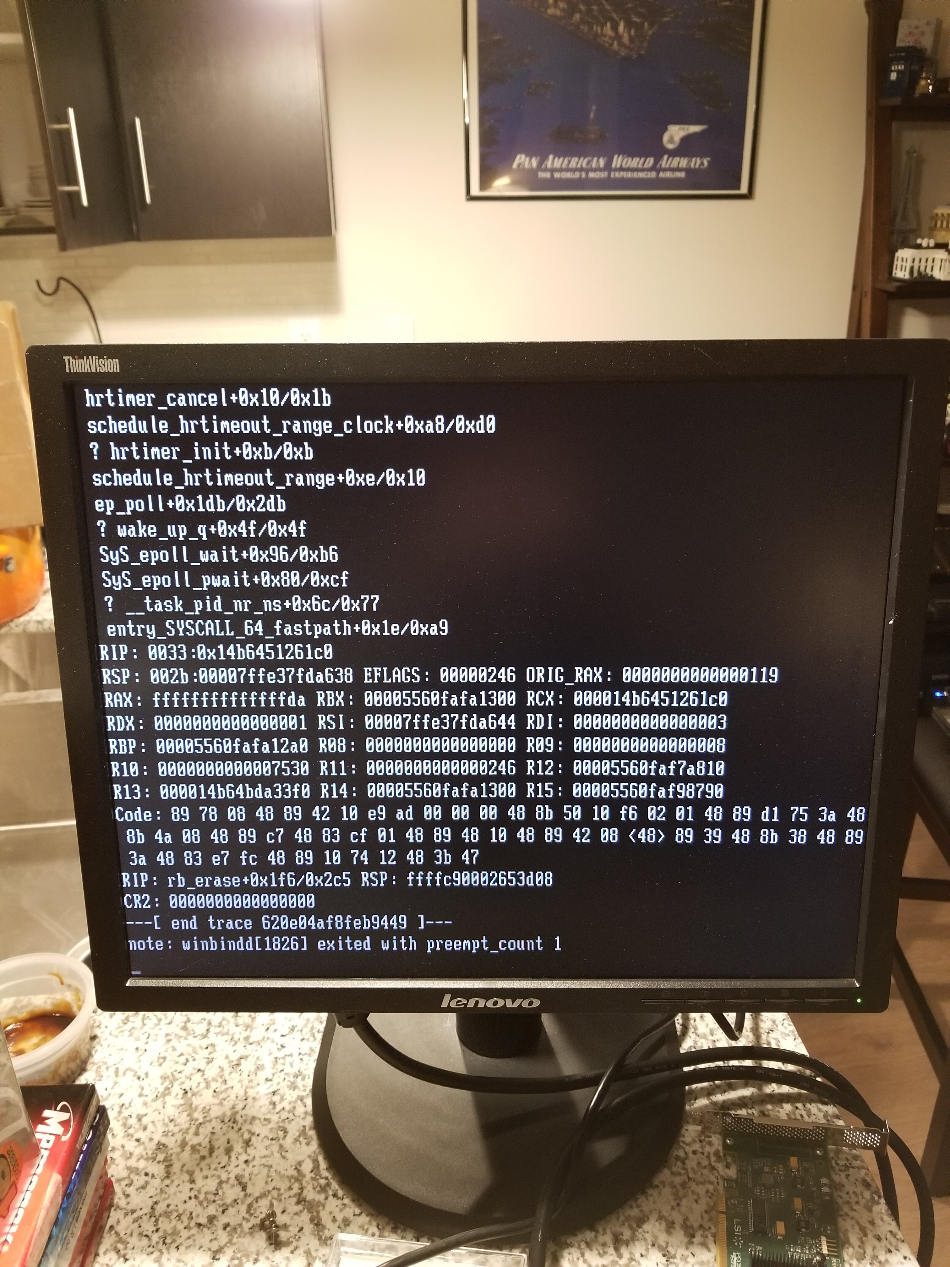

And this is what posts in safe mode:
This is on a Ryzen 1600X with nothing attached but the ram and an AMD RX 550 graphics card.

We are following very closely a linux kernel bug report re: Ryzen Freezes:
https://bugzilla.kernel.org/show_bug.cgi?id=196683
I didn't notice this until today but the kernel config RCU_NOCB_CPU_ALL was removed in kernel 4.13.  It was one of the important options I found to prevent Ryzen cpus from locking up.
I'm looking at patching support back in to the kernel but in the meantime, if you have Ryzen, you can add this to your Syslinux configuration's 'append' lines,
For 16-threads Ryzen (1800X, 1700X, 1700):
rcu_nocbs=0-15
For 12-threads Ryzen (1600X, 1600):
rcu_nocbs=0-11
For 8-threads Ryzen (1500X, 1500, 1400):
rcu_nocbs=0-7
For 4-threads Ryzen (1300X, 1200):
rcu_nocbs=0-3
Edited by limetech
Add link to kernel bug report

Thanks. Just put together my new Ryzen storage rig and just managed to request a trial before the cursor stopped blinking and the system froze. Will try this fix.
EDIT: This solved it. Thanks a lot!
