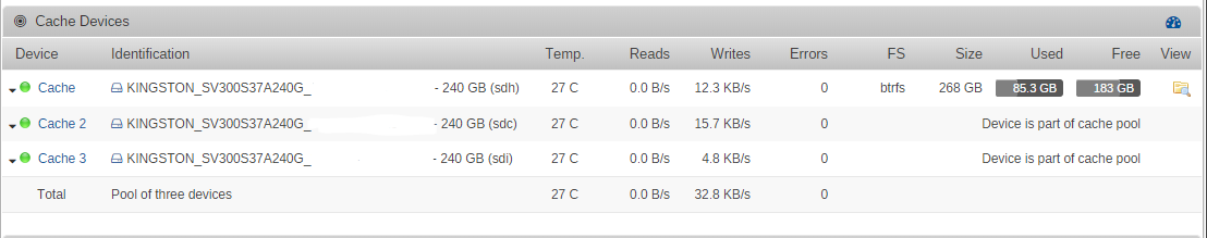

Sorry if this has been asked/answered before but I just setup an unRaid box. I have three SSDs (240GB) setup for cache. I figured I would get (360GB) usable space but its reporting that I only have 268GB. I've attached a photo for reference. When I click on Cache its showing that the btrfs filesystem df is:
Data, RAID1: total=81.00GiB, used=80.48GiB
System, RAID1: total=32.00MiB, used=16.00KiB
Metadata, RAID1: total=1.00GiB, used=12.03MiB
GlobalReserve, single: total=16.00MiB, used=0.00B

Probably the GUI is reporting incorrect capacity, can you post the output of:
df -h /mnt/cache
Sorry for the delay. Here's the results...
Filesystem      Size  Used Avail Use% Mounted on
/dev/sdh1       336G   86G  172G  34% /mnt/cache
Also, since last night in the GUI the total size increased to 277GB
Total size is correctly reported by df, but available is not, I did some quick testing with raid1 only and the issue seems limited to pools with an odd number of devices, you can still use all the space, but both total and free space are incorrectly reported on the GUI, the reported free and used spaces will get closer to real as the pool gets filled.
One possible issue is if you do a transfer from e.g. Windows where the total transfer size is below the actual free space but above the reported free space will get an out of space error.
Correct free space is reported by btrfs usage, if you run this you'll get it:
btrfs fi usage /mnt/cache
Don't know if it's possible for LT to display the GUI stats from that in the future.
