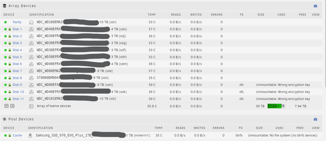

  2. I attempted to update to 6.10.0-rc2 but 4 out of my 13 drives are displaying "Unmountable: Wrong encryption key". This also includes my Cache drive. I've since reverted back to rc1 and now Disks 9 and Disks 10 are showing the Wrong Encryption Key and Disk 11 and the Cache are okay. Update: I've rebooted again, and I'm now able to mount everything correctly on RC1. Still don't know why its doing this. Thanks.

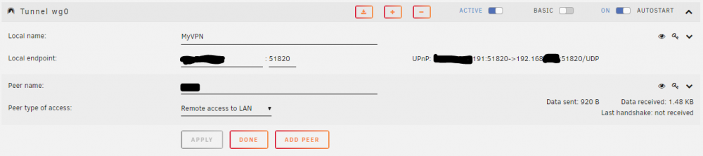

  5. I thought it was a port forward issue as well. So I tried configuring wireguard to use UDP port 1194 (The port my openvpn uses) and I get the same results. Connect but no handshake. Edit: I think I'm going to setup my Dev Sever and test, just to verify its not a config issue on my Prod server.
  6. Hi Can0nfan, The endpoint is set to my subdomain.domain.tld . I don't have a static public IP, so I use ddclient to update my domain to my current IP when it changes. And I have tried setting it to my current IP to rule out any issue there. My phone talks to the server but won't complete the handshake as you can see there is data being sent and received on the server. I also tried my work android phone as well and its doing the same thing. It's like the server is actively blocking the connection when its seeing it from the external source as it will connect just fine if my phone is on the same network. This is the first service that I've had an issue getting it to connect externally. My openvpn-as docker is still working just fine at the moment. I'm going to update to rc6 and see if that helps any. Also a side note: With the VPN enabled on my phone I can still access the internet even though my VPN connection turned on. On my OpenVPN if I lose my VPN connection I lose connection to everything until my VPN reconnects (As a VPN should be). I'm not sure why wireguard is letting data flow though my cell connection and not trying to go though the VPN (even with the handshake not being established). Edit: RC6 didn't resolve the issue.

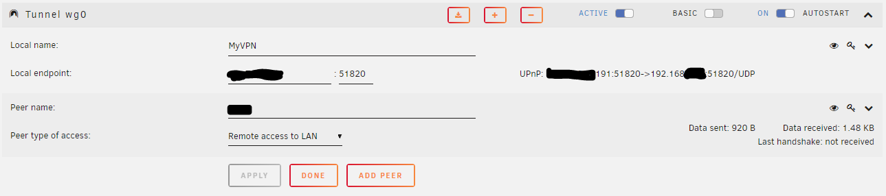

  7. Just tried it, no luck. I changed it both on unRAID and my iPhone Client. The odd thing is, I can get it working on a Win 10 Client on my network. I've been testing with my iPhone with wifi turned off. Would my Cell service be blocking something? (I'm on Bell in Canada) Update: I can get it working on my iPhone while connecting to the same network as my server (Internally). Looking like my network is to blame. I'm using Google WiFi if anyone is curious.
  8. I tried setting this up. I've been using openvpn-as docker with no issues but with wireguard I cannot get the handshake to initialize. On my iPhone the log indicates: ... 2019-11-08 14:53:52.110832: [NET] peer(q4nv…iXkg) - Handshake did not complete after 5 seconds, retrying (try 19) 2019-11-08 14:53:52.111139: [NET] peer(q4nv…iXkg) - Sending handshake initiation 2019-11-08 14:53:57.174070: [NET] peer(q4nv…iXkg) - Handshake did not complete after 5 seconds, retrying (try 20) 2019-11-08 14:53:57.174466: [NET] peer(q4nv…iXkg) - Sending handshake initiation 2019-11-08 14:54:02.217420: [NET] peer(q4nv…iXkg) - Handshake did not complete after 20 attempts, giving up At first I thought it was a port forward issues, I tried enabling UPnP and letting wireguard do its thing but that didn't help. It appears that my client is hitting the service as the data sent/received goes up but no handshake. Any ideas what would be causing this? Are there any logs available within unRAID I can look at? Thanks.
