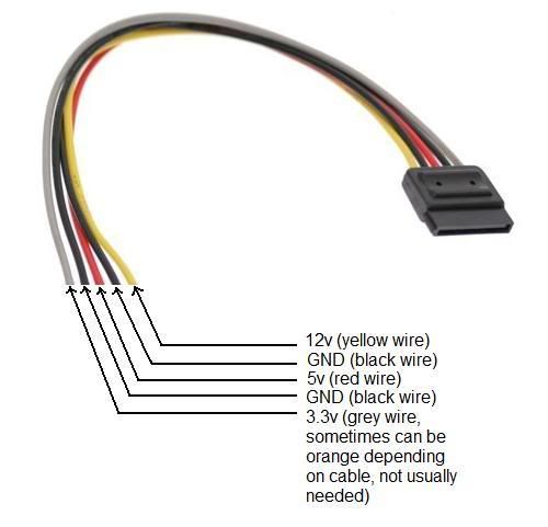

Try powering it off of a molex cable attached to a molex->sata power.  Reports of that drive doing the same thing if it has the 3.3v present
Connecting it to SATA / Power works fine. I just don't have much in the way of means to connect the other drives up without the SAS backplane.
I see what you are saying tho, in /r/DataHoarder/comments/70hm8h/8tb_easystore_wd_white_label_issuesolution/
user lakijfosda seems to have fixed this issue by simply chomping off the 3.3v wire.
Zack from Zackreed.me seems to have a more practical solution in taping off the 3.3v pins with kapton tape (https://zackreed.me/hgst-7k6000-not-spinning-not-working/
I'll head up to the hardware store and give this solution a try.
Thanks for nudge, seems like a winning solution so far.
Success! Taped over the 3rd pin in and it detects now.  Tnx again for the assist.
Thanks!  Helped me get mine recognized.  What I did, was lift the wire out of the sata power connector closest to the notch  as shown as the 3.3v gray wire in the picture.
