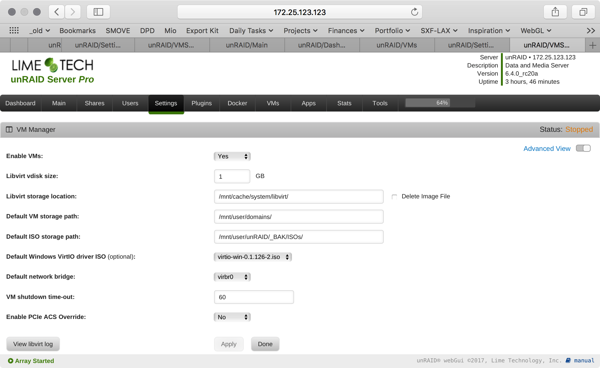

ugh...I don't get it...I must be doing things in the wrong order, or rather, I forgot to stop the array before messing with the VM settings...I disabled the VM Manager, deleted the big 100GB libvert from there, then created a new one with 1GB, and then re-enabled VMs...when I checked my VMs I saw that the icon for my Windows 10 VM has disappeared (it is still in the domains folder, of course)...but that's just what happened last time, and adding it back in caused me a few hours of work, probably bc I hadn't copied and pasted the XML then.
I stopped and started the array to activate the new VM settings, but when I go to the VM tab, it is blank...the VM Manager shows as "Stopped" again...déjà vue...why do I keep making the same mistakes?
I'd like to add back the VM now, but with a blank VM tab and the VM Manager not starting, where do I go from here?

it appeared after I stopped and then started the array again...while it is stopped I can't see whether it's there already or not without ssh'ing into my server, which I didn't...anywhere, it's there now and the VM Manager is running.
how do you change the default network bridge? (yes, I did wonder about that before...good memory, jb!) there is only that one available in the dropdown...do I need to stop the VM Manager first and then how do I add another bridge and what does it need to be called?
I stopped the VM Manager and there is still only that one bridge in the drop-down with no apparent way to add another one.
Stop array, settings, network settings, enable bridging:yes
yep, sure enough, there it is.

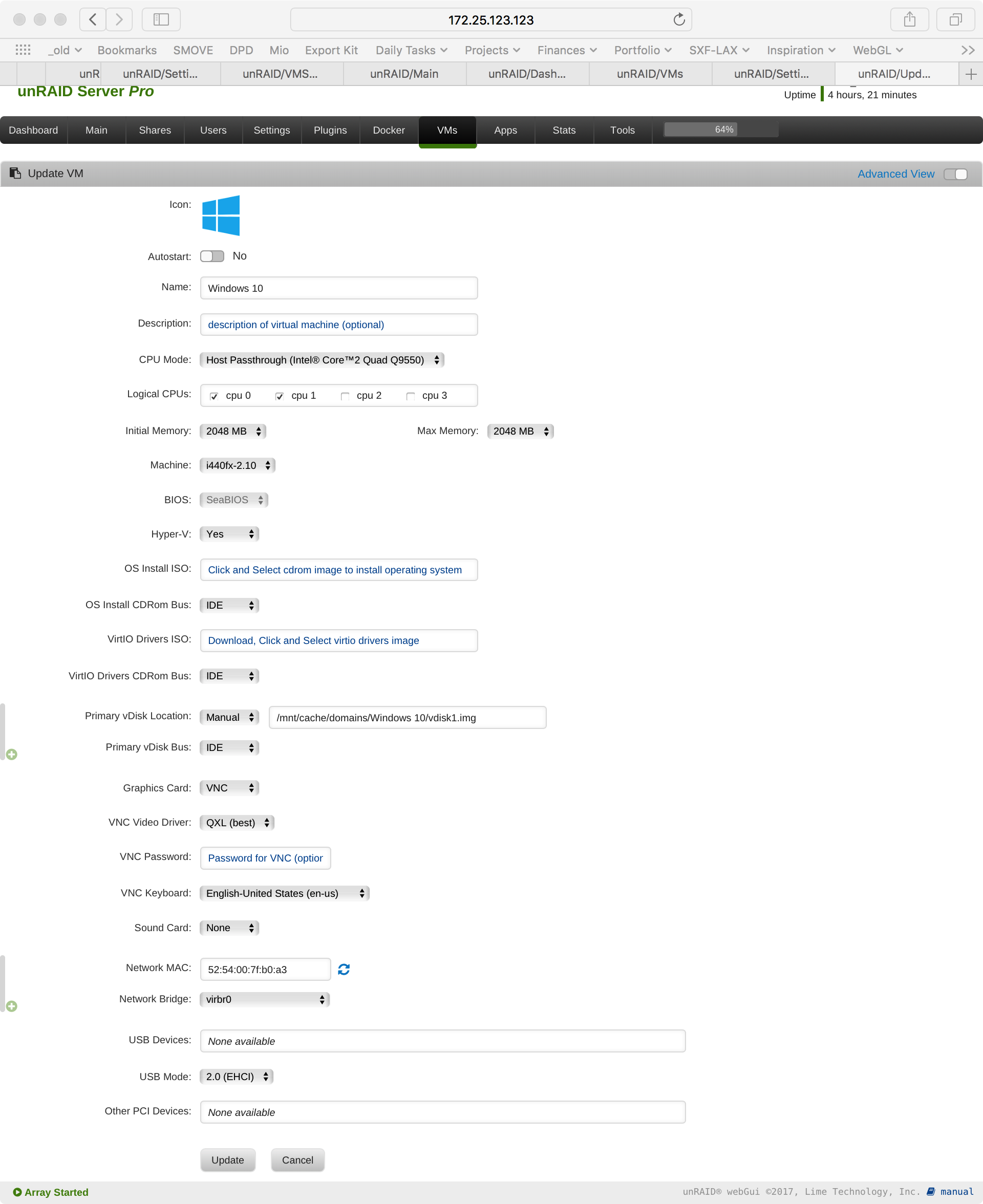

so I did what I think I had to do, recreating the VM, and I am at the same point where I was 3 days ago, when my Windows 7 VM's would show as started in the unRAID VM's tab, but when I try to go to it with my VNC viewer (I now use Screens), it won't authenticate.
let me force stop it and look over all the settings again...I just hope I can get it going again without having to start from scratch.
if only I knew what causes this disconnect after having to recreate the VMs (or rather the links to them) in the unRAID UI...just like with the Windows 7 VMs a few days ago.

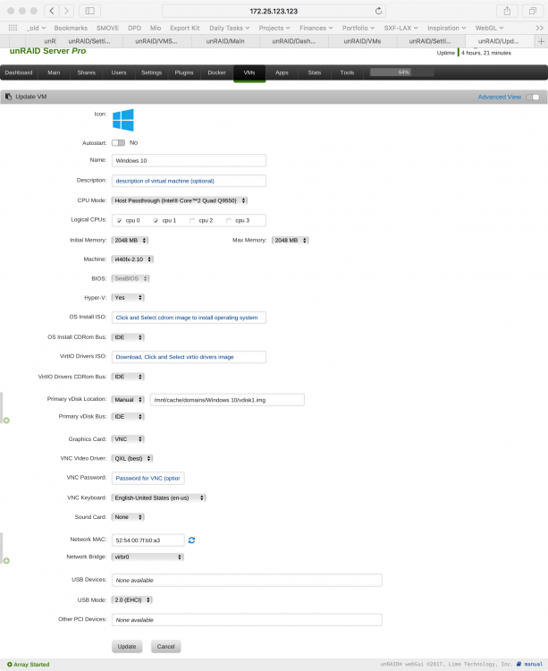

for all it's worth, here is my template. (and I do change the bridge every time before I update this template, but somehow it keeps changing back...probably from the XML I pasted in again):

Try changing the vnc video driver to cirrus and see what happens.
BTW, which tutorial did you follow to create this? I don't think I've seen anyone recommend using IDE for the primary vdisk, I would think that would be slow. The normal method is to use virtio and install the drivers from the virtio CD during install.
Yes, all the GUI settings are in the XML, if you want to make a change in the GUI, you need to make a new copy of the XML. Even better (NOT) the current unraid implementation will overwrite any manual changes to the XML if you update anything in the GUI, so saving your XML's when you get it working is a good idea.
there was another instruction video from a guy that suggested a bunch of XML changes and a second vdisk...the first instruction video was the one that I think you are referring to and pretty much everybody uses.
cirrus didn't change anything.
having used IDE would explain the excruciatingly slow startup time, last time I got this to run, earlier today, but at this point I lost track of what I did when and exactly why...my brain is a bit fried from all of this (as is yours, I am sure)...I just wanna avoid starting a new VM install and being up until the wee hours of the morning trying to get back to the point I was at earlier today...but I know I will if I can't get this VM to start up and be reachable via VNC again...it's gotta be something small, as this thing was running great before my twiddling around dropped it from my VM's screen...it's always when re-creating the link to it that this happens, so it must have something to do with those template settings.

I changed/tried so many settings that I'm not entirely sure, but I got the VM to start and be accessible again after changing the bridge back to virbr0...not 100% sure that that is all it was...one thing I noticed is that every time I boot into this VM, it seems to set up the network interface anew...last time the Network changed to Network 2 and now it is Network 3, each time losing all the IP numbers I input the first time I set up Windows 10...something is screwy, and I don't know what, and I am too tired to look into further.
