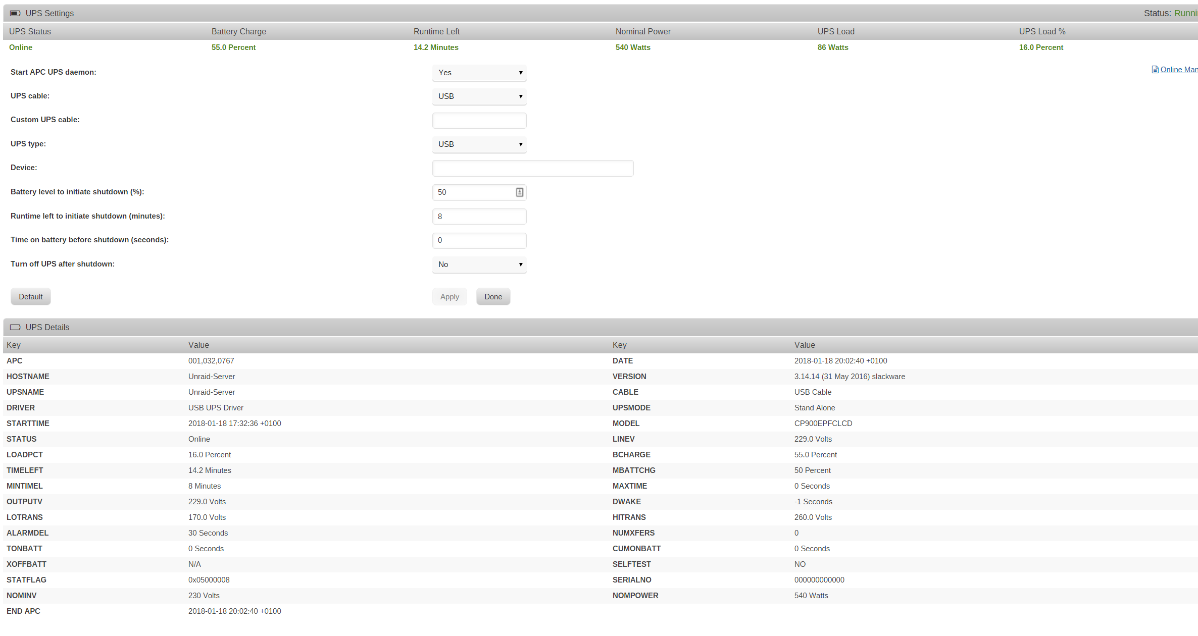

Did you go to settings, UPS settings and set your UPS up properly? There is a little more to it then just plugging it into your unRAID server, you have to setup notifications and test them.
I did test them ofc, and they worked just as i expected. (warning power off, power back blabla)

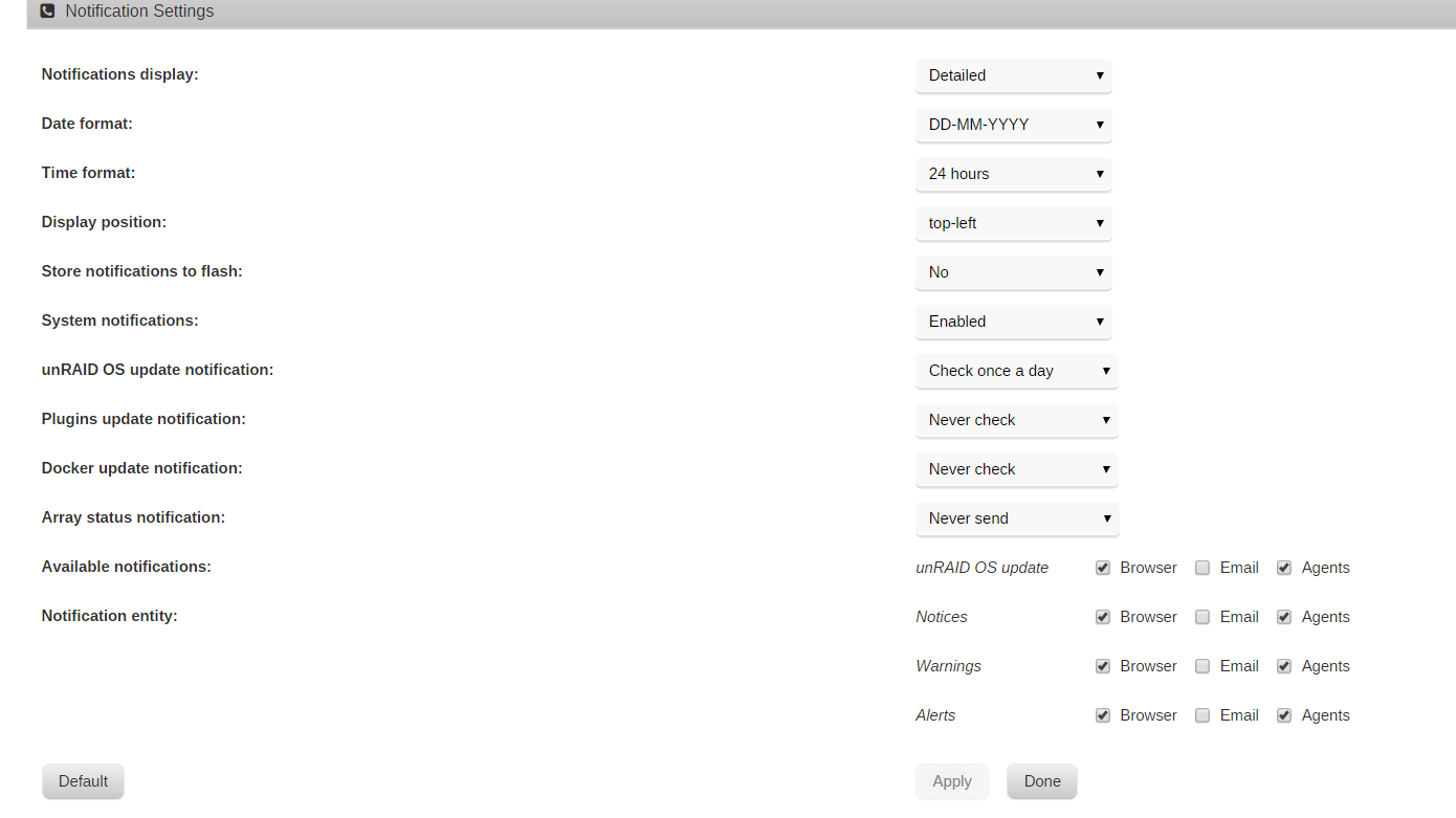

All UPS notifications are sent with severity level "alert". Do you have alert notifications set for your browser?

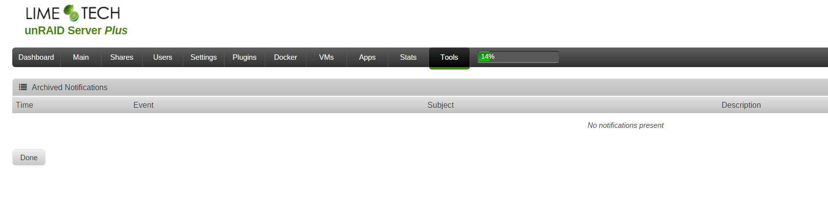

Is there any notification in the notifications history?
Ps. Notification history is only preserved when copied to flash (by default off)

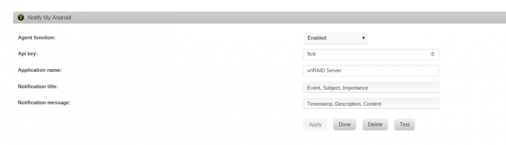

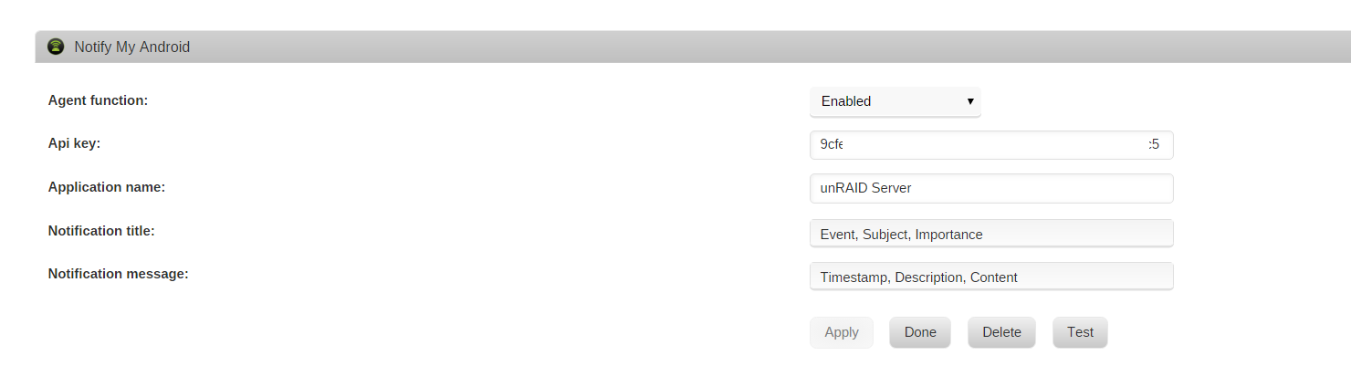

I guess, since the questions come every time, i just upload pictures, pics works better then words... :P
I just did a NmA test and it worked.
