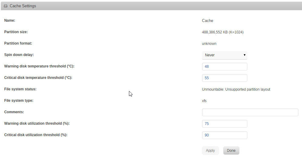

I have my appdata, docker.img, and some settings on my cache drive. After the first boot of 6.4.0 I see this in my log. I never had a problem with my cache drive. I see the cache drive settings as well, so I'm at a stumper. Why would my cache drive not mount on 6.4.0 but work fine on 6.3.5?
  • If your cache disk has an "incompatible partition" after upgrading, it was probably created in an older version of the Unassigned Devices plugin. UD has been updated so this won't happen again.
    This is a one-time fix. You'll need to downgrade to 6.3.5 and move the data off the cache drive, re-format the disk and move the data back.  The procedure is outlined here
I did make a backup of my cache drive, so able to just reformat it, then copy the old contents back on.
