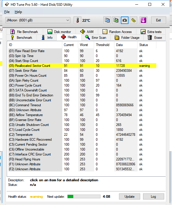

This is the smart report from disk 2.
That's not a good sign but not enough of a reason for the disk not being detected by unRAID, still, and if it's under warranty you might want to get it replaced.
I put the disc back into unraid and it showed up. However unraid it warning of the reallocated sector count. All other hdds are zero but disk2 is 11728.

It was likely disabled because of this, it just doesn't explain why it wasn't detected after that.

If a disk read fails, unRAID may read its data from the parity calculation instead, and then try to write it back to the disk. When that write fails, the disk is disabled.
It is usually possible to get the SMART from unRAID instead of putting the disk into another system. Note that it is almost always a bad idea to put an unRAID disk into another system and try to work on it there, since you will invalidate parity.
Yes, in the syslog there were some reads and at the end there were some writes before the disk was disabled. Anyway, I have sent the disk back to Seagate. Hopefully it will be a quick turnaround.
