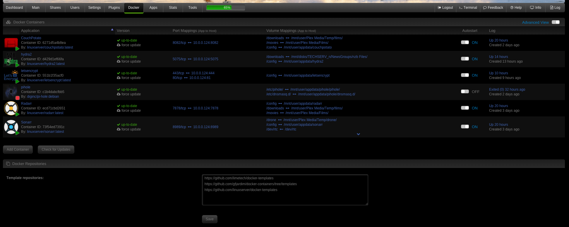

This is what I'm seeing...?
By reinstalling you probably got rid of the orphans already as a side effect
Great. I'll keep an eye on things.
Thanks for your help!
