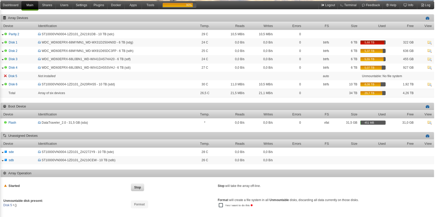

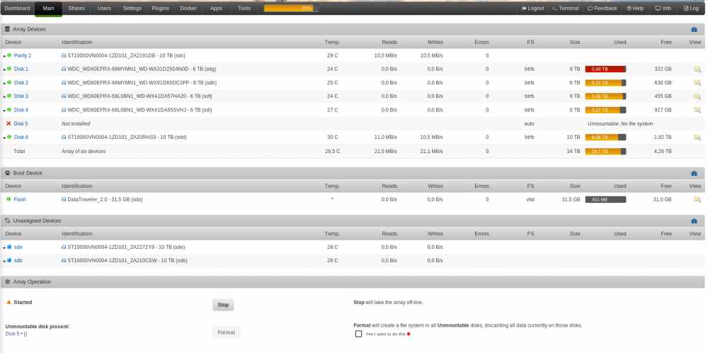

Also post a screenshot of current main page just to check everything else looks normal.
Just now, JimBob said:
My array is running in btrfs, is there an equivalent command for that?
Yes, but not as easy, post your diagnostics instead then.
Doesn't look good, most likely parity2 wasn't valid, or at least not 100% valid, run this after starting in maintenance mode, this is read only just to see if a valid filesystem is detected:

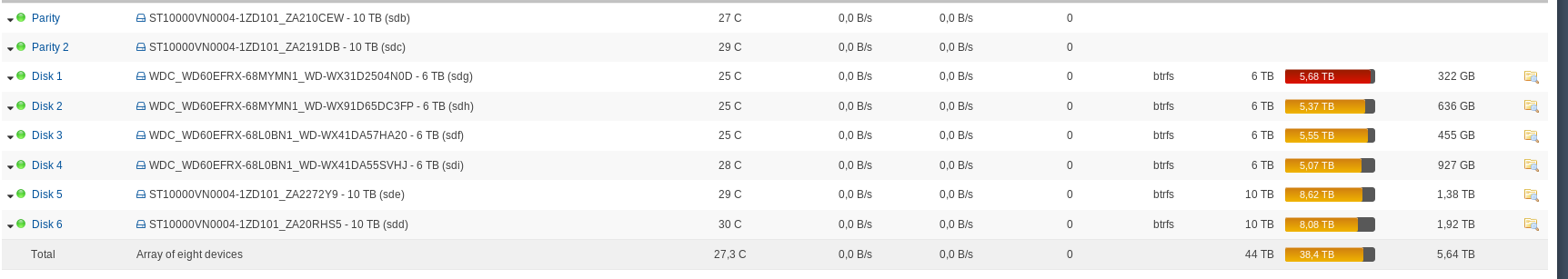

So everything seems to be back data wise, to get the once disk5 (previously corrupted one I've moved data off) as my 2n'd parity, would I do it via new config? Also would I set mark parity as valid when doing this or let it rebuild parity?
Thanks,
J
Depends, is old disk5 still part of the array? Was btrfs restore done to the array or to a new disk outside the array? Maybe post a screenshot of current array config also.
